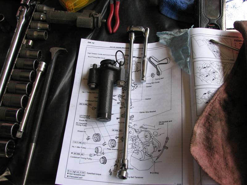

You are correct sir, I took off the idler pulley on the bottom and it gave me all the room I needed. I'm on day 2 of install. Got timing belt installed and that bolt torqued. Just gotta put all the covers back on and install the belt.
And for those curious, if you're changing the belt tensioner you don't need to remove the ac compressor or the bracket, plenty of space to get to that bolt from the bottom. Just need a few extensions... a few i mean like 5-6 :)
Or a long one with a wobble on the end :juggle:

I'm gonna be doing my timing belt and tensioner soon on my 1999 4Runner Limited. I'm glad I saw this thread, I thought the A/C compressor needed to be unbolted.
I like the fact you can use a series of extensions and swivels.
My only question, what size socket do you use to remove and re-install the tensioner bolts?

I used 1/4" drive and a 1/2" socket. Since these are metric bolts officially it's 13mm.
