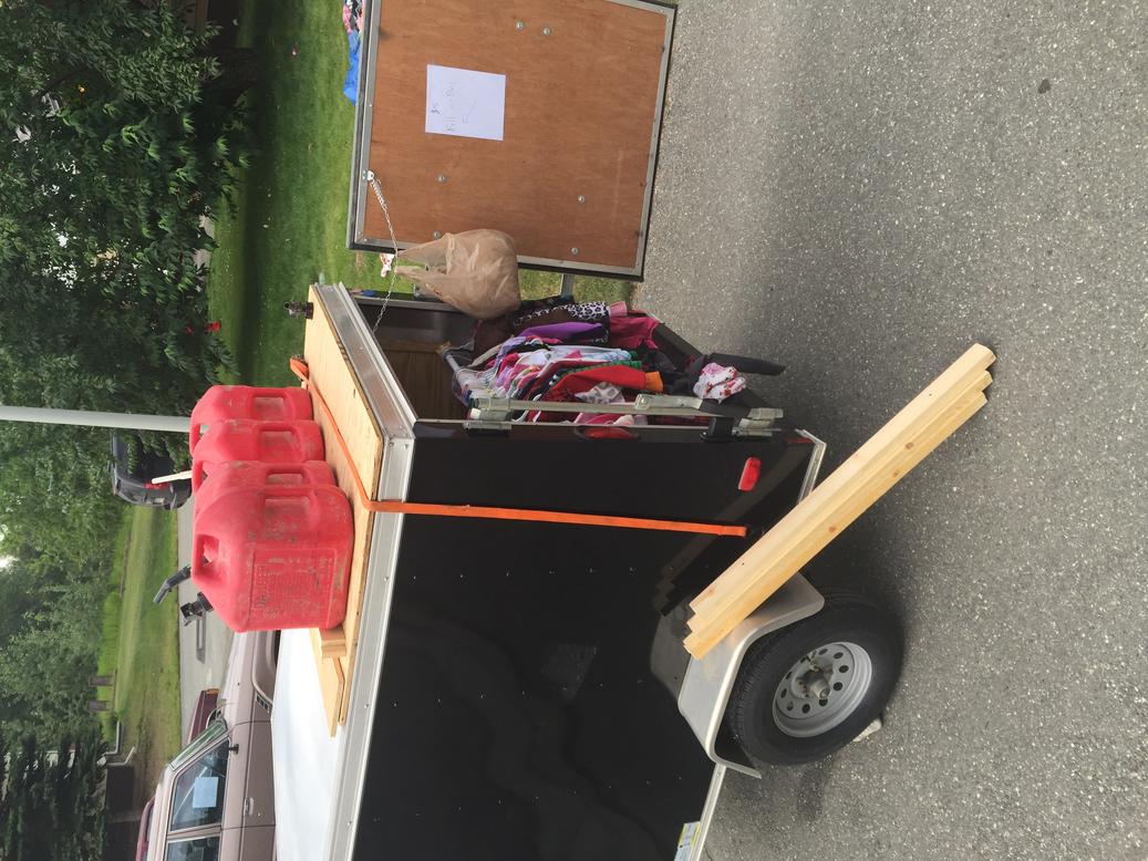

Had everything I needed
A perfectly cut piece of 3/4" plywood, sections of pine to make a box around the cans. And straps.
I plan on using 6 gopro adhesive pads attached to metal plates on the wood to hold it down to the trailer (you guys may be scratching your heads but those adhesives are strong as hell) additionally there will be comealong straps going over the front and back of the wood panel that are hooked to the bottom of the trailer AND a third strap going through the tops of the gas can handles. It may work.
I was going to Ubolt from underneath using the cross members on the roof but I don't want to increase the risk of leaking

Be sure to watch you're tongue weight...not enough can cause serious problems towing.
There should be a good amount of the heavy "unneeded during trip" stuff up front. I'm going to center the cans on the trailer as well (moved forward from what you see in the picture for that reason alone and to have 2 cross beam
Supports under it instead of just 1.

Well of course it sounds bad when you use logic instead of whatever I used! And in all reality I've had to purchase nothin except the gas cans ($40 off CL, one was full too). I have the 3 ratchet straps: front, back, and in the middle going through the gas can handles. And all of the wood was scrap heading for a junk pile somewhere. I guess I'd rather save a little bit of money and have fun building something. It's probably a terrible idea.

Negative. There will be a ratchet strap going through the handles hooked to the underside of the trailer on both ends.
