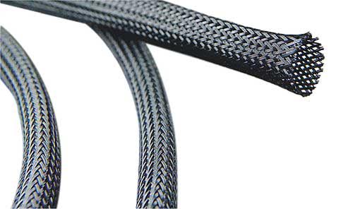

I just ordered some Braided Wire Sleeving from Tony @ CABLETIESANDMORE.COM
to make the job look OEM while waiting on the switch. Very good price!
Should make a nice tidy mod when complete.

Good idea! When the Air On Board switches come in, I might just redo the wiring with this too!
You will be surprised as to how inexpensive this is to do....
braided wire sleeve with a small piece of shrink tubing on each end makes a nice tidy sleeve.
