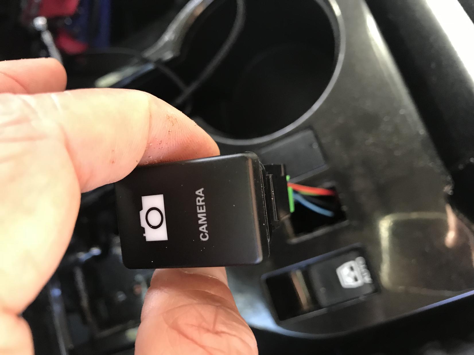

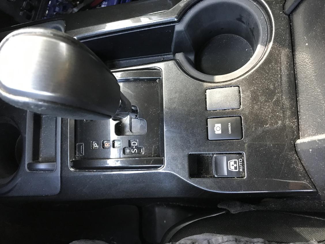

Installed mine
Got mine installed yesterday!
I often tow a trailer and wanted to be able to check my load.
Was easy instal, plugged right in. Followed instructions from website to remove dash pieces. I used the Air on Board switch.
