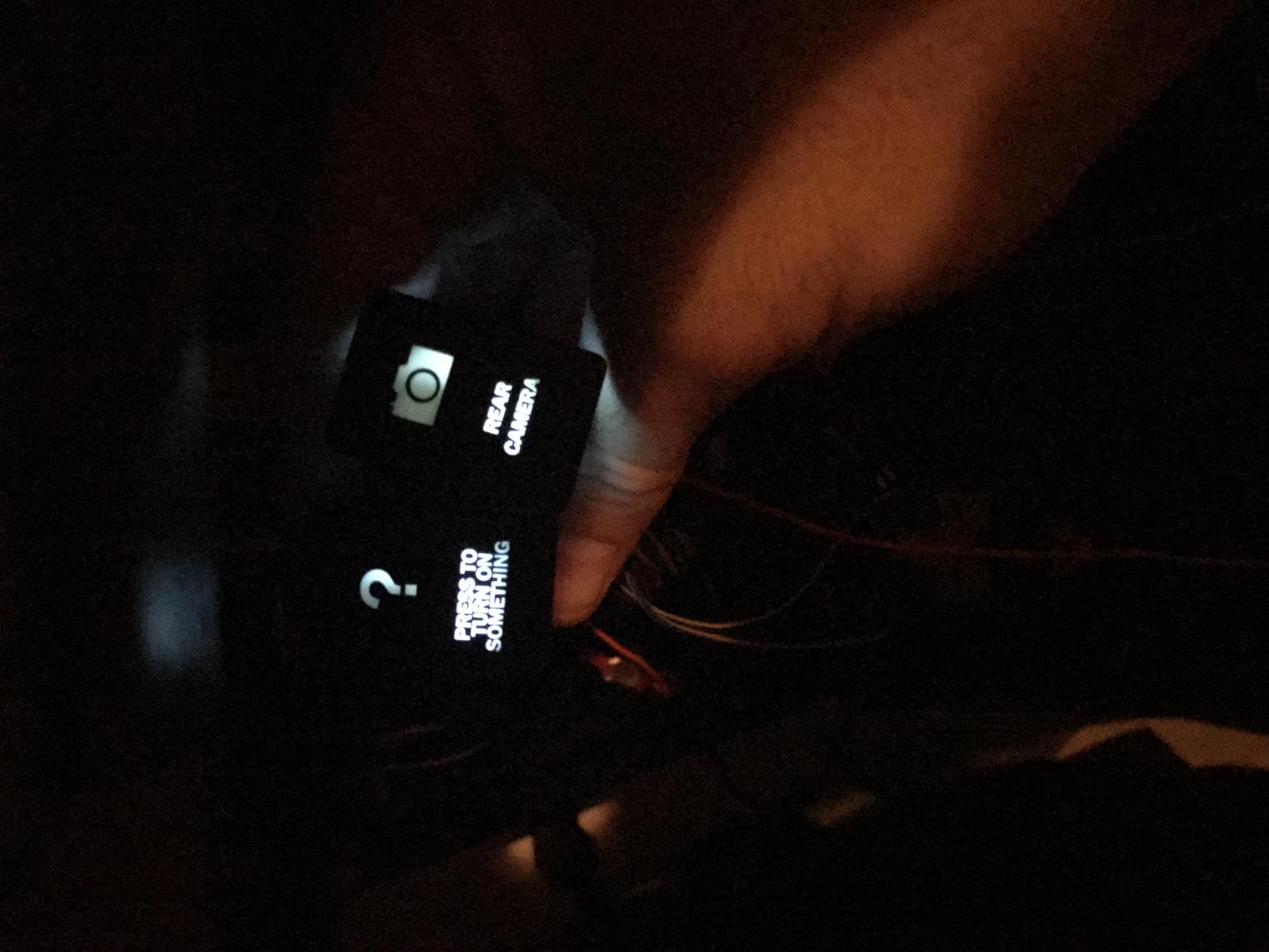

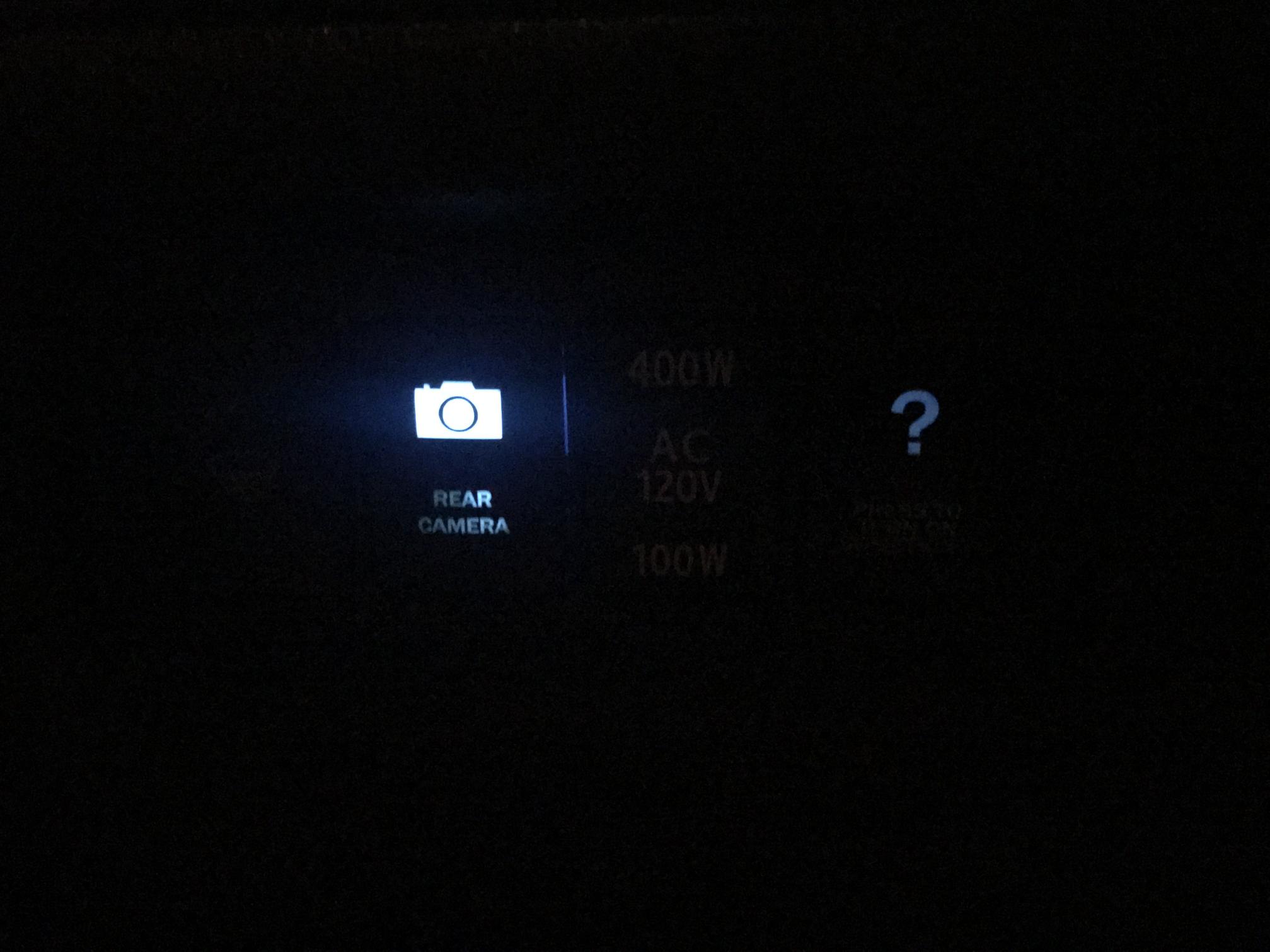

Got my aob switches finally so I installed my dongle. Super disappointed with the switches. The light on the switches are really uneven with portions of the switch dark and some dim. Also I wired both switches the same. Used the windshield wiper switch for both new switches (backup camera and nav override) I Put the blue aob wire to the green wire on the stock switch and he black aob wire to the grey wire on the stock switch. Now the camera switch always has a light on and gets brighter when pressed and the nav override switch is illuminated when off (and is dim compared to the camera switch) and light goes out when pressed. I tried switching the dongle wires on the nav override switch but when I do that the light never comes on. Don't know what the deal is here. Oh well it's done and at least they work.

[MENTION=129513]bjohnston115[/MENTION]. I tried messaging but got no response.
