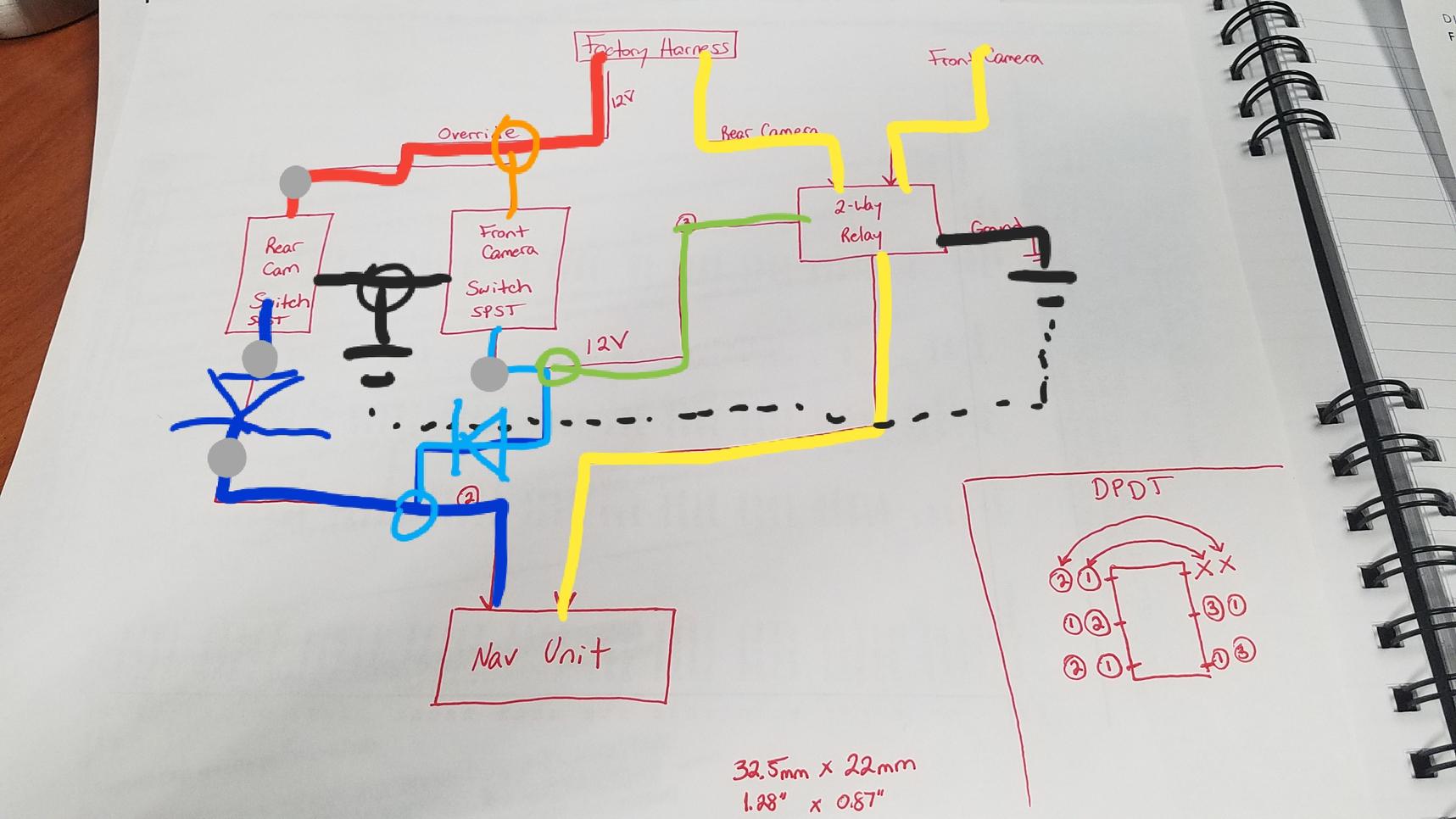

OK, so I have front and rear cam, aux video input cable, rear camera override harness and 2 single throw switches. Which two wires get run to the two switches? I have the black dual wire loom running down there but I thought one of those wires was for 12V?
UPDATE: front cam is working when I flip the switch but front cam also comes on in reverse and I can't figure out what to run to reverse switch in dash. Thanks!
Is there any way to make this work with two spst switches where you have one switch for front cam and one switch for rear cam? Thanks!
Yes you can. One switch will activate the anytime camera in default mode which is rear. The other switch will change the input from rear to front.
The one in the loom should be for rear anytime. That’s easy. It has a 12v supply and the other is the input for the screen. For the other one it’s a 12v trigger that activates the relay so it switches from default rear to front. Take the 12v load from the loom and run it to both input of the switch. One output is for the anytime rear and the other output will be for the relay. Make sure to ground the other switched end of the relay. I really wish he did different color wires but I’ve done enough wiring where I can figure it out.

Don’t think of it as turning on rear first. The first switch enables the camera to come on anytime. You could leave the front one on and when you flick it will come on vs the rear.
One is a source selector and the other is on off. But it seems like you got it working. With a dpdt it just does both at the same time. Hit the rear and it piers the on off. Hit the forward and it powers on off and front switch.

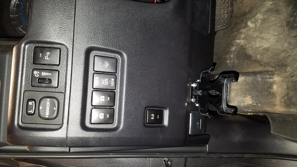

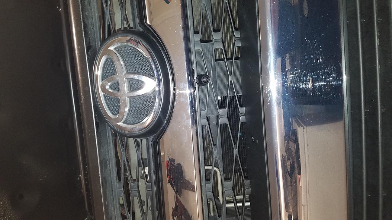

Installed mine last week and I love it. Added the front camera while I was at it. Wired it up so both switches work perfectly independently, via [MENTION=84912]4runnerlaw[/MENTION] 's advice on the diodes. Attached my setup, along with the rough sketch of the WD if it would help anyone. Also grabbed the GPS override from Brian just so I didn't have to cut any more wires.
