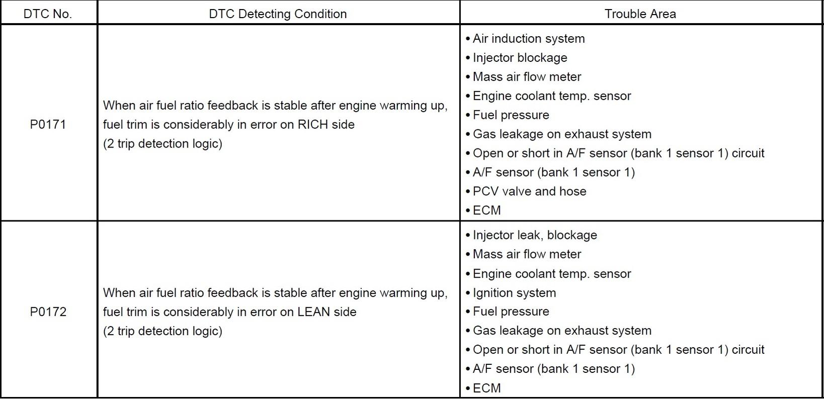

Here's the checklist for the P0171 code in the FSM.
