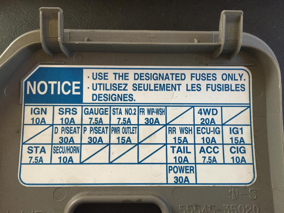

Below is the key for my in cab fuse box, what is STA & STA No.2? What's IG1? I can guess most of these, but there's no key I can find to explain all of them.
I think I just figured out where to plug in the switch blue wire for it's internal LED. Looks like if I plug the fuse tap adapter into the tail circuit it'll light the switch only when I have my parking lights on.

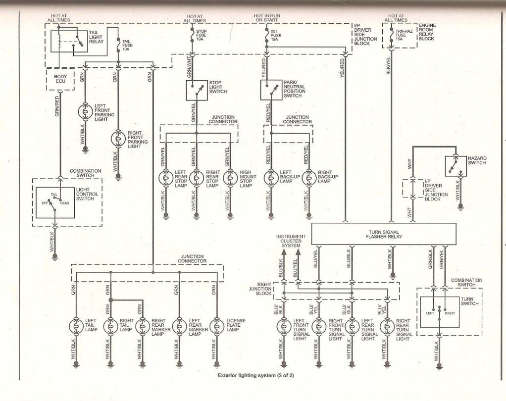

Last night I tested every fuse position I thought might be powered such that when the parking lights are on, the light in the switch is on. By tested I mean based on how I would expect each fuse slot to function (systems it supports). What I found is that even though there are at least two fuses that (from the description I could find) appear to be associated with the parking lights or dash lights; one cuts off when the parking lights are on...the other is always on. It appears like I'm not going to be able to tie it in to the parking light circuit. If that's the case I'll find a circuit that's tied to the ignition. I tried a bunch of circuits that I expected would be on when the ignition is on and all of them were always on. So, yes the DMM is going to allow me to test (more effectively once I understand how to use it) but I've been trying to test what would work in my own way as well.
Thx.
You are too focused on the diagram that stuff came with... aside from identifying what each wire does, that stuff should have found its way into a trash can a long time ago.
Just use CIG or ACC... i've been hint at this since the beginning of this thread.. not sure what you haven't just used that.
I really try and avoid tapping into anything that's "mission critical".
Plus you have plenty of overhead between those two circuits, which are ignition controlled anyways, and really a very safe place to pull from. A fault on those lines dont effect drive-ability in any way shape or form...
In addition to that, if you tap your trigger voltage for the relay from there, you can't accidentally leave your lights on if you forget to turn them off... so that protects you from killing your starter battery if you ever forgot to turn them off. Plus the switch LED is on when the car is on... Simple, elegant, and nothing complicated...
