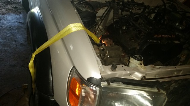

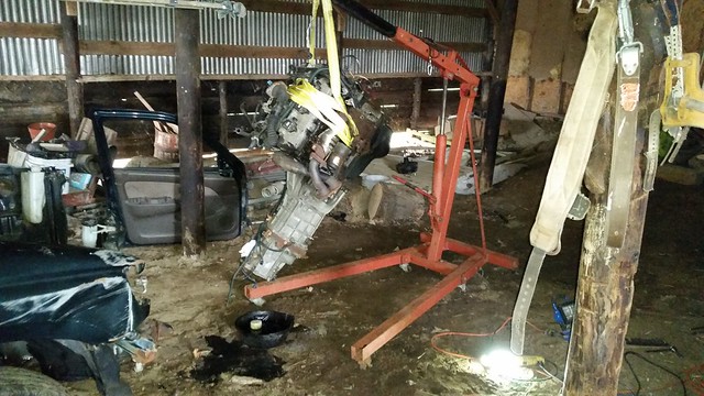

So finally have time to give you guys an update.
Got the motor and more importantly the R150F trans out of the donor truck.
20140503_151356 by zgensler31, on Flickr
The empty hole
20140503_151414 by zgensler31, on Flickr

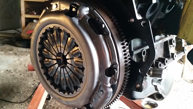

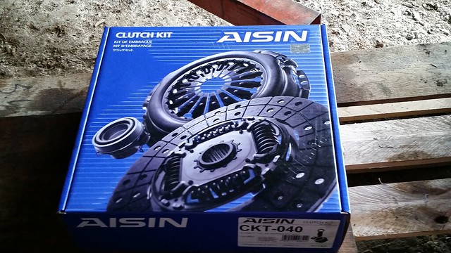

My new clutch kit, had rhe flywheel resurfaced as well.
20140509_183517 by zgensler31, on Flickr
And intalled.
20140509_183454 by zgensler31, on Flickr
Another...
20140509_183501 by zgensler31, on Flickr

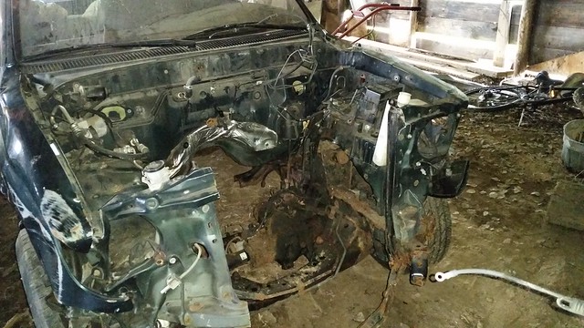

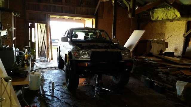

Some shots of the shop/barn ive been working in.
My truck partially torn down.
20140512_183400 by zgensler31, on Flickr

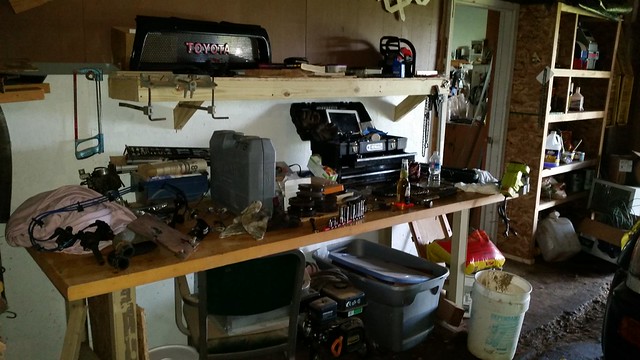

The tool bench. I love how ive been able to do this with pretty basic tools and a shop lift. Not any real specific tools or anything.
20140512_183406 by zgensler31, on Flickr

My truck torn down, almost ready to be hoisted out.
20140512_183450 by zgensler31, on Flickr

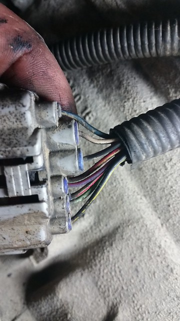

The trans plug from my auto. Its the same as swimmerboys.
20140513_173602 by zgensler31, on Flickr
