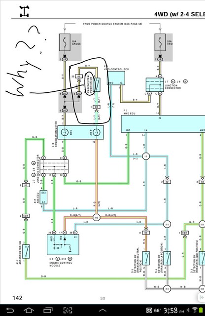

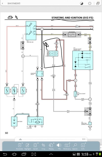

Was just about to head out to the barn and decided to take a second loom at wiring. Noticed one thing thst I had a question/concern about.
There is a park/neutral switch in the stsrting and ignition diagram, and another in the 4wd with 2-4 select diagram.
I have the one for starting and ignition wired up into the cab for he clutch start cancel. Do I need tbe other? Do I need both? Im including the two diagrams, and a video of the attempted start.

No, you don't need the other one, unless you put the auto tranny back in. It's nothing to do with start circuit.
