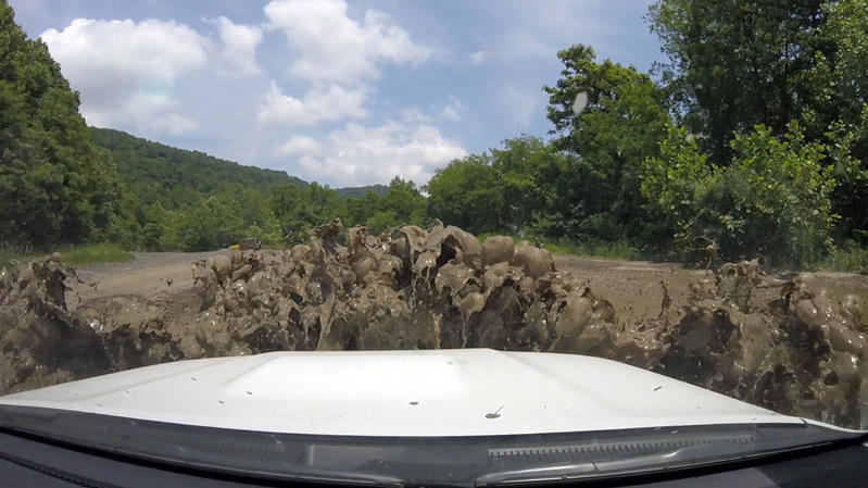

Post mud ingress interior cleanup
...and people wonder why I hate mud and go around water crossings as much as possible...
My wife tried to goad me into a mud hole last time we went wheeling. She was thoroughly unsuccessful and even less impressed. I can't, for the life of me, figure out why people want to coat their rigs in mud when it is such a MFer to get out of all the nooks and crannies. Not to mention the wear and tear it can have on moving parts.
No thanks, I'm good.
I can deal with MANY terrain types but the one I refuse to play around in is mud and/or muddy ass water. I'll forge a nice clear stream all day. Just can't do the turd water. People screw up too much crap playing around in that stuff. It gets in every GD crevice, hole, nook and cranny. I know some people don't care about this and smoke that 40k like they have another 40k to spare if they trash what they have but not this guy. Plus I would end up spending weeks trying to get all the dried crud out from the under body and engine compartment. I feel for you on this one.

I'm with you. I did this with my 4Runner with only a few thousand miles on the Odometer and spent hours and handfulls of quarters trying to get all the dirty muddy water residue off the undercarriage and engine compartment. I still find areas that need some good APC. I will be going around mud holes from now on.
