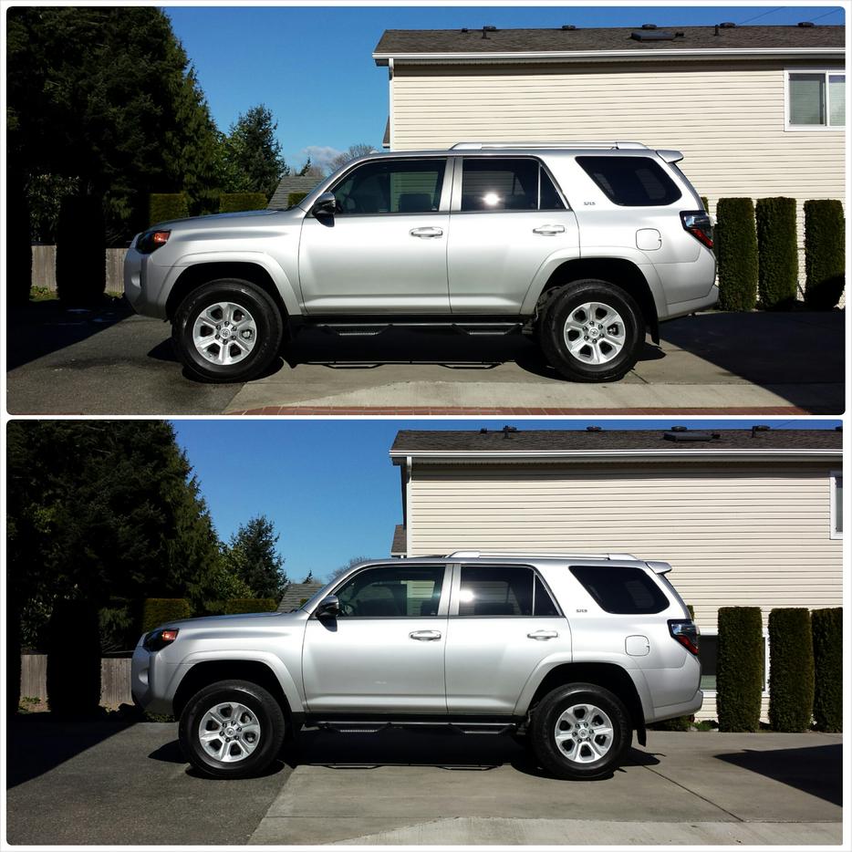

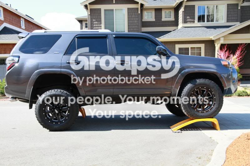

Cranked up my 5100s from 1.75 to 2.5
Rear has cornfed 1" spacers. You can see there is a reverse rake. Going to get some 1.5" spacers and get rid of the corn feds.

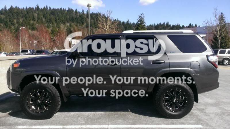

Here is my '14 SR5 Premium w/ 3'' Toytec Lift, 285/65-18's, Carbon Fiber Grill Wrap, Yakima Load Warrior… Love my 4Runner!!!
What width and offset are your rims? Get my wifes 15 sr5 premium on wednesday i need to figure out which offset to go with!

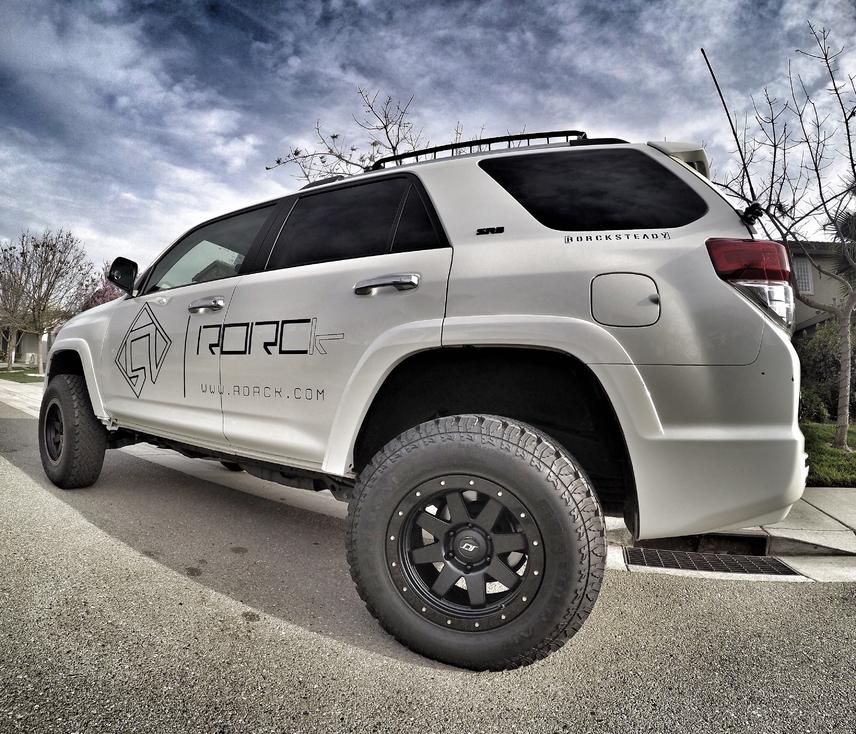

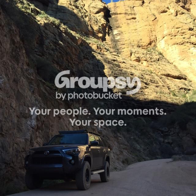

I am running the RadFlo 2.5 kit up front and in the rear I have the All-pro 3.5 in springs with Radflo 2.5 Shocks. My front is about 2.75" over stock (it is adjustable) and the rear sits about 2.5" over stock. In that photo I am running 285/70x17 on a 17x9 wheel with a negative offset putting the backspacing at 4.53 inches. Check my build. On the same amount of lift I am now running a 285/75x17 on the same wheels.
What size lift and wheel width and offset you got on your rig???

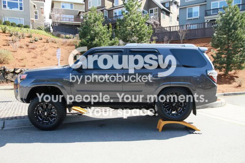

wheels are methods NV "17" 6-5.5 (0/4.75) which is the only backs spacing offered for that size wheel and lug pattern (that I found) per the method racing website.
I can take more pictures if you like
Lift is Toytec Boss lift. I did not adjust the setting on the front coils (which were at 2.5 per Toytec) the rear (driverside) also has the OME trim spacer lift (PN 150PR10)
