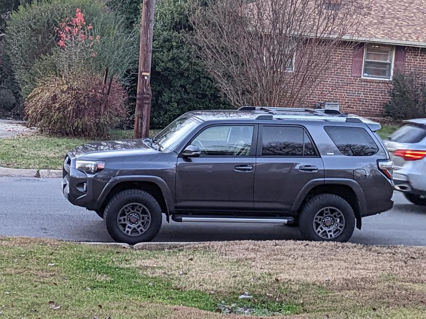

Add another one, 2019 SR5 Pre, Cornfed 2" /1" with Spider Trax and 265/70/17s.
Thinking I need another 1/2" in the front. Wasn't supposed to rub but had a rub yesterday when backing up and wheel turned to right.
I'm up for suggestions? Coil spring upgrade or whole assembly?

You don’t need more lift. You are probably rubbing on the front part of the plastic wheel well liner. If you heat it you should be able to mold it out of the way.
My 22 has a 3/2 spacer lift and the same TRD wheels, yet it still rubbed on the inner fender liner at full lock when backing. It was the lower front edge of the liner. I opted for a Viper Cut as I like the look, but my friend heated and molded hers.

Awesome thank you, I checked and there was very little room at almost lock as you said backing up. Maybe 1/16"
That would def be a problem. Got more mod planned for exterior, new TRD vinyl inserts for wheels as red is faded, few more other goodies. Will post better pics soon
