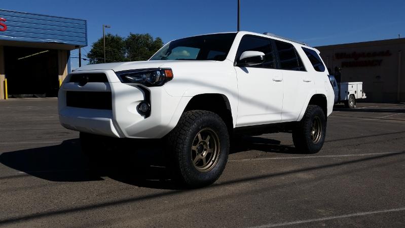

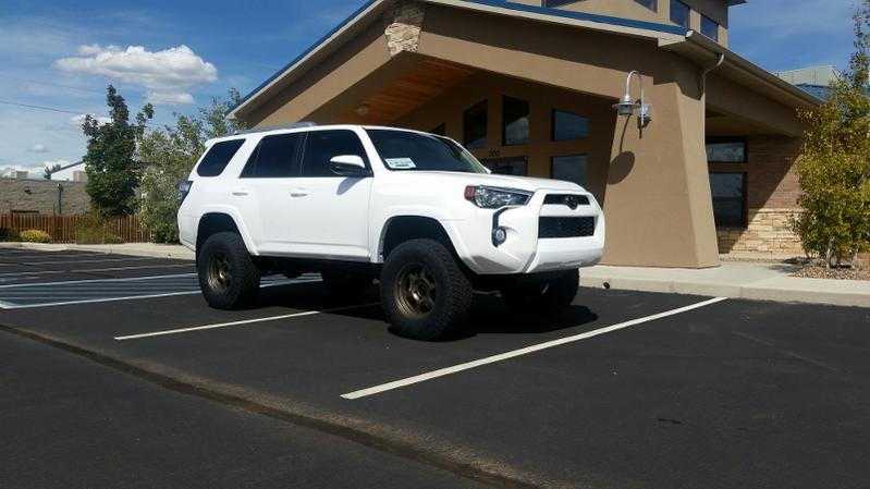

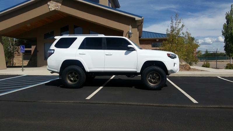

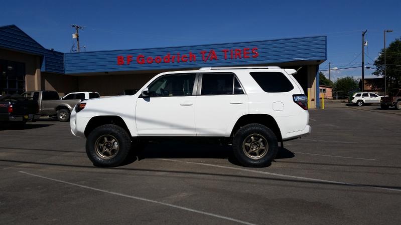

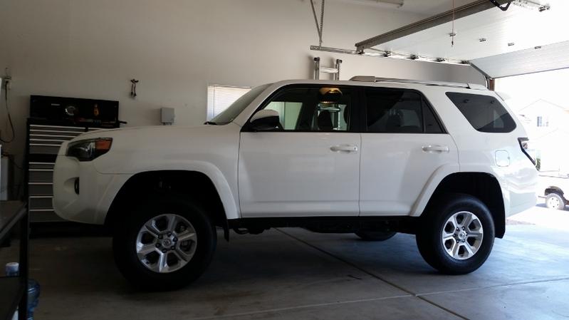

Hello Everyone, this is my first post here. I got my 4Runner 8 short days ago, and have had a busy weekend with it so far.
I lifted it with an Icon Stage 2 kit (substituted Total Chaos UCA for the Icons). The front is set at 3" and the back is lifted about 2.5". The front looks a little high in these pictures because it was just jacked up and had not settled yet. I have about a 1" rake with this setup. I Got Konig Countersteer Type X wheels installed (17x8 -10) and Toyo Open Country AT II Tires installed (285/70/17). I also got it tinted today, but no good pictures of that. I think that's the majority of it for now, its been fun working on this thing!

Nice looking rig. Your lights look tinted in those pictures. Is that an allusion?
How's the ride compared to the stock ride?
Thanks! Must be the lighting, they are stock black housing headlights.
The ride is really good. Ofcourse setting the front at 3" there is a good bit of pre-load, bot not harsh at all. The handling is much better now that the nose dive and body roll is gone. The Toyos are a little rough due to being 10 ply tires, I am currently running them at 40psi. I dont know if I want to drop them and kill fuel mileage to gain a little smoother ride.
If you have any other questions, let me know!

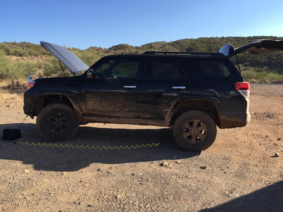

Here's one from my last wheeling trip up to Crown King,Az. Road sucked big time, lots of storms and road was washed out a bit. Little muddy, just airing up the tires!

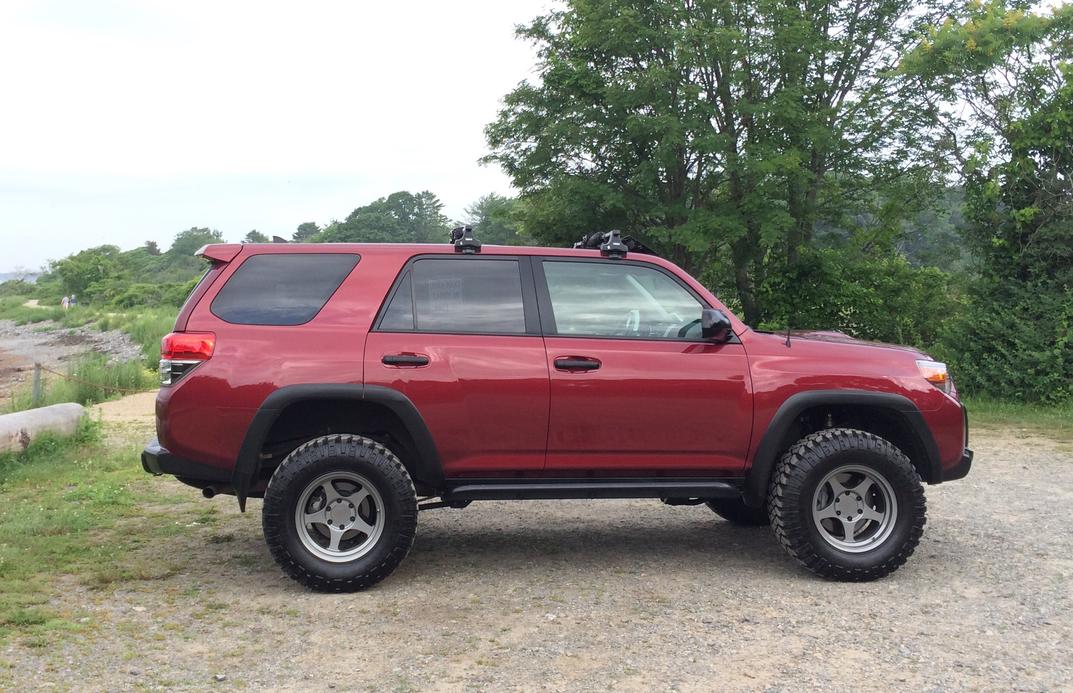

it's been more than 5 years since my 4Runner appeared at the start of this thread. gave it a good bath and got a decent picture recently, and since [MENTION=75328]DannyLlama[/MENTION] requested one, i figured it was a good time to leave this here...

Thanks Buddy! What you have the front set at?
So the rear is with the ICON 2'? Springs? Looks good!
the front are the ICON extended travel coilovers (IVD coated; holding up well) and are set as-shipped by ICON—yielded roughly 2.5" of front lift.
rear are ICON "2-inch" coils—yielded roughly 2.5" of rear lift. all in all, this maintained the factory 2" rake. it's pretty perfect side-to-side and front-to-back.
rear shocks are ICON 2.5 rear reservoirs with stainless shin guards and i also have the ICON tubular uniball UCAs up front.
i should update my signature...

How is that air compressor working out for you? BTW, Big Dustin, beautiful truck. Diggin' the rims with the white Runner.
