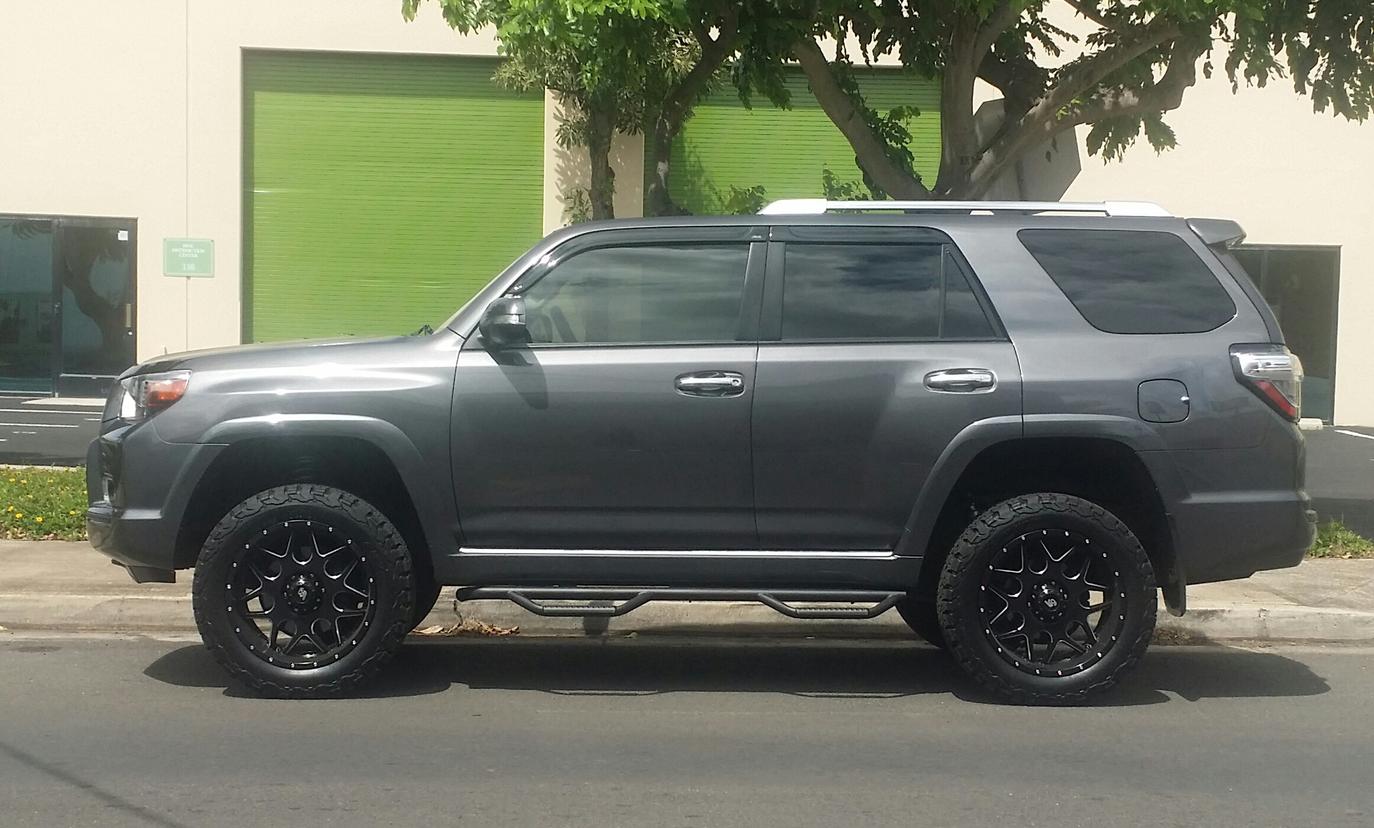

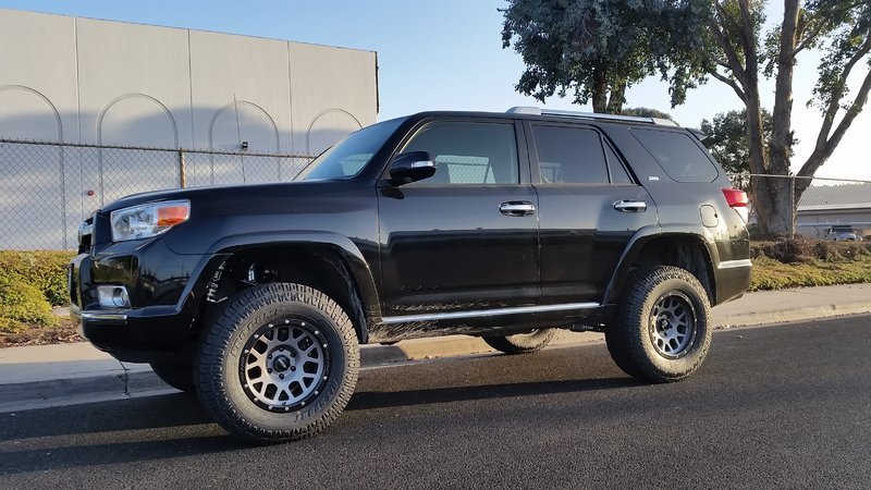

Highly suggest Current Customs/SXS Industries (same building) out of Stanton, CA. If anyone isn't familiar with the area, it is about 15 minutes north of Huntington Beach.
Really great team over there and they were very willing to work with me. If anyone is looking for work, feel free to message me and I can get you a quote or link you up with the right guy over there!

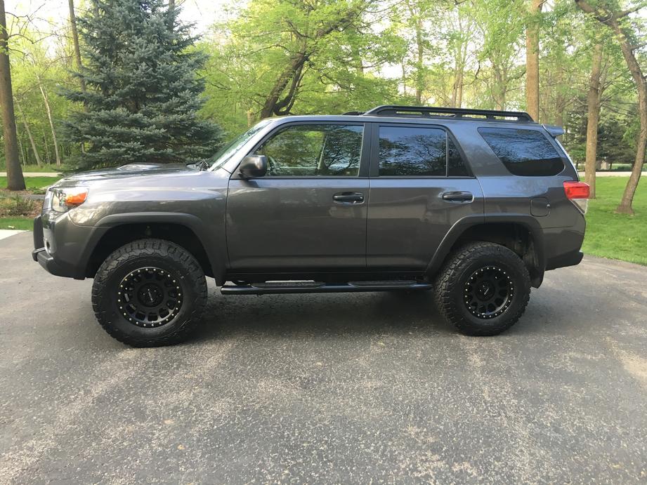

2010 Trail Edition - 2.5 inch Icon Vehicle Dynamics
4runnerKansas_zpskzwzgur5.jpg~original

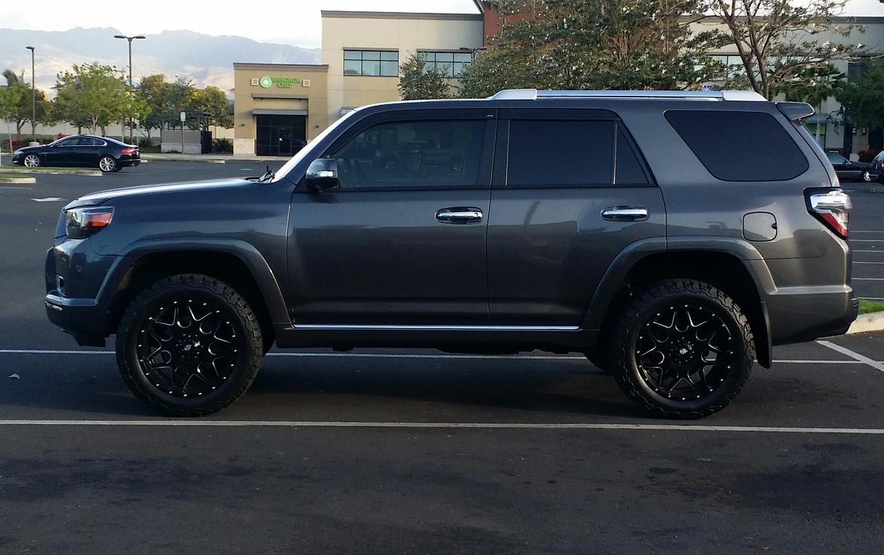

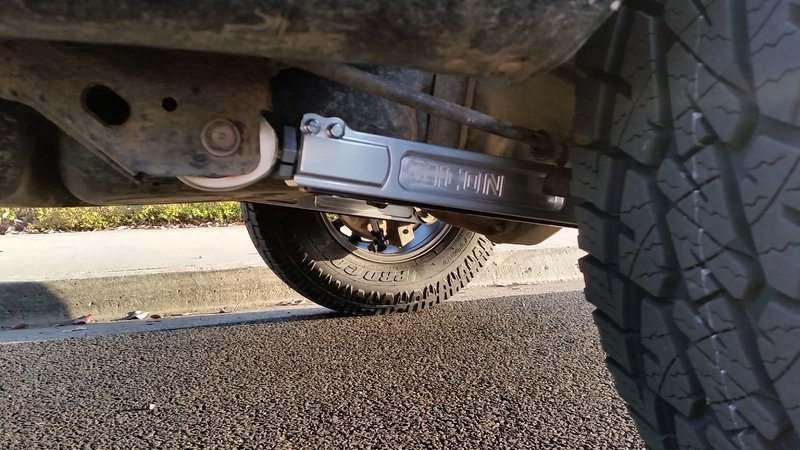

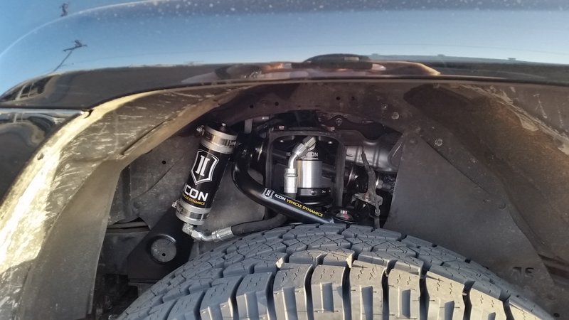

Stage 5 Icon. Pro Comp wheels and tires 285/70/17

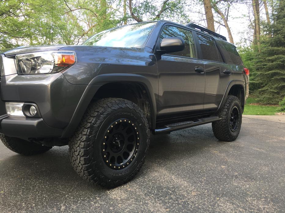

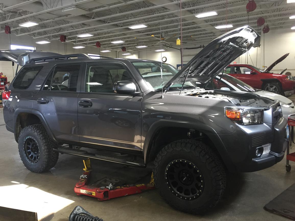

Just got 'er done
See signature below. Loving the ride, look, and performance.

Check the icon install sheet. Coilover looks to be too much preload. Also check cv boots.
Mine came with 15 threads showing from icon. I had to add 5 more threads driver side to level it.
Icon recommends 2.13" or less of threads showing
