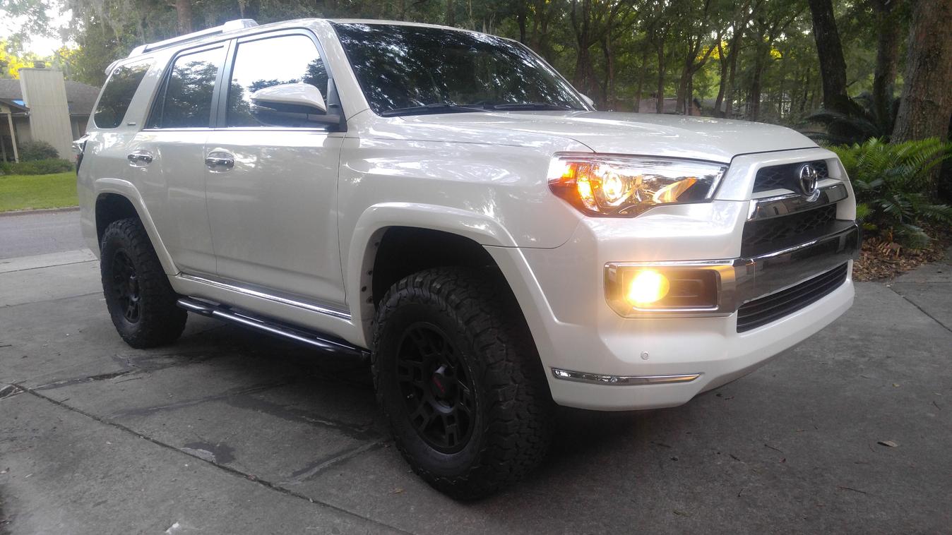

Finally got the lift and tires all put on! Really happy with the results. Also got AMP research power steps installed at Extreme Offroad & Performance, Inc. in Katy, TX.
Bilstein 5100s all around, front set at 2.5", rear has a daystar comfort ride 1.5" spacer. Stock front upper control arms.
Tires are BFG 275/70/17
This is one of the best.
Looks awesome. I'm considering this suspension. How is the ride quality, nosedive and body roll?
And what UCAs did you go with?
Thanks! Ride quality is awesome, nosedive is slight on hard brake, but it's totally fine and feels under control and tight with a smooth return. I can take exit ramps as fast as most cars with no issues, but you can feel a little roll on hard turns (U and slower hard turns), but I consider that normal.
Overall, I am very happy with it and once I get more lower weight from full plates, sliders, front bumper, etc., any concerns will be all about torque.
No aftermarker UACs at the moment, but I'm going to put some TC UACs on it soon; although, I don't feel a huge need for them at the moment.

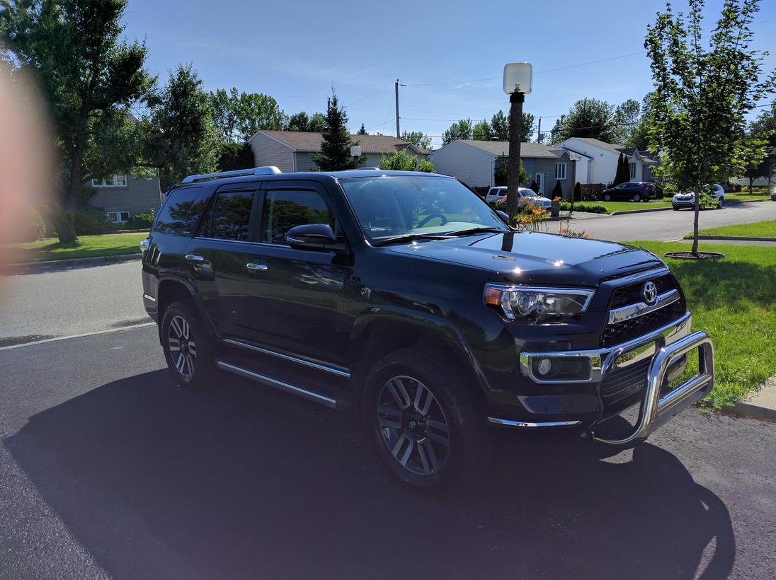

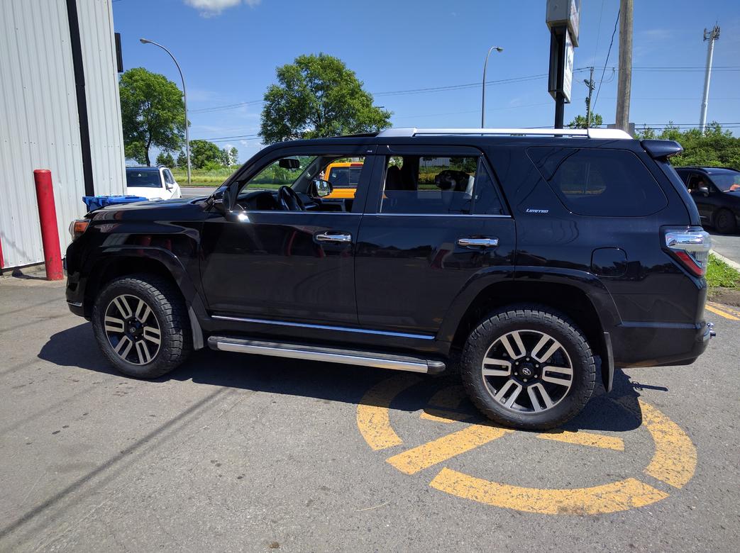

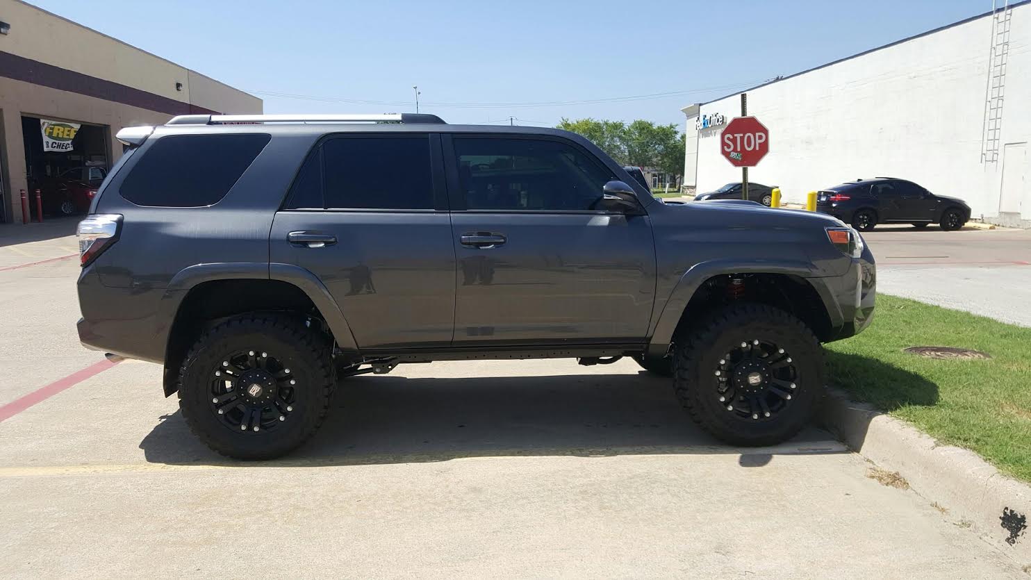

2016 limited with x-reas & kdss. Daystar lift kit, spidertrax spacer & nitto grapplers 275/55R20
I didn't think XREAS & KDSS was an option or available. Are you sure?
I was under the impression the whole reason the Limited didn't have KDSS was because it has 20" rims and XREAS which handles much in the same manner as KDSS onroad.

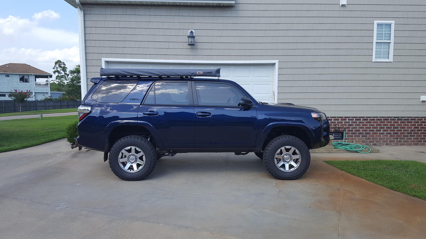

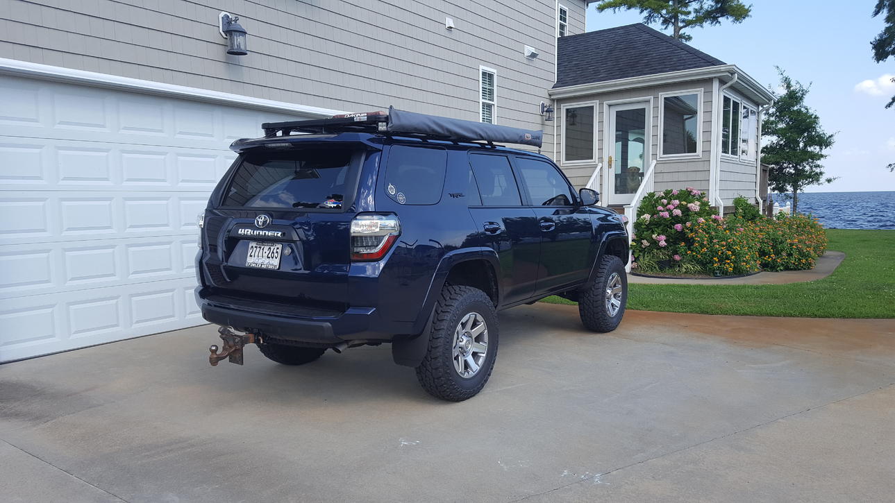

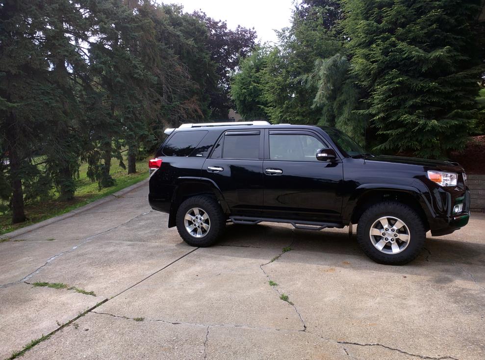

bilstein 5100s set at 0.85 with OME springs
cooper 255/80/17 and spidertrax
