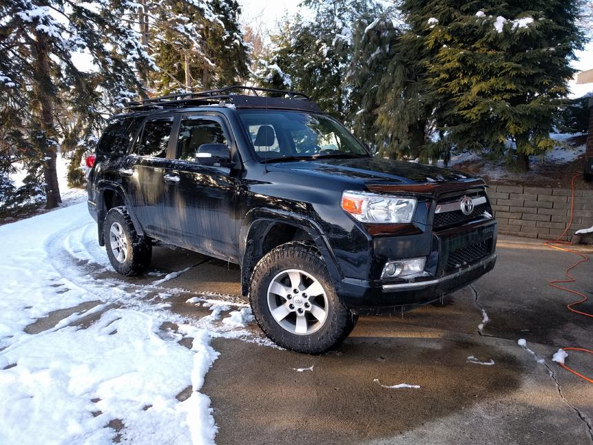

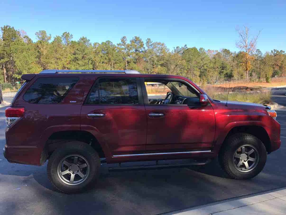

Haven't posted any pics for awhile but here's a pic before more changes .

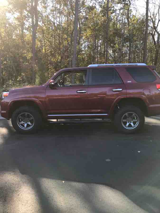

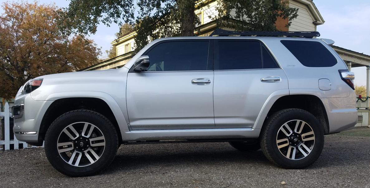

After waiting a few months, it's finally done. Bilstein 5100 front (1.75") and rear SAW 1.5". Also, added Level 8 mk6 17x8 0 offset. Will maintain stock size tires until it's time to change. Pics are right after install, so hopefully rear will settle a bit, but I don't mind the rake since that was my intent. IMG_0033.JPGIMG_0035.JPG

At 1.75" in the front and the rear coils being 1.5" wont that give you an "ass-high" or negative rake? Unless that's what you wanted!!
Yes, wanted to maintain factory rake. IMO, negative rake won't occur with this setup. Even with full load, probably will just sit level.

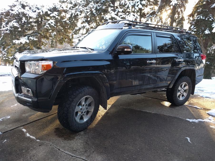

Installed the Prinsu Rack today with my older son, he did an awesome job at helping assemble it. (simple enough an 11 year old can do it!)

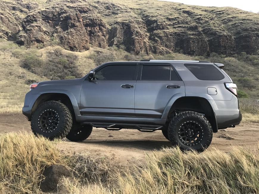

<a data-flickr-embed="true" href="https://www.flickr.com/photos/126450354@N06/30575474776/in/dateposted-public/" title="Pismo Beach 2"><img src="https://c1.staticflickr.com/6/5792/30575474776_637096ee69_b.jpg" width="1024" height="683" alt="Pismo Beach 2"></a><script async src="//embedr.flickr.com/assets/client-code.js" charset="utf-8"></script>

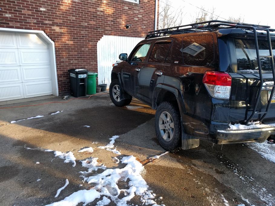

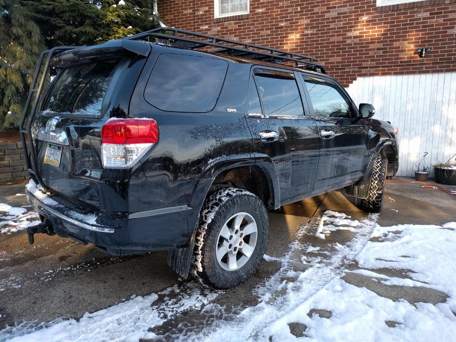

Would love to see a few more pics and hear about your experience with this setup thus far!? I'm thinking with the 6112's and the rear height you have (Which doesn't seem to reflect much rake) sounds like EXACTLY what I'm looking for :-)
Sorry been a while since I have been on here. I can get some more pictures. As far as impressions...I can't say that I have a single complaint. I started with stock coils in the rear and the 2" up front. Decided I didn't like that so added 1" Cornfed spacers and still looked off so then I went with the SAW's. It's pretty close to stock rake unloaded I would say.
Performs better than stock in every way. It's stiffer so less brake dive but I think it rides better (subjective).
Would also like to see a few more pics if you wouldn't mind. This seems like the exact setup I think I may go with. Looks good man.
Here you go.
