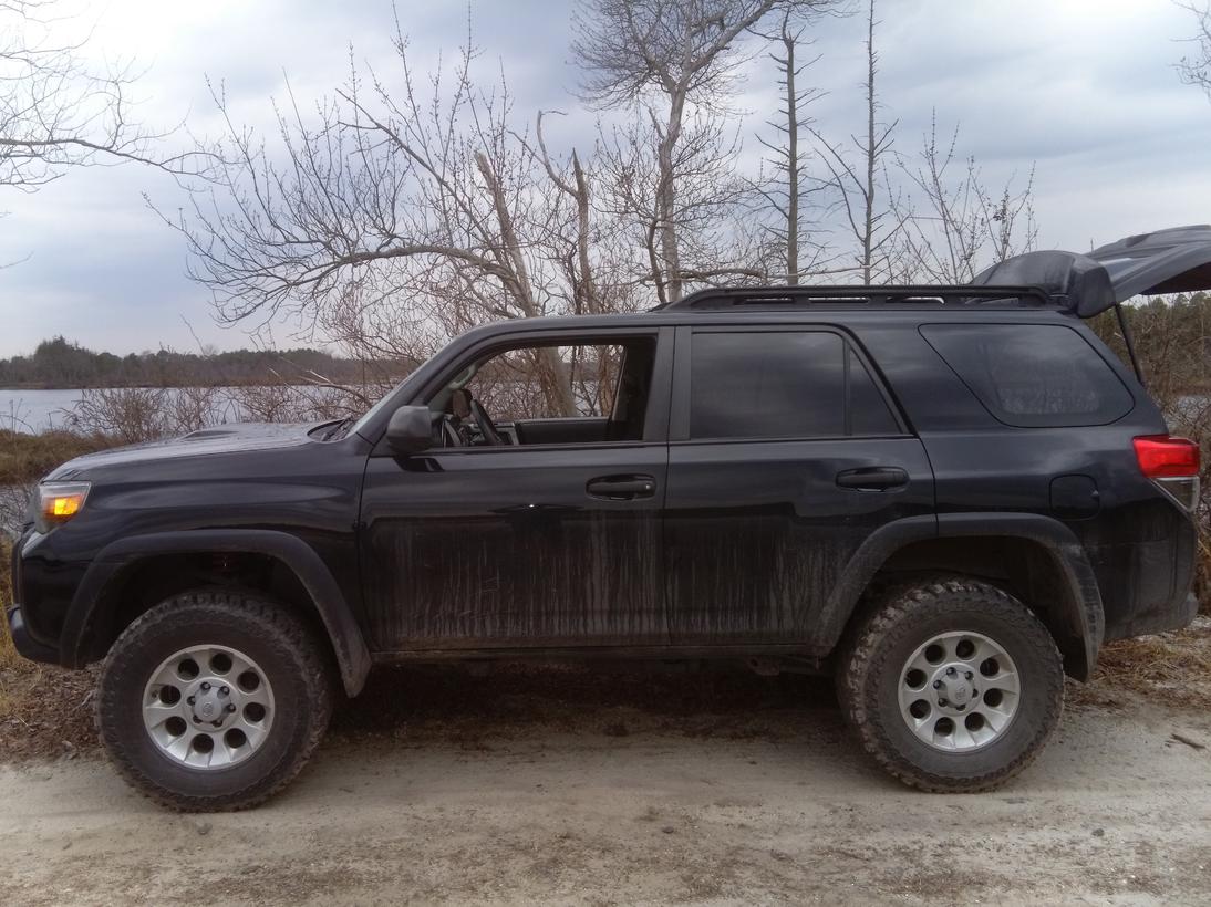

Bilstein 6112 in front, Driver side set on 4th notch, passenger on 3rd notch from bottom. 5160's in the rear with stock springs. 265 KO2's
