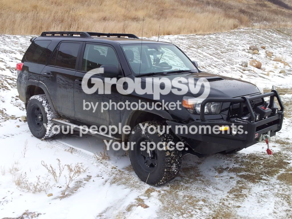

RUNNER.jpg~original
Any more pictures? It looks great!

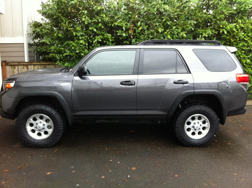

Newly lifted 3/2 toytec lift with 255/80 KM2 tires. So far so good, just need to repaint the wheels, they were pretty scratched up during install. No rubbing which is the reason for the tire size. I will have better pictures tomorrow.

I've been looking at the same tires for a while now. Would very much like to see photos from the side (length of the truck) if you have a chance to post.
Thanks and nice looking rig.

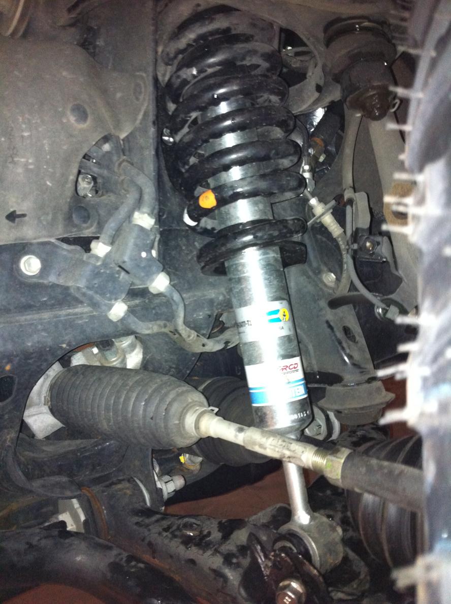

Running Bilsteins all around, front at 2.5" and rear with Toytec superflex 2" springs, also installed some Goodyear Duratracs 285/70/17 no rub after liner mod.
Front wheel well height is 37.5" and Rear is 39.5"
Drives like a dream and looks like a beautiful nightmare.

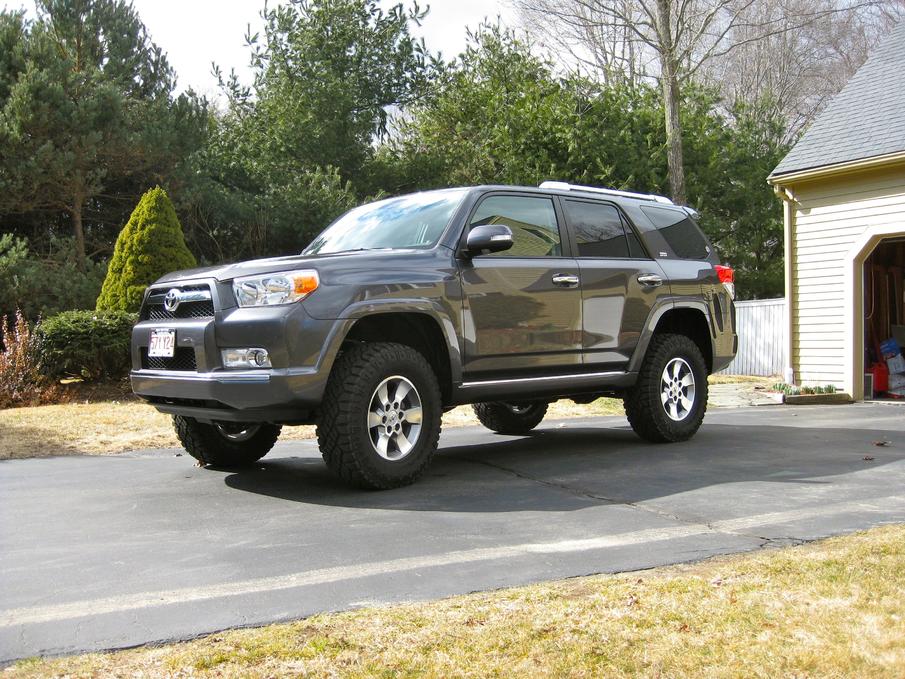

Daystar leveling kit with Duratracs 265/70/17

Is it me or is there something not right about that lower shock mount?? Is the bolt broken?

Yeah, looks a bit off. How it feel when it drives? I would go back to the shop where you had it installed or the dealer and have them take a look at it.

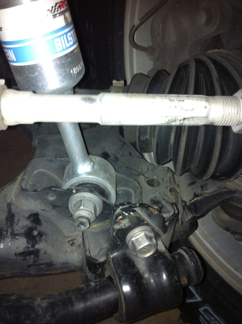

No its not broke, its just the way the photo is. the shock bolt is hidden behind the KDSS bracket which is what you are seeing. Here is a better pic.
