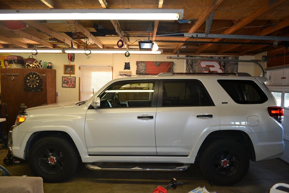

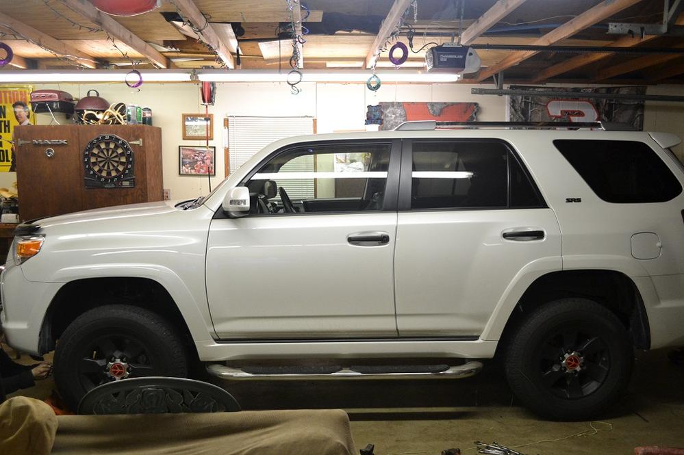

Upgraded from 285's to 295's...
295/70/17 Nitto TG's fit...and look awesome - ride great as well. Slight rubbing at full lock when flexing, but minor trimming will fix that!

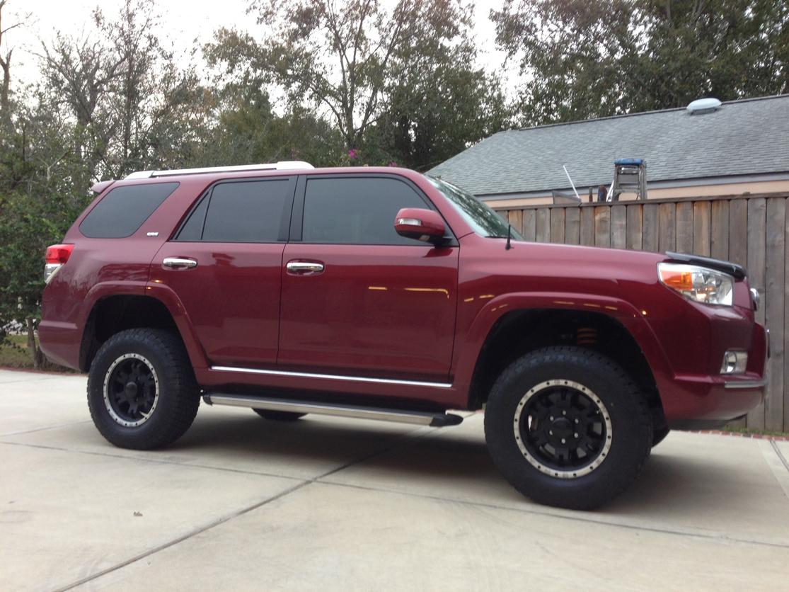

I found out that my 4Runner's driver side rear shock was leaking and my passenger side front strut was leaking at 40K miles. My driver side front was completely blown but was replaced while it was still under warranty.
Instead of replacing it with OEM parts and suffering potential leaks down the road, I decided to call MetalTech 4X4 and explained the situation. I don't do any hardcore offroading. I take the 4Runner on some difficult terrain in Big Bend National Park but nothing that will raise the hair on the back of your neck (mainly to get to a remote trail head). We decided on the Ironman TOY0BKG (struts, shocks and springs); the cost was a very reasonable $510 (a bargain in my book). Ironman is a Australian company and that make quality susupenion pieces. It system will fit either the FJ or the 4Runner and give it a 2" lift. It's the nitrogas system. The offroad shop said the install was very straight forward with no issues. The alignment came out fine (don't have the final specs on me at the moment). It's just a hair under 38" to the front fender and a hair under 39.5" to the rear fender from the ground.
I put on 1000 miles on the new suspension (all on road) and the ride is stiff but still comfortable (I believe someone on the FJ forum stated that it was 20% stiffer than OEM). The nose dive has improved tremendously and the corning is much sharper (no wallowing) even though the center of gravity is higher. I finally installed my rims (Granite Alloy GA09's) and 265/70/17 Nitto Terra Grapplers. Overall I am very pleased with the new look. I lost 1MPG but it's well worth it.

I'm digging the look with the 2" lift and it's more for what I was looking to do with mine. Thanks for the info, looking forward to see longer term review, since I don't think I've seen anyone else running that setup.
What springs front and rear do you have?

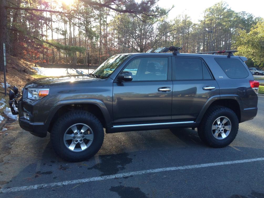

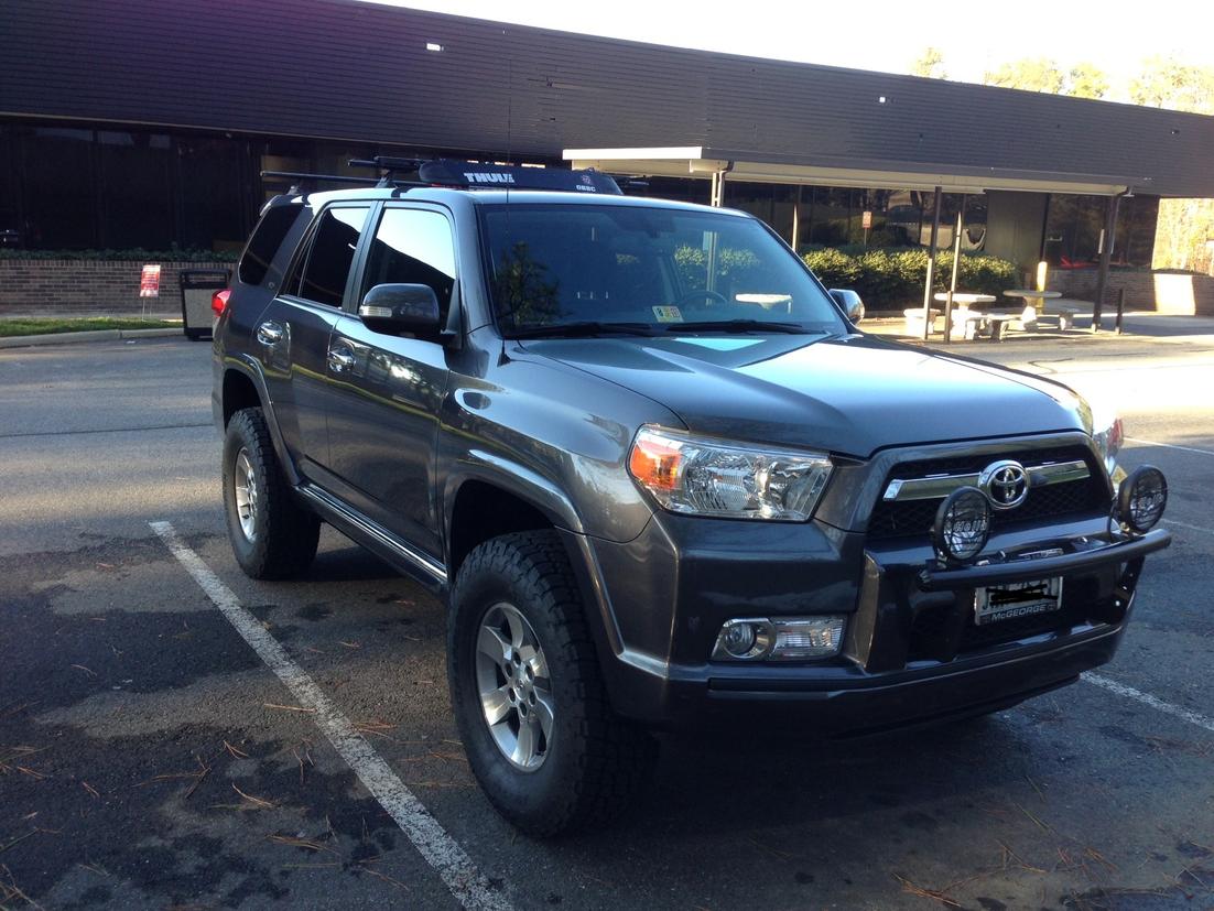

Finally
I didn't Think I would ever get to post in the thread...After almost 1 year of ownership:
Before...
After....
Bilstein 5100 on all 4 corners. Front set at the highest 2.5" setting and 1.5" Daystar spacers in the rear. Final ground to fender measurements are 38" on both sides up front and about 38-1/2 on the passenger rear and 38-1/4 on the rear driver.
