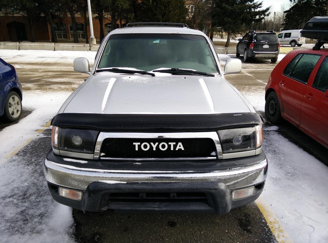

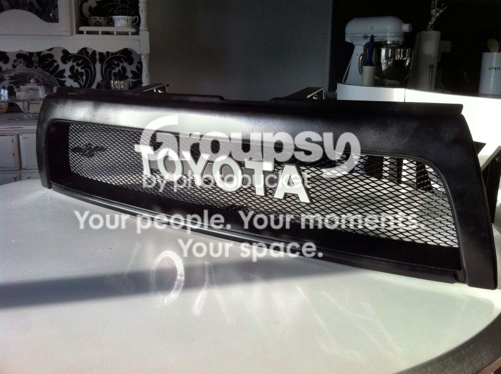

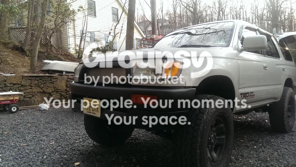

Mine is going to be similar to [MENTION=92884]snivilous[/MENTION] satoshi in that mine is like the Raptor grilles too. I'm just waiting for the letters to come in now. Mine will say "TOYOTA". I even have the rectangular mesh, the only thing I don't have is the channels because I don't have a way to make those bends cleanly like the Tacoma Raptor ones do. I used the same mounting method that [MENTION=44220]BigFishAllDay[/MENTION] used, and it is super strong. I'm super happy with how this came out, I think it looks super clean. I should have my letters in here sometime soon. I can't wait. Here's a few pics for now and I'll get some more once I get my letters in.

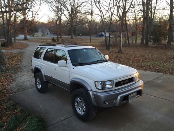

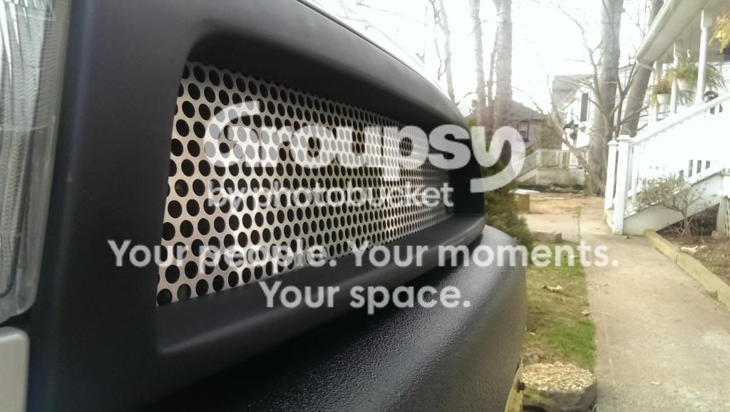

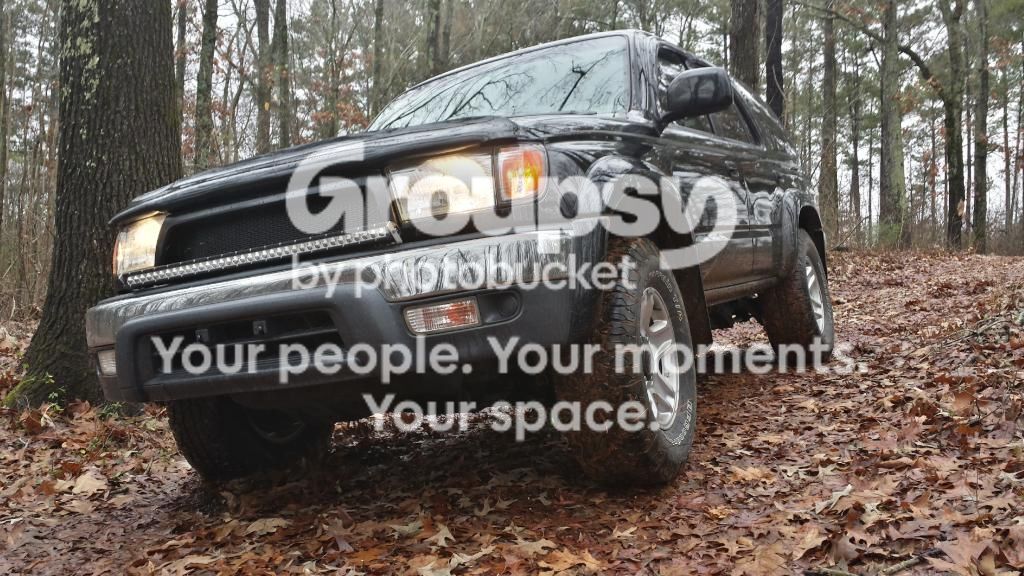

My satoshi grill, I have to give credit to my friend who did the work. Did a darn nice job.

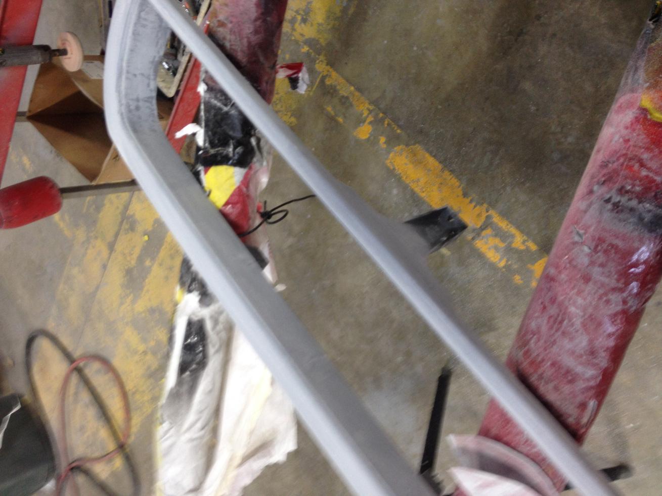

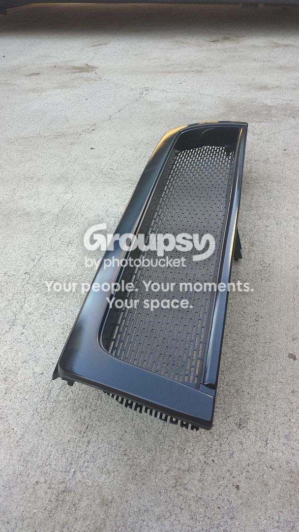

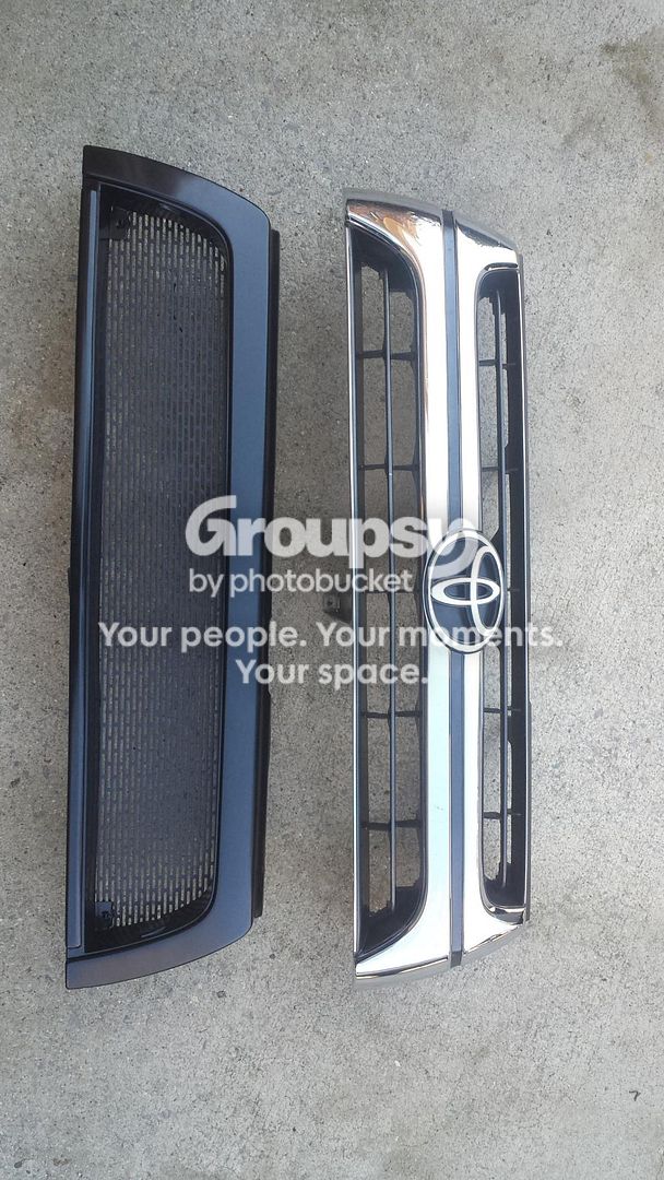

Working on mine today, prime-sand-putty-prime-sand-paint salsa red hopefully I'll finish it those weekend

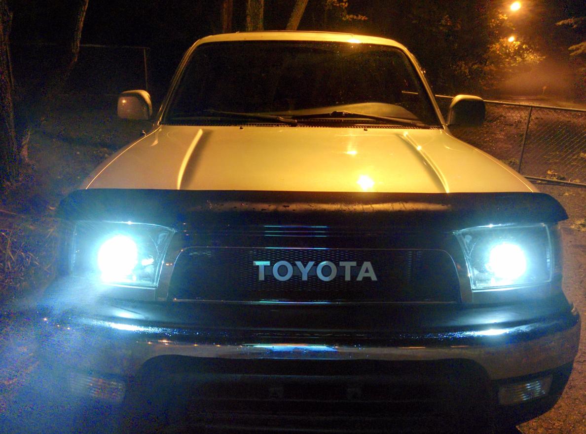

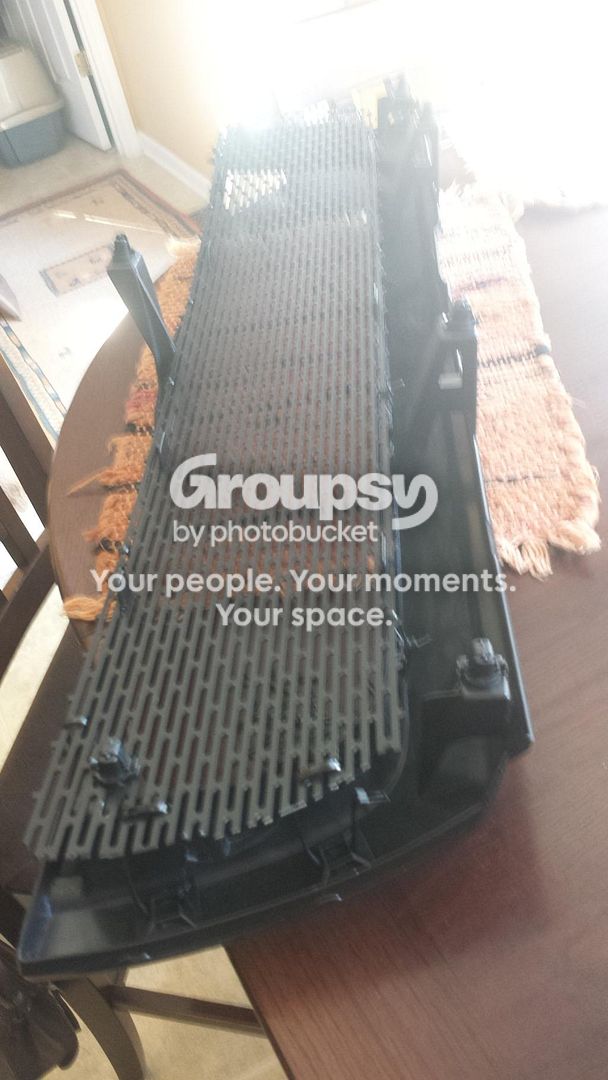

I originally bought mine off a member here, the outside of the grille had been modified and I just needed to install the mesh that had been precut. I was debating on having the FJ Toyota emblem, or leaving it blank, and I had seen zopperman used a 4Runner emblem which was cool and unique and I had seen the Tacoma Raptor grilles, so using our 3D printer at work I printed some letters for mine. I like it since it's unique and I haven't seen any other grilles like it. Nothing fancy, the letters were 3D printed with black plastic and then I painted them and just epoxied them onto the mesh. I've debated on painting the chrome black or color matched white, and also debated on doing a white outline on the letters or doing them white or silver since they're kinda hard to see in poor lighting...

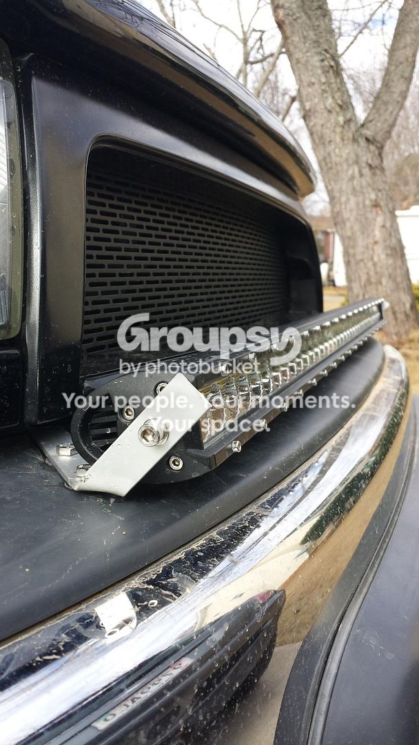

What kinda led bar mounts are those ? What size led bar ?
If chrome is bubling. Just sand it of and paint it black.
I put bondo on the edge of grill to give it a rounded look because our grill has like a edge.
It's a 50" bar, the mounts I made out of 1/8" steel. Nothing fancy, just triangularish shaped from the side and then I bent them in a vice and use two self tapping screws (same as all the ones on the frame) to mount into the door frame underneath the door seal.

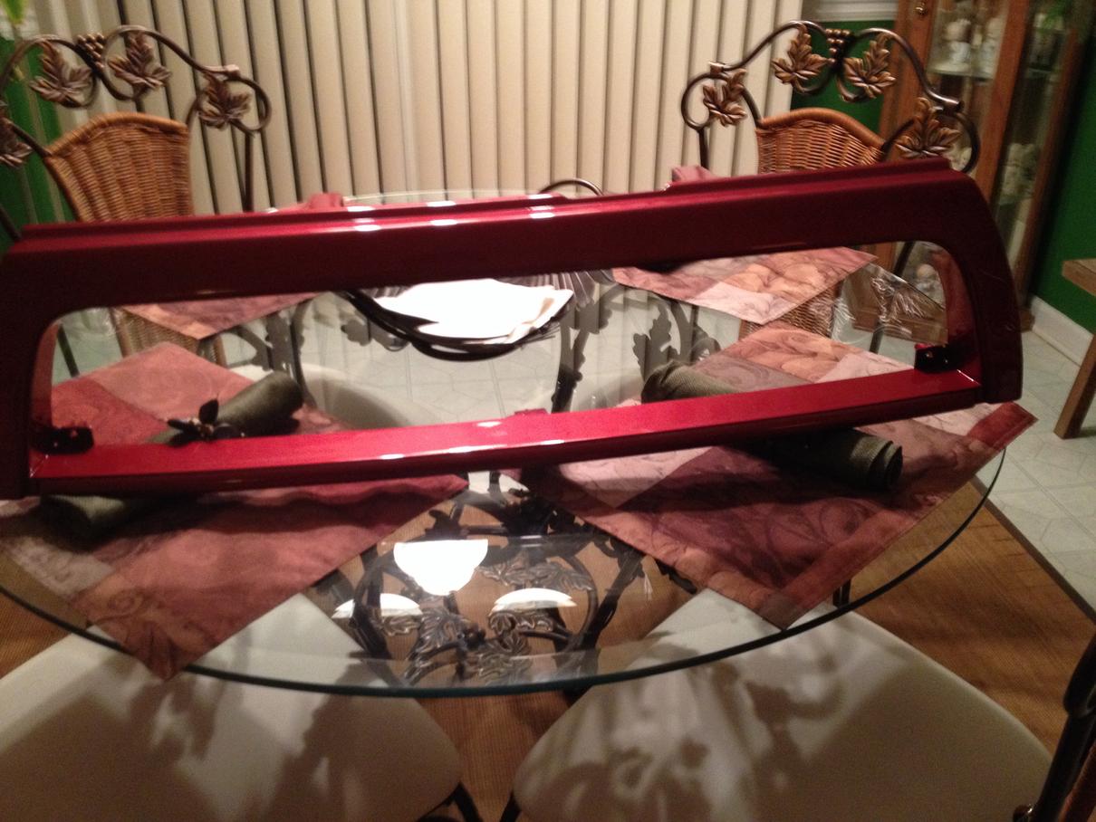

Got it paint matched to my custom salsa red pearl/metallic. Now I just have to add the mesh then my devil horns.

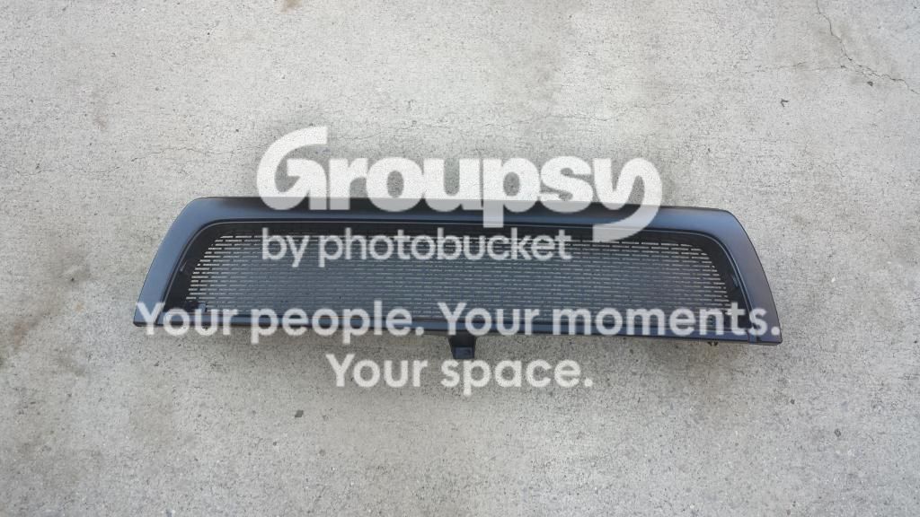

So when yall are making your cuts what do you do to seal up the giant holes that the center cross bar leaves in the main frame of the grill?
I cut a small rectangle of rain gutter mesh (for the eves of your house) and epoxy and attached it to the backside of the cutouts of the cross bar. I then backfilled the openings with bondo. I also bondo'd the seam between what was chrome and what was black, all around the opening of the grille (even the two gaps in the lower corners). Pics are in my profile's photo album. Be patient, it will take a while to sand out.
