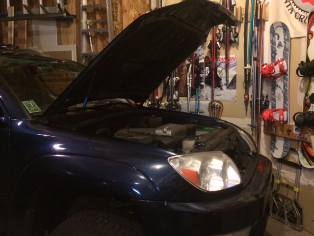

Installed new hood struts! 1st time in 5 years I didn't need to use a stick to hold up my hood. Thanks again T4R.org!!! Saved me over $100 from what a Toyota dealer quoted me!
Liftsupportsdepot.com - Part #PM1024kit4w X 2. $47.43 including shipping.

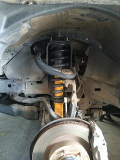

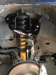

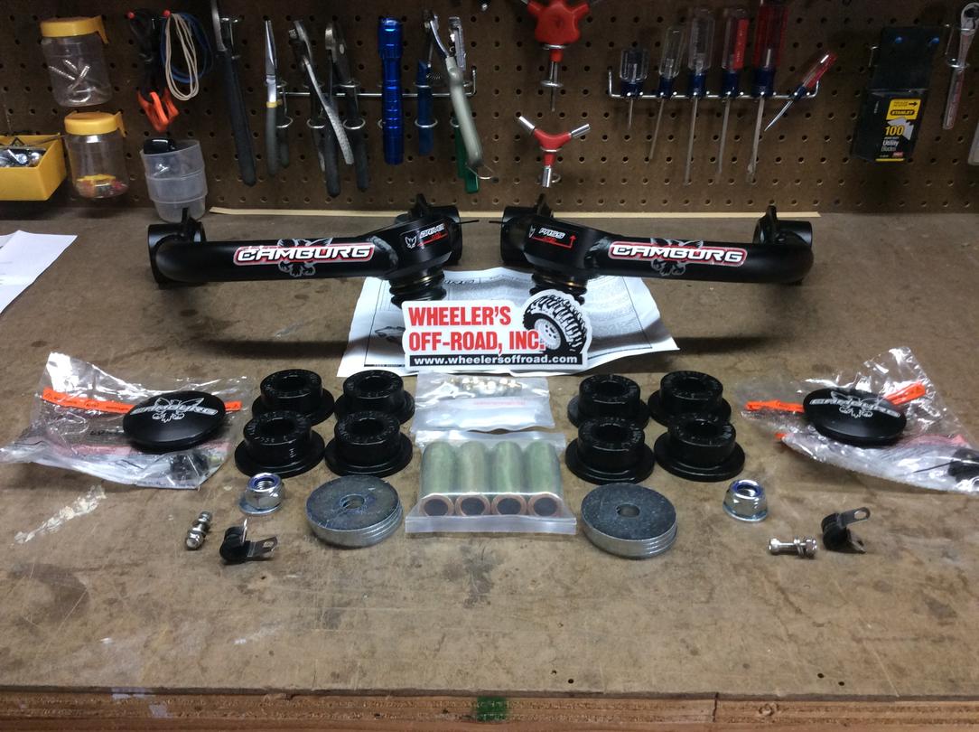

Ordered my new Camburg BJ UCA's today from Wheelers Off-Road, Inc today! Thanks [MENTION=87036]YotaDan[/MENTION] for the help!
Hopefully I'll find 2-4 hours to get them installed before dads day!
Stock UCA
New Camburg UCA's installed
The Camburg UCA parts
Camburg BJ UCA's are installed! Test drive without alignment was good to go and already felt better. Hoping to be further dialed in after I get alignment done over the weekend.

Also noticed with your UCA pictures, you can see the difference in position of the BJ in and should help on the caster. I'm just surprise it doesn't allow to get it back to specs w/3" lifts. My experience that is.
So what the one with the horse on it for, to push vehicles in reverse, LOL.
Nice looking ride, I really like the blue color models!!!
Thanks!

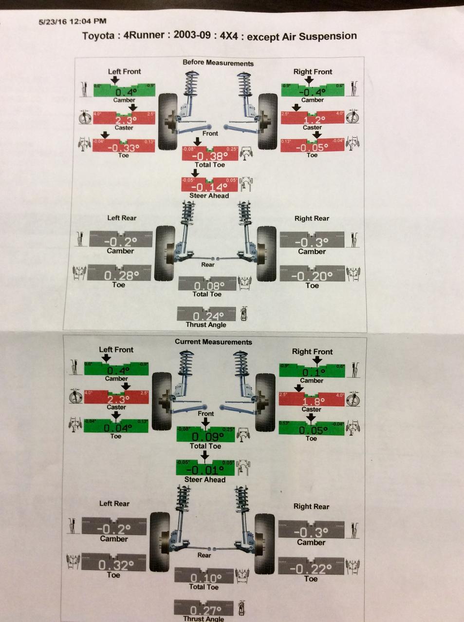

I was surprised too. I had a Daystar 2 1/2 X 1 1/2 and was able to get Castor at 2.5. Upgraded when XREAS crapped out to a 3"+ and could only get .5. Now I've got more travel, stronger arms, should get better alignment #'s and they look cool too!!! Lol
Final alignment #'s after UCA instal. I didn't end up with caster in spec, but I'm super happy with the #'s and my T4R drives super awesome again. Lol...it drove pretty damn well even wth a .5 caster before upgrading to the Camburg BJ UCA's too!!!

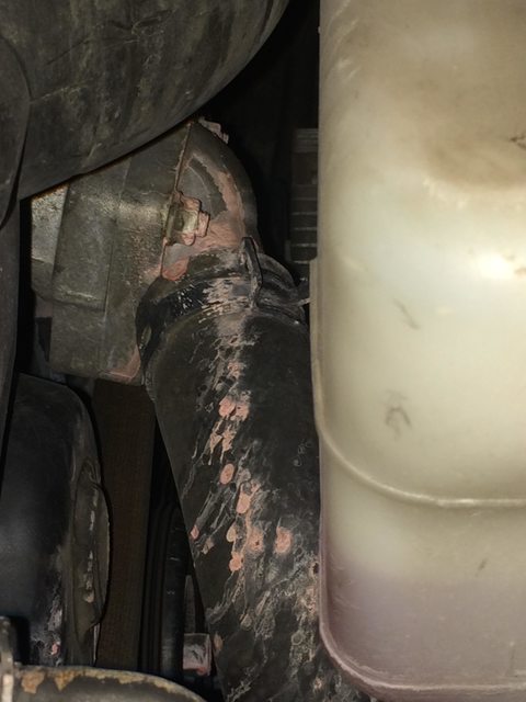

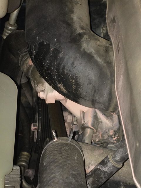

Added a quart of "pink" coolant at 117, 502 miles as the reservoir was low and there was pink on timing belt cover and other areas on front of engine????? I didn't see any obvious leaks upon visual inspection. Going to monitor levels and see what happens.

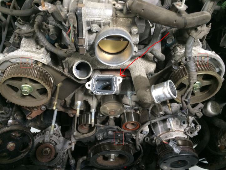

Hope your leak is nothing major. Did you replace the tb and water pump yourself? I thought it was silly when I did mine that they have people make their own gasket with RTV where the thermostat housing connects to the water pump. That would be the first place I'd look for a leak, should be able to see it just under the throttle body without taking anything apart. :thumb3:
3 days later I added 2 more quarts to rad and overflow at 117, 518 when engine was cold. 1st q was added "only" to overflow when engine was hot. Took for a drive to bring to temp and pink level was full. As the engine cooled fluid level, in overflow reservoir, dropped to about 1/2 (between low and high) of overflow reservoir. Checked level this morning and the fluid level had dropped to about 1/3 so I topped off today, 6/30 after engine cooled overnight.
Cleaned off residue from hoses and areas that had pink on them. Time to monitor and inspect.
No...above my pay grade...lol. I had a Toyota dealer do it. Would these gaskets/connections have been taken apart/replaced during a timing belt H2O pump replacement?
Just picked her up from dealership - coolant leak is suspected to have been coming from radiator cap and getting sprayed by fan. No more leak when dropped off at dealership, pressure tested fine, and coolant has not been leaking since original "scare".
I had trany fluid + pwr steering fluid flushed and changed at 117,500 miles while it was in for coolant leak assessment!
phew...think I'm done with maintenance and repairs...for now.
Sorry, didn't see this. Yes, when they take the water pump out the gasket needs to be replaced. You "make your own" gasket with RTV for the connection between the wp and thermostat housing. Glad it wasn't your issue! :dancin:

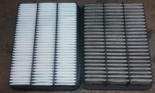

1) Removed the eBay LED's (flickering little POS with no customer support) and put stock bulbs back in my license plate lights!

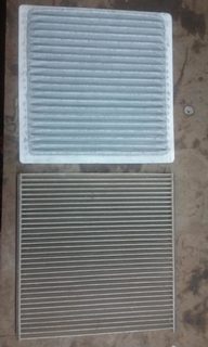

2) Replaced cabin air filter
3) Replaced air filter
