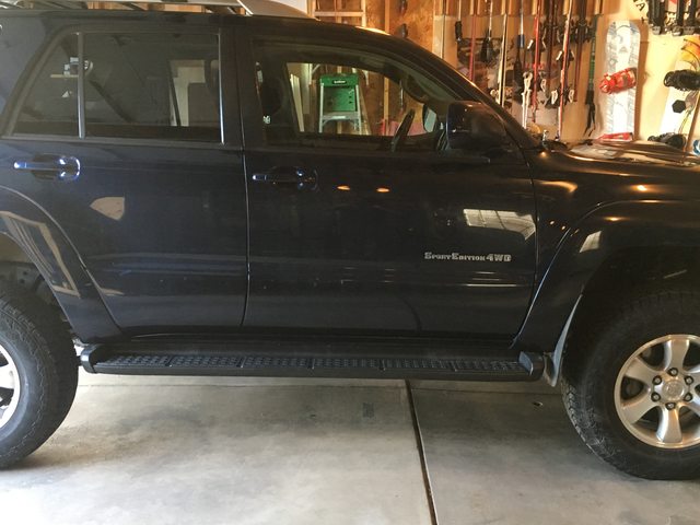

New light bulbs.
This might be the biggest mod of the day! OK...not really a mod just some general lighting maintenance.
12/27/2016
121,982
Replaced low and the original high beam light bulbs with 9005 (high) and 9006 (low) with some Sylvania Silverstar Ultra bulbs. As I have reflectors in my 04 and this isn't a daily driver I kept it simple.
Edit: Added some so so garage images with fogs on for both pics.
Low Beam
High Beam

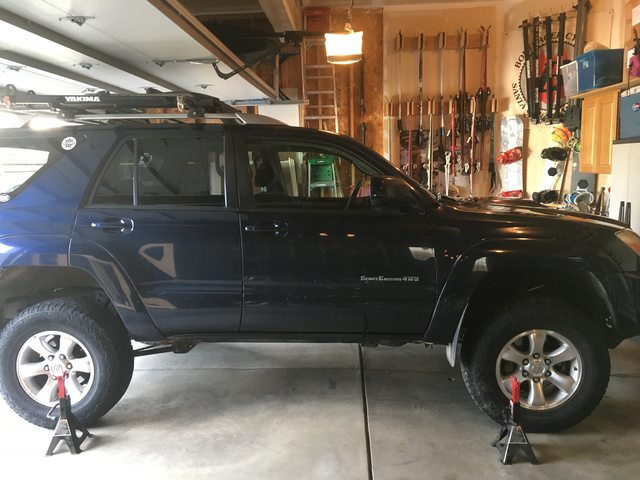

Update from 1 year ago. I installed OME/Toytec 1 year ago and the numbers haven't changed! Sweet...
Original center of axle to bottom of fender and preliminary after
DF - 22" and 23"
PF - 22" and 23"
DR - 22" and 24 1/2"
PR - 23 1/2" and 24 1/2"
1 year later
Center of Axle to Bottom of Fender
DF - 23
PF - 23 1/4
DR - 24 1/2
PR - 24 1/2
So...measuring in "basically" the same place in my garage I have experienced little to no settling with my lift! It's also sitting, looking at and using a level on the running boards, dead nuts level at the running boards.

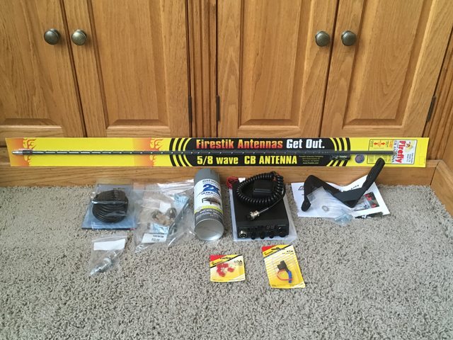

It's CB Time
As I'm getting back into wheeling/overlanding/playing with my T4R, I thought was time for better communication.
It's CB TIME
Uniden ProXL20 CB
Firestick Firefly 3' Antenna
CBI 4th gen antenna bracket.
I'm hoping to install this week.

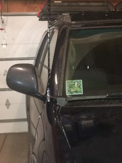

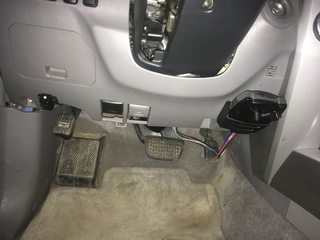

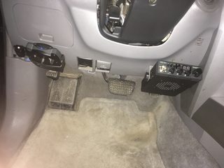

Well, I got through most of my CB install, but I ran into a couple snags along the way. One of which requires the purchase of a 90 degree stud mount or ring type connection. There isn't enough clearance between the fender and CBI Antenna Mount for a straight stud mount. I also checked the antenna bracket for continuity and got nothing! :redbrick: I am now planning on grinding down the powder coat around bottom of bracket and hoping for good continuity. I DONT want to remove bracket and grind down hinge mounting holes. I might end up with a ground strap if this is the case.
But, here is the progress so far. I'm hoping to find or order a 90 degree stud mount so I can finish the install.
1) Relocate KARR alarm switch and trailer brake
2) Finalize location and install CB Radio - I was hoping for a quick knurled nut disconnect, but there was metal behind dash that foiled my initial plan. Permanent (sans screwdriver) mount for now. I also painted the CB bracket grey to blend better with dash.
3) Install CBI Antenna bracket [MENTION=64712]CBI OffRoad Fab[/MENTION]

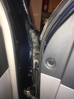

This was a bit of a PITA for one person, but I was able to get it done mostly according to CBI instructions. I had to remove an extra bolt by the headlight strap and another fender bolt inside the door jam. It is located behind the plastic cover in the next image. This is an antenna install which has some additional requirements than a ditch light bracket and the instructions were for their ditch light bracket. As AWESOME as their fabrications are I was hopeful CBI's install instructions would be as good as there products. Love the bracket, but VERY disappointed in install instructions.
Also!!! Make sure you dremmel, sand, or file down the powder coat on antenna stud mount hole area as well as the holes around the hinge mounting holes! If you don't you will not be guaranteed of a good ground! I'm learning the hard way and I'm now hoping that grinding down around stud mount hole will be enough and I don't have to remove the bracket to insure a good ground. As a CB noob, I was a little disappointed CBI didn't mention this in their instructions or cover the holes with green poly during the PC process.
Before the surgery began
The final CBI install with Antenna
My clearance issue...this would have also been nice for CBI to mention so I could have ordered the right stud mount (90 degree heavy duty) or a different coax cable with a ring connector.
4) Install antenna
5) Connect power and ground

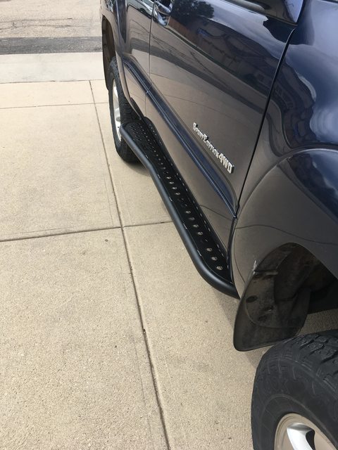

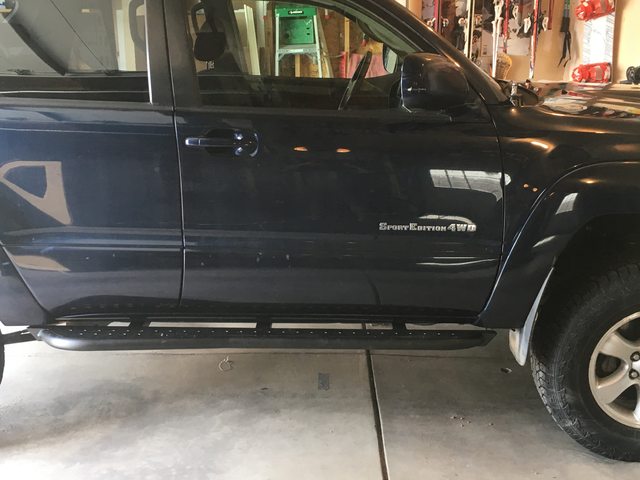

My sliders arrived!!!
