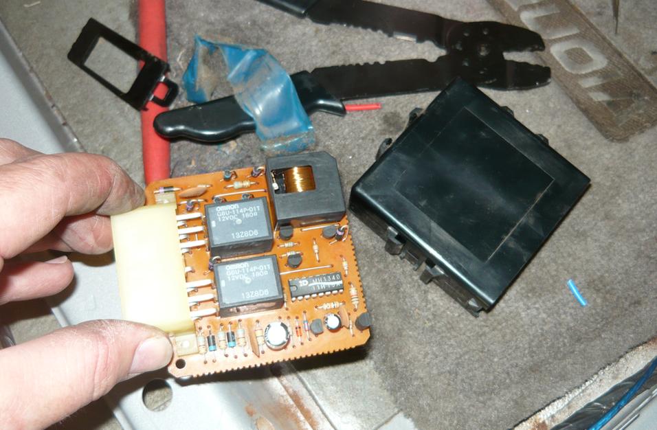

Probably the Door Control Relay, PN 85980 I believe. Sit down before you look up the cost for a new one.
It is under your dash near the steering column. When mine went out I removed it, cleaned it with electrical cleaner and gave it a few love taps to get it working again.
Although this is a repair for the rear window relay, you may find some ideas on what to do if you have to take it apart and repair.
Below is what they look like.
