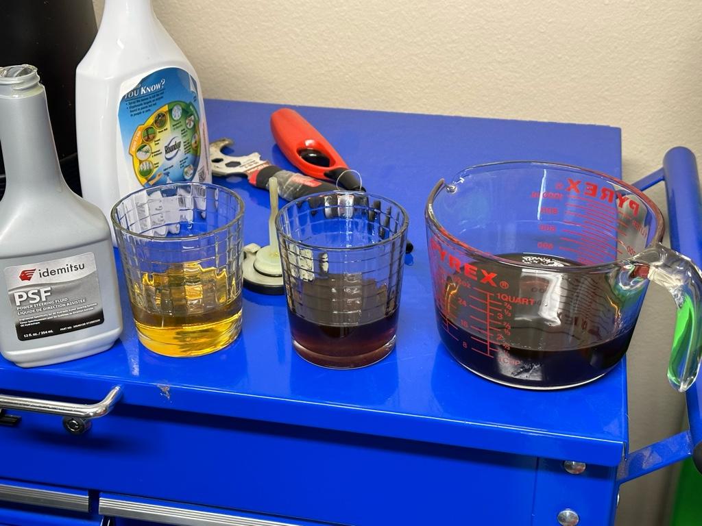

I was wondering how often you guys change your power steering fluid out? I did mine today at 40k miles. Emptied the reservoir, refilled turned the steering wheels a few times and drove around the block. I did this enough times to use 3 12oz bottles of PSF. I did notice a few particles in the PSF I removed. Hopefully I just didn’t waste my money.

You can flush the PS fluid by simply jacking the front tires off the ground, removing the PS return line, and turning the wheel clock to clock with the engine off and the key in the on position.
To prevent a mess I plug the return port on the reservoir and extend the return line into a bucket on the floor. As soon as the reservoir is almost empty and before it can suck air, I fill it to the top with new fluid.
Repeat the process a few times until the fluid running out is clear.
No turkey basters, no partial fill, and easy clean exchange of all PS fluid.
