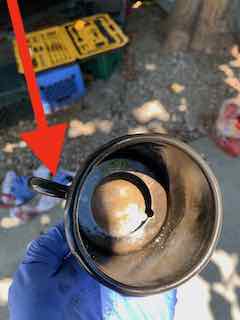

I have little stiff, noisy power steering wheel on T4R 3rd gen. I clean the reservoir filter with brake fluid without open the top of the reservoir. My mechanic has confirm the PS pump is still good. No fluid has been lost either
Later find-out that the return line was block with gunk oil not flow freely I got the copper wire and thread it thru. Make sure you goes thru pass the metal tab at the end of the return line.
The return line is unblock and PS fluid has flow freely as it should. Like others has posted the PS pump is meant to last and it won't break easy. If your engine is on and you still be able to turn the wheel with not much effort, then the pump is still performed.
