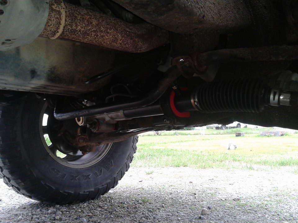

Here we go.... this is the one I meant to put up.... ;) Cost me $350.00 to have the shop install it. Took 2 guys, 5.5hrs to do it.... because they couldn't get the hoses off the original either.. :p
