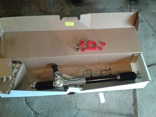

Here's a shot of the NAPA rack and Poly bushings I'm gonna get installed... :)

Take a socket or something and drive that black rubber bushing out of the rack and install the poly one before you take it to the shop... That way they won't "forget" to do it and cut any corners... Its easy to do and should only take a few seconds

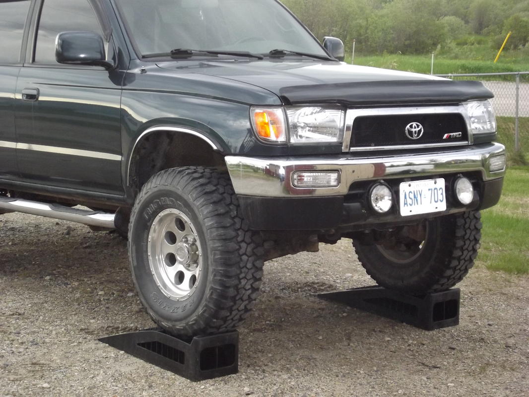

I've decided to try and do this myself.... gonna put the runner on ramps tomorrow, and get started. Wish me luck! :)

Well.... this is happening.... Started tonight... but gonna keep going on it tomorrow morning. :)

un bolt the rack first and start to remove it, the lines have some play to them, once you have everything lose and "free" you can slide the rack back a few inches and gain some room to work -ask me how i know... having had to take my rack in and out several times over the course of my front end overhaul i became rather good at this... this trick was advice given to my by my father inlaw who walked me through it the first time, and he has been doing this for years on these trucks.
I'm having trouble with the lines.... and not even sure what size wrench to use on them.... can anyone elaborate for me?
