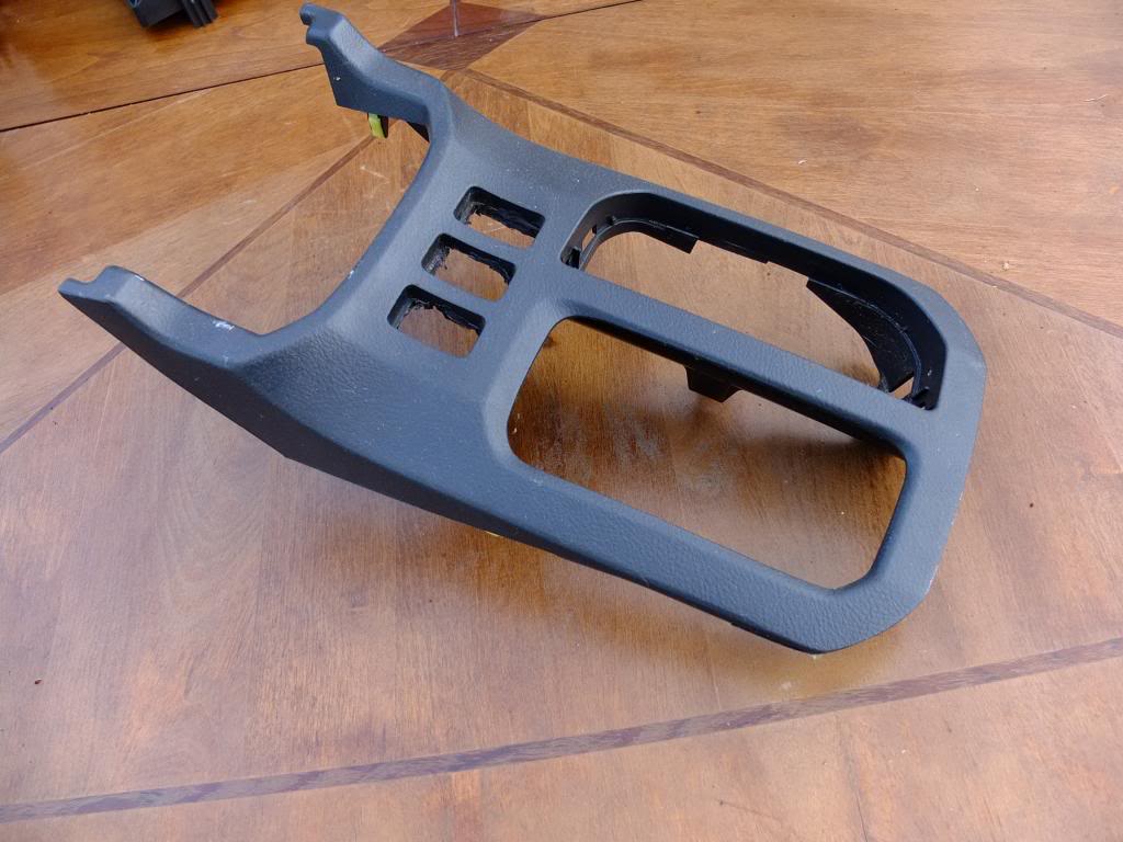

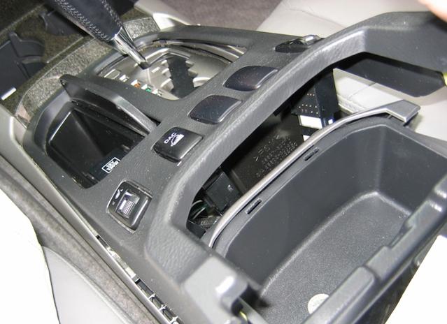

I'm looking to swap out the center console upper cover on my sport edition for a Limited one because this will give me two extra slots to be able to drop in OEM switches. Does anyone know if these are swappable? Also, i'm pretty sure I found the part number for the Limited part, 5882235020B0, can anyone who has done this swap or who had a Limited confirm that this is it? See pics.Sport upper cover.jpg

I'm looking to swap out the center console upper cover on my sport edition for a Limited one because this will give me two extra slots to be able to drop in OEM switches. Does anyone know if these are swappable? Also, i'm pretty sure I found the part number for the Limited part, 5882235020B0, can anyone who has done this swap or who had a Limited confirm that this is it? See pics.View attachment 200148
Did you ever get an answer? PM me and I will check. My wife has an 03 Limited and I have an 04 SR5. I'm lazy so I'm not going to check unless you would like me to real quick :) Not sure if this would help considering mine is an SR5 and yours is the Sport.
There are no differences but the two slots, you can swap no problem!
