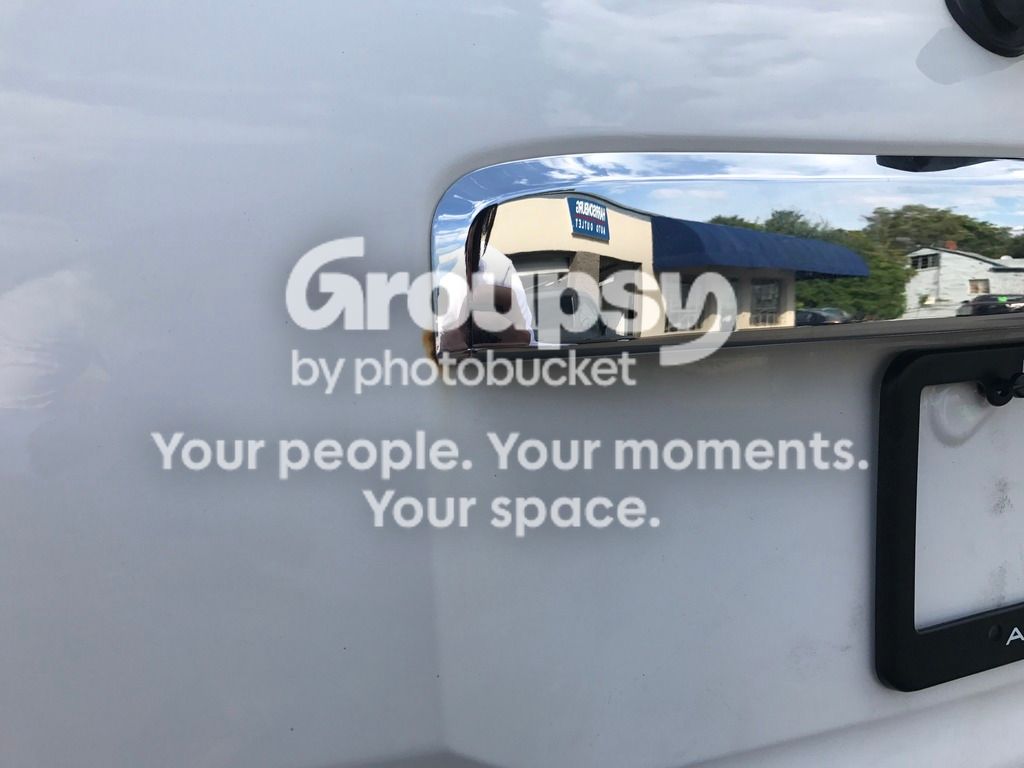

Hey guys, not sure exactly where to post this but seems about right. I am in the market for a 4runner. Went and looked at a 2006 V6 4wd SR5 w/ 165,000 yesterday. It looked pretty good overall with one exception. Rust is starting to show just underneath the chrome trim piece on the lift gate. Can this be fixed easily? Impossible to fix? Or somewhere in the middle. I will attach a picture for reference. Also, is around $11,000 a fair price for this truck? Or is it too high/low? Thanks!

Saw quite a few 4Runners with rust on the back hatch when I was shopping last year. Common spot was right under the rear wiper motor and the 2 bottom corners of the rear glass where rain drips.
You'll have to pull the chrome trim piece off and see where else the rust is. Don't trust that the rust is only where you see it. If its on the surface, you can treat it and re-paint it but its hard to do on a body panel without it looking like its touched up. Curious to see what the inside of the hatch looks like also. Rain can get into the hatch if any of the seals are gone.
IMO, I'd stay away from rust on body panels (or rust in general). Just too much of a pain to correct and an eye sore, unless you can score a heck of a deal bargaining against that.
