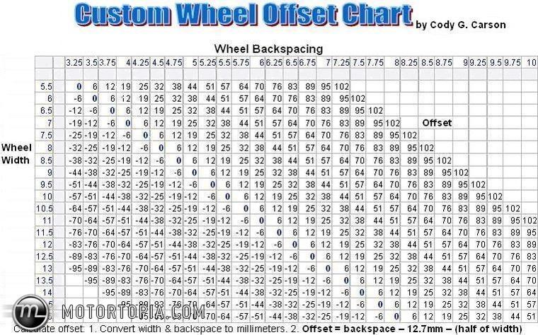

Negative 6 on the offset doesn't give enough info.Need the rim width or backspace to get an idea if they would work.Stock backspace is 4.5" with the SR5's and Limited having 7" wide with the TE's having 7.5" wide.
275/70/17's fit perfect but not many tires made in that size.
See, here is the offset chart .
The 7033 in 17" only come x9 with a -6 offset which equals 4.75 bs. Unsure if you would have any rubbing issues.
