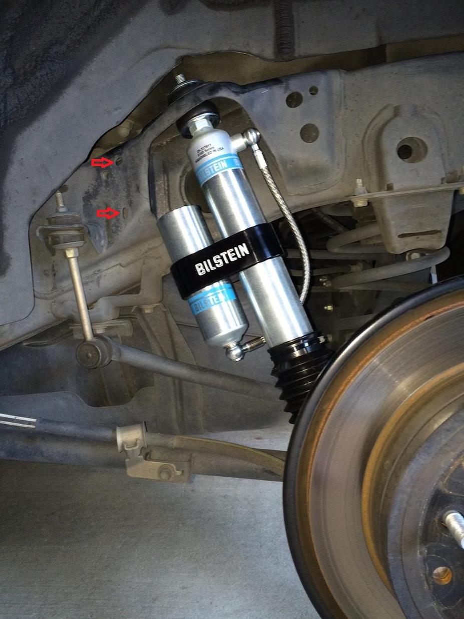

I've got Bilstein 5160 rear shocks on the way. Because of the tough environment a shock absorber lives in, with constant vibration, pounding and jostling, I'm concerned that the Bilstein billet clamp could turn .. or the entire shock turn because of the top stud type mount, and cause the remote reservoir to contact something else down there. Hence, I'd prefer to use the remote reservoir mount from the PRO suspension. I expect the remote reservoirs are very similar (the same?).
Could someone with a 4Runner PRO or a retrofitted PRO suspension, put a caliper across there remote reservoir and get a dimension on the diameter. If it's only off a little either way, a good ole' Bridgeport can make it work ..
Thanks in advance

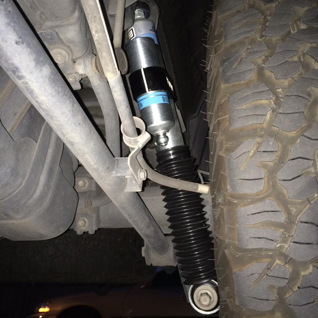

Bill,
Look at the following photos, the remote reservoir and the shock body on the 5160 are the same dia. If you want to wait until your 5160's arrive you will get in your box a frame mount, albeit different that the clamp used on the pro, you can determine if it will fit your needs.
It consist of a stainless worm gear clamp, frame mount and necessary hardware. (Attaches where the red arrows are on the top photo)
Personally, I don't think the shock will rotate, and the billet clamp does fit very secure to both shock body and reservoir (see second photo)
But with a Bridgeport and the reservoir in hand.... well, you can make that happen!!!
