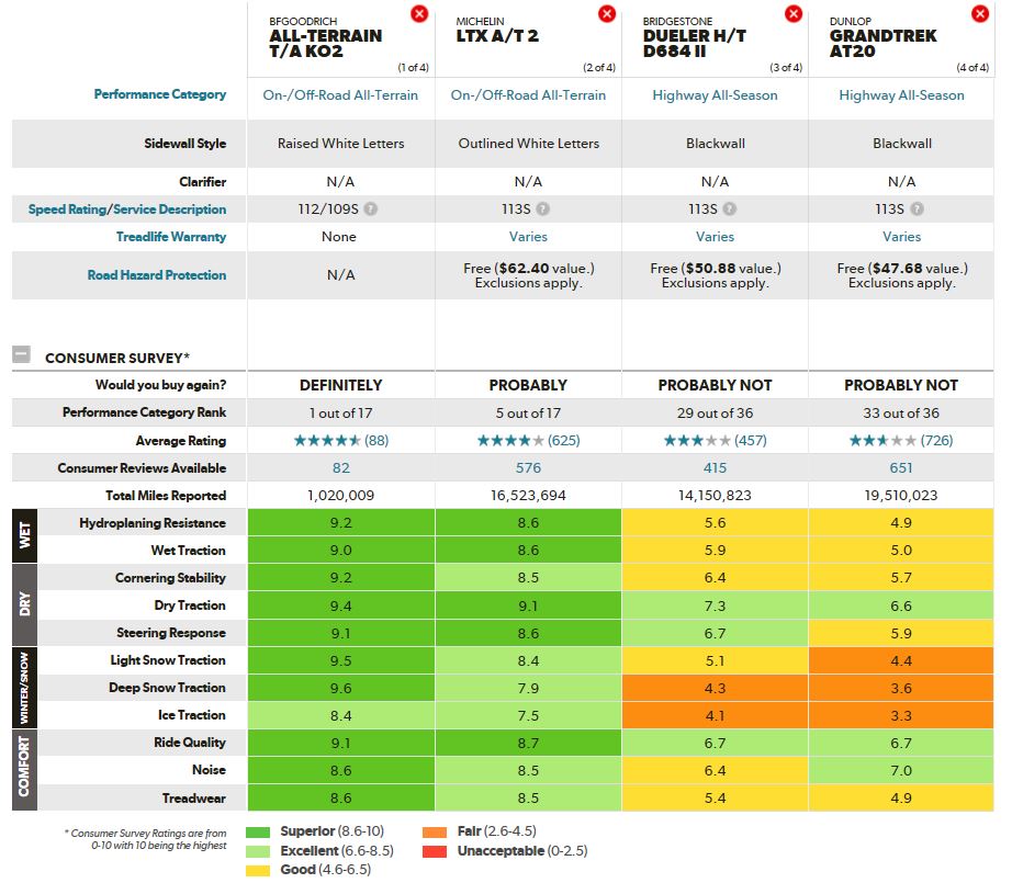

Actually the main factor I picked BFG over Michelin was opinion in many reviews on-line and tire comparison chart on tirerack.com - I was seriously going for Defender LTX, (M/S category, same price), but I decided on KO2 based on the snow and ice traction. I cant confirm that yet, but I can confirm that the quality of ride is as good as in Michelin.
As for the look, it was never priority for me. Unlike many car buyers I never cared about the paint or interior color deciding on cars ("Q: What brand of car did you ended buying? A: A red one."). The first thing I do inspecting the potential buy is crawling between tires and diving under and hood. If I don't like what I see, I never bother opening the door.
