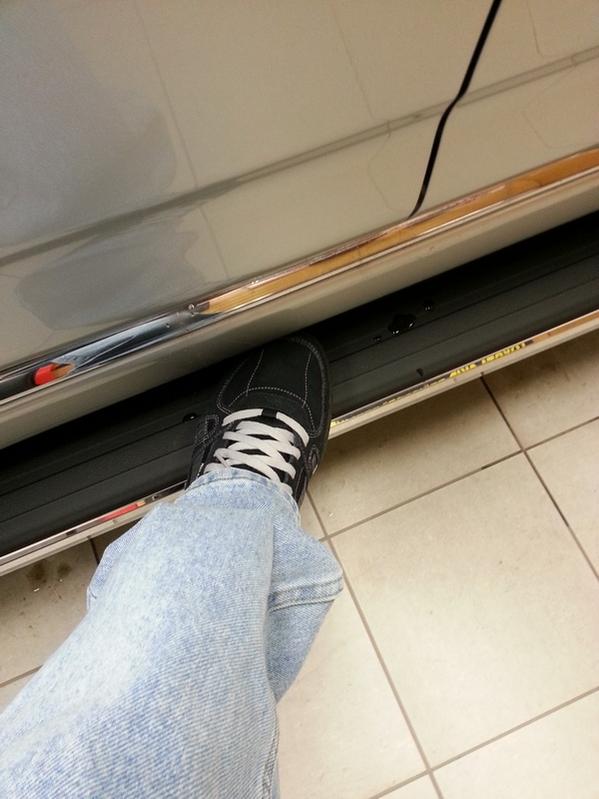

for those looking to get the LE with the rounded black corners running boards with chrome strip, be advised that the width of the board is not sufficient. the rocker panel impedes placement compare to the TE and SR5 where there is a gap that would let you snuggle your foot in for an extra 1-2 inches.
at this point the running boards are more cosmetic than functional in my opinion. the Warden has already slipped her foot off trying to get in the other night.
example attached.
