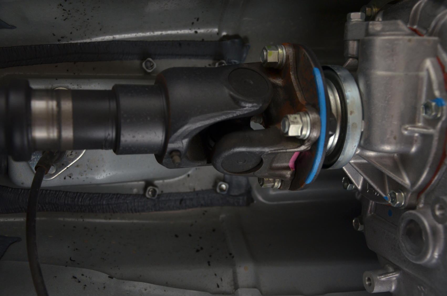

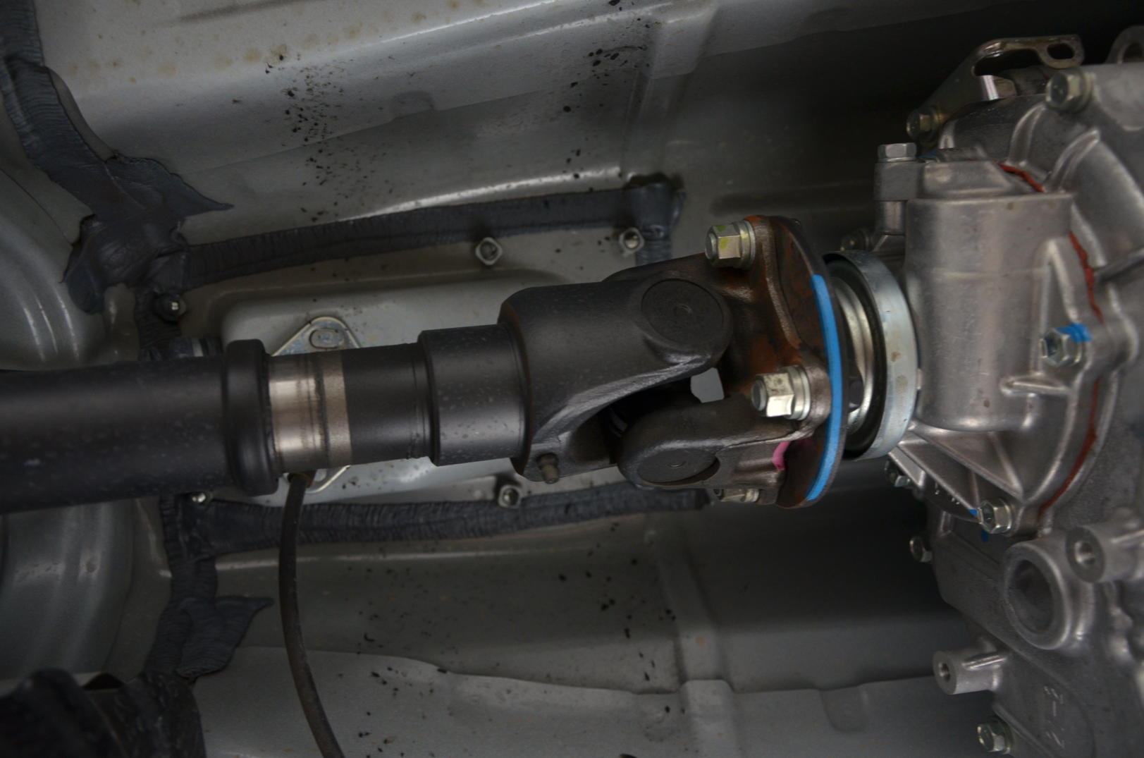

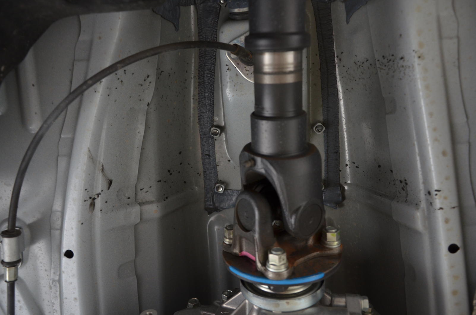

Driveshaft leaking grease
Here is a real problem....
I have a 2014 TE with a Boss lift kit and I just hit 10000 miles and I been noticing grease dots on the body, at first I thought that it was the CV boots but when I when under the truck I couldn't find anything on the boots after further inspection I found that the driveshaft was flinging grease all over the undercarriage of the car.
I looked over the forum and I guess this is a common problem on 4runners but what causes this? Is it the lift? or just bad luck.
I will post this on the Boss Lift kit thread as well to see if I get any feedback from them.

Did you recently lube it or take it in for service? First thought would be that it's just expelling extra grease from a recent lubing or something. I'd wipe it off and see if it continues...
At 10k it's due for a lube job if you haven't anyway :)
I wouldn't call that little amount of grease a problem or issue. It is normal. The driveshafts spin at high speed. High speed and the range of movement causes some grease to get pushed past the seals and flung on the body or ground. This is another reason why you should grease the driveshafts at least every 10k or sooner if you drive in a lot of water or offroad.
Leaking grease from the driveshaft? Lol all that means is somebody put too much grease in and it's getting rid of the excess by flinging it out. Either that or somebody was messy when they did the job.
Exactly, what's the big deal? I've got a bunch of grease on the bottom of my '03. So what?
Yes I had just taken the truck for the 10k service, so that probably was the grease from the service, I just never seen this before. Thanks for the help.
