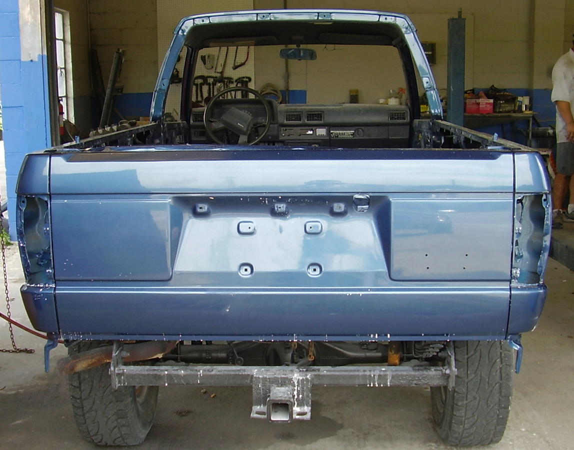

The windshield is out now making it the last piece of glass to be removed from the truck. Before the new body panels are installed they are painted on the back side and jam so that the color is consistent throughout the truck. The doors are completely gutted so that the door cavities can be painted as well.

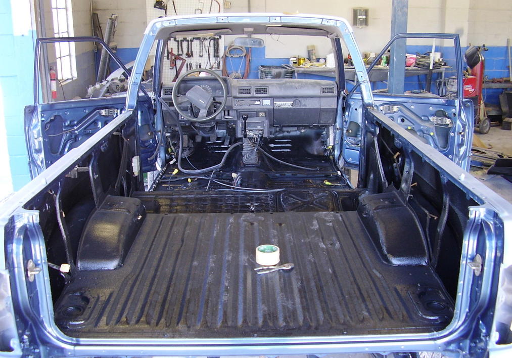

The truck has been jamed with color and the entire inside has a new spray in bed liner. I will install all the original vinyl flooring back into the truck, the bed liner is to keep things a little more clean.

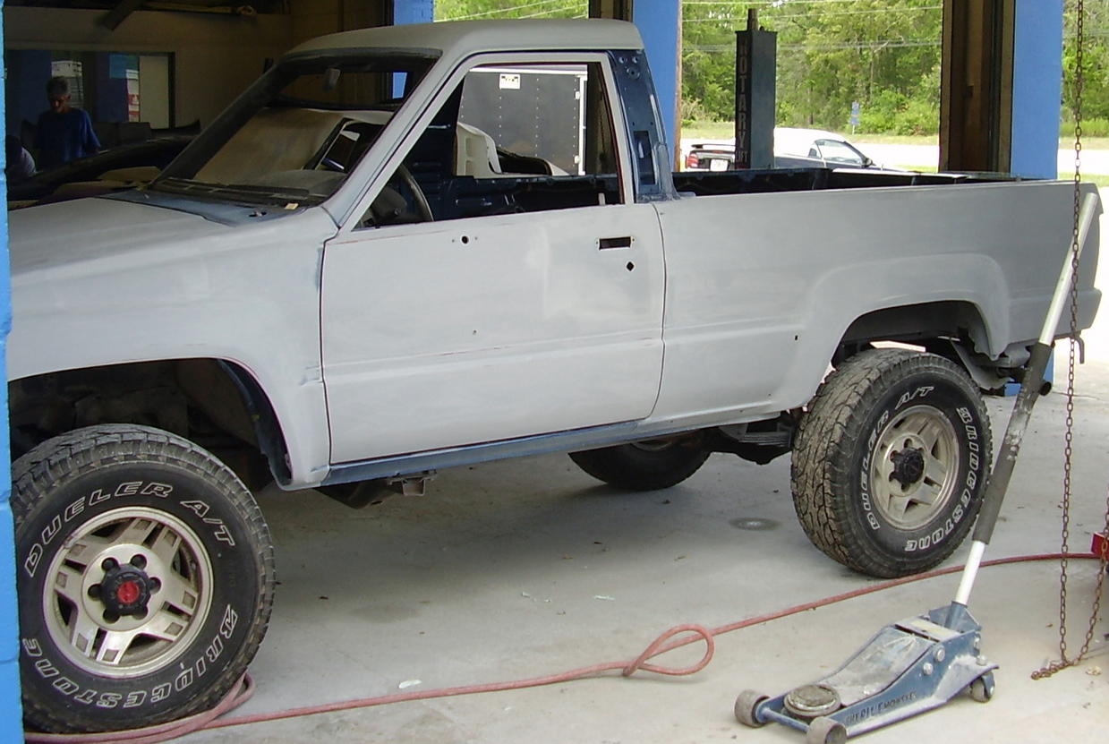

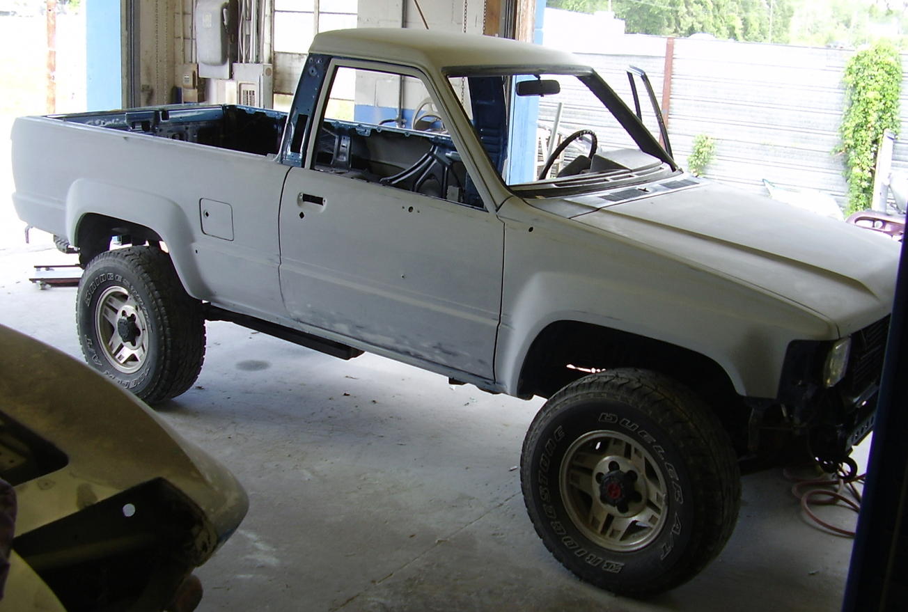

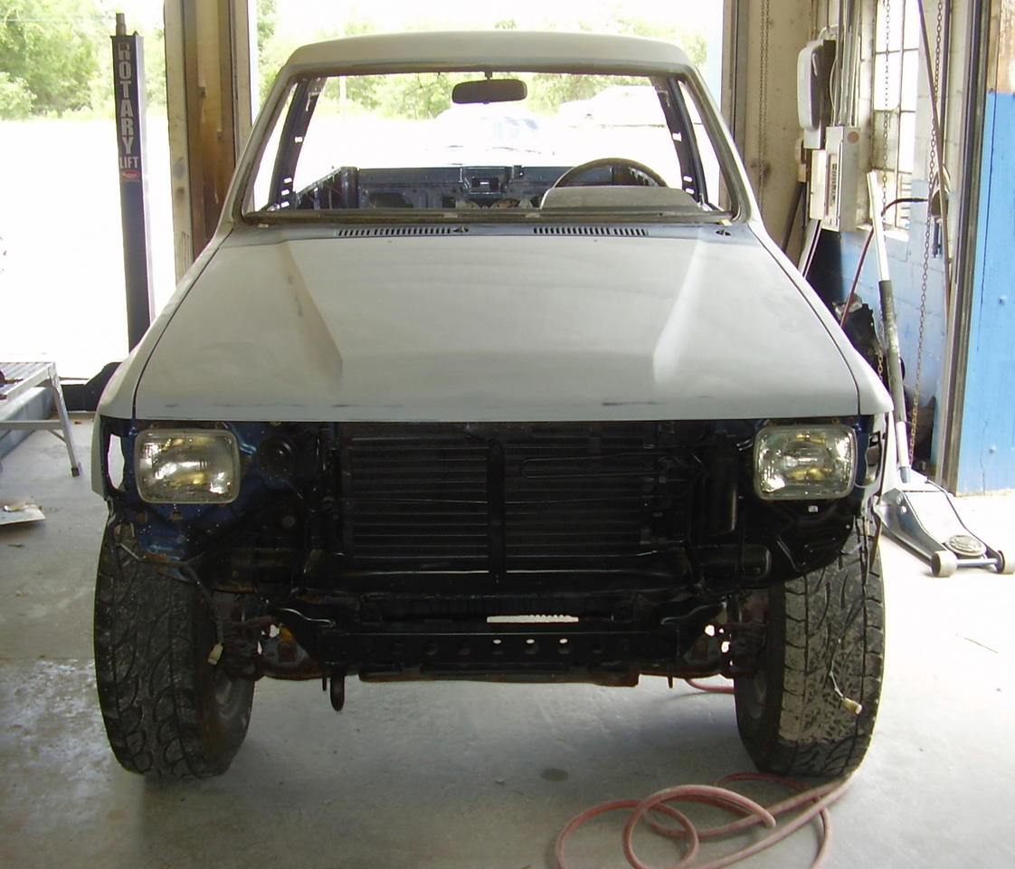

The truck is all in primer now and ready to paint :D

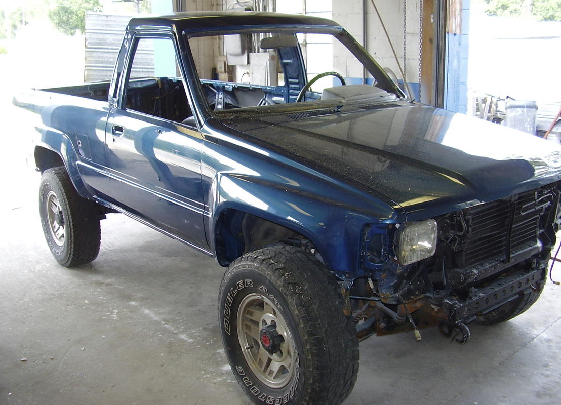

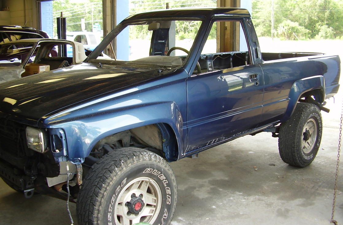

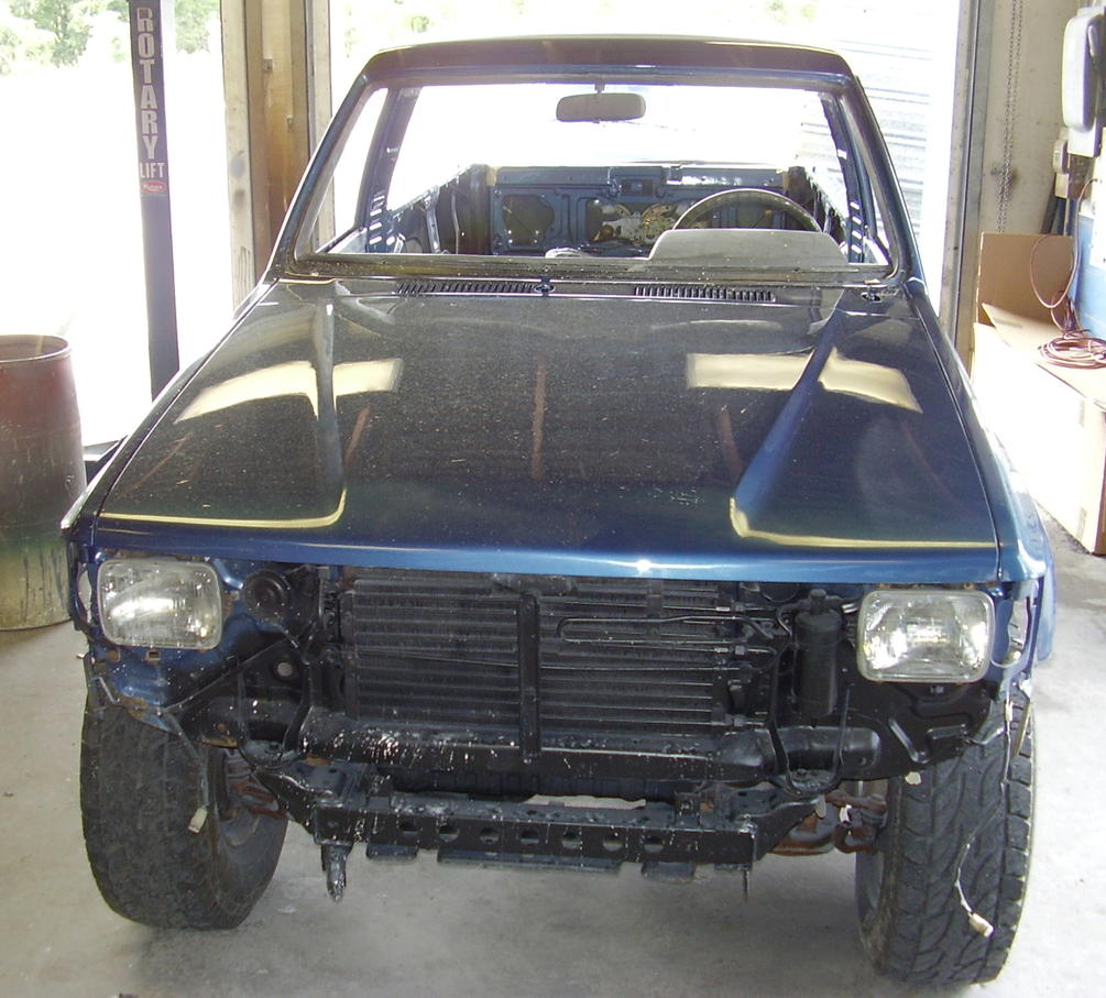

We have color:bluejump:
we did do a fast glaze on the truck and in a few weeks do another.
