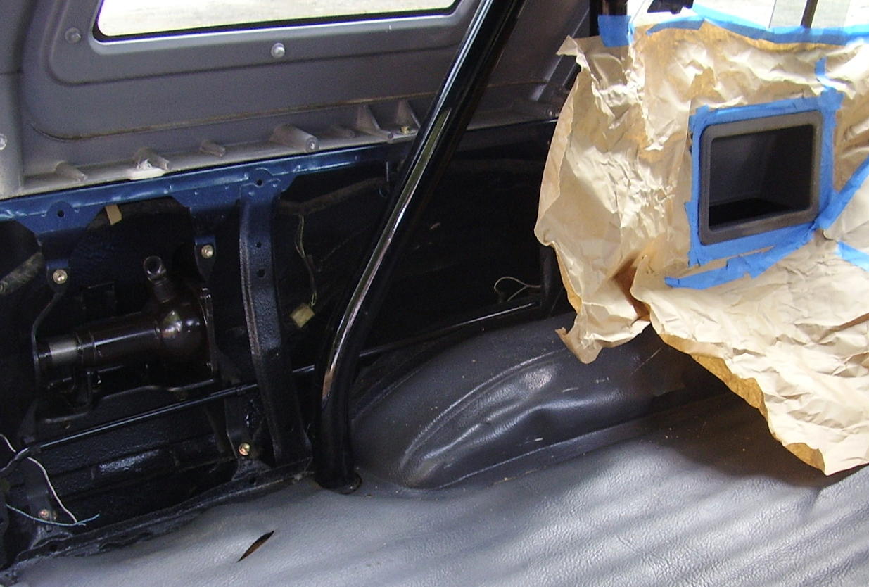

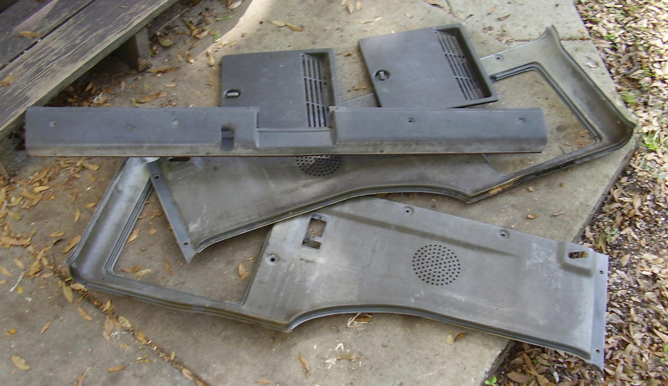

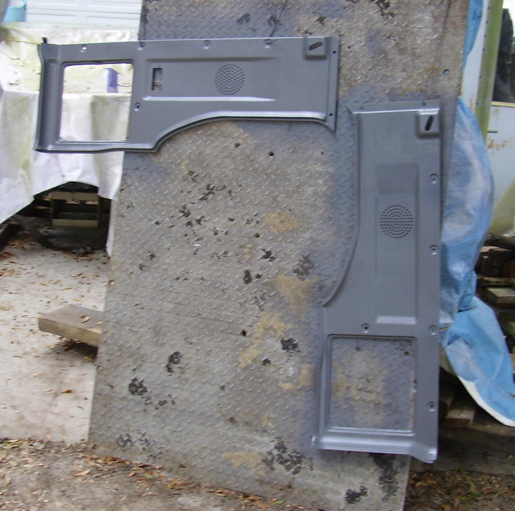

I have been doing some interior work on the truck, refinishing all the plastic panels and such. I am going with SR5 cloth seats with vinyl flooring.
I am redoing the rear speakers at this time too, I will have some more pics tomorrow of the work:)

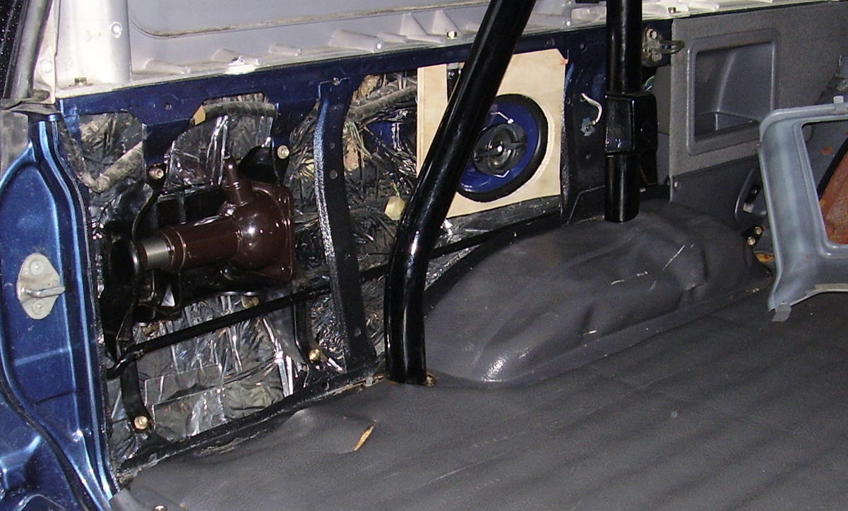

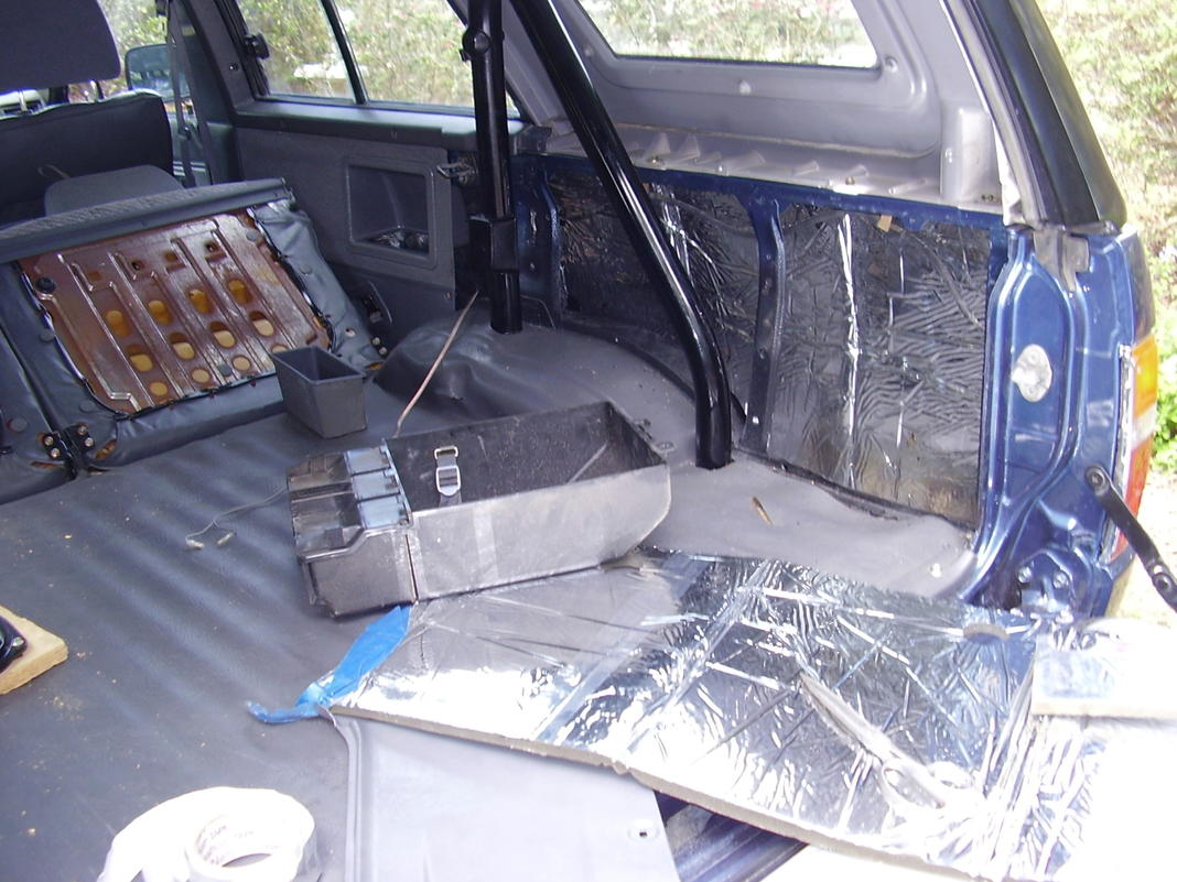

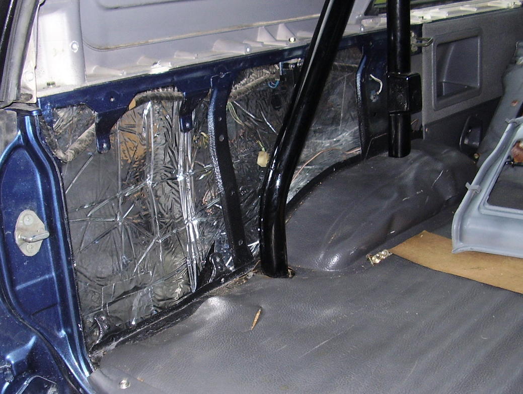

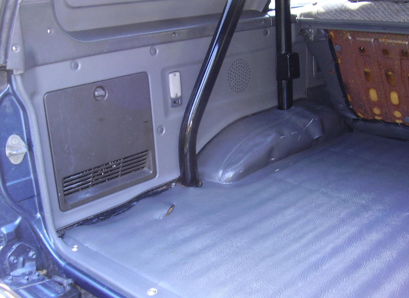

I finished the back right side of the truck today, here is some info and a few pics of the work....

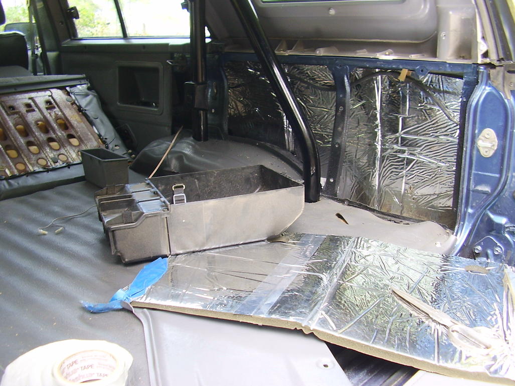

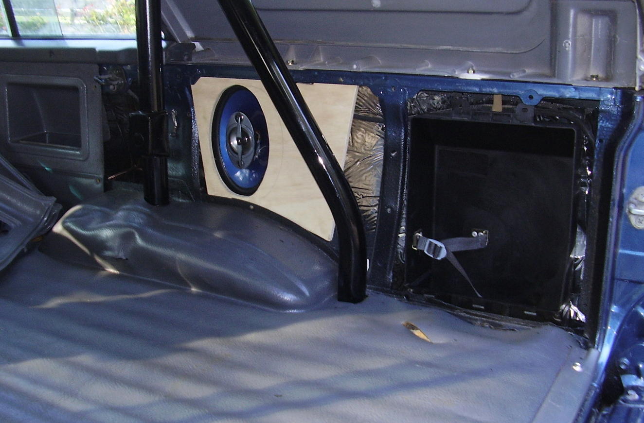

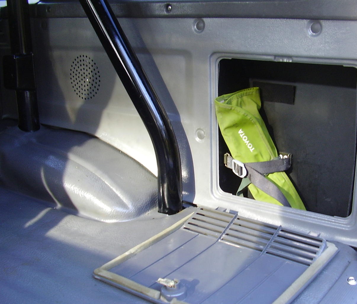

I went to the junk yard this morning and salvaged two 2nd Gen plastic stow compartments. My 88 did not have any and I do not think the 4Runner came with them until the 1990s. I wanted a clean dry place to stow away the factory tool kit and other small items this is why I retro fitted the 2nd Gen plastic compartments.
If you have been fallowing this thread you know I had a spray in bed liner sprayed throughout the entire inside of the truck before putting back in the interior. I did this to keep things clean, less susceptible to rust, and also as a sound dampening.
I added some more sound dampening using a light weight, Mylar faced & backed, high density foam product inside the bed sides. Once all that was installed I made a new speaker mount for the right side 6x9 Pioneer speaker.
After fitting the speaker into place I reinstalled the newly painted factory panel and trim using all stainless steel fastners....here are all the pics.

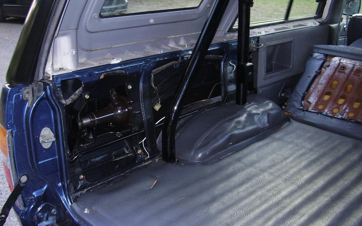

Tomorrow I will do the left side pretty much the same way as the right. I already restored all the original jack and tire removal tools and put them back in place. I have to remove them to insolate with the Mylar foam. The speaker mount will be a bit more challenging on this side because the tire falls steel crank rod rests across the wheel housing.

The first Gens have the jack and tire fall steel rod stowed in the left rear near the tail light (see my last pic) the jack tool kit is stowed on the right side.
Impressive! A few questions if I may:
1) Did that cargo doofer just bolt right in or did you do a lot of modification? how much did you pay for it? (Prices up here are wicked high)
2) Where did you get the sound deadener? Is it from a music store or constuction place

They install very easy into a first Gen. I will take a nice pic of the part it's self showing how it installs. Since I put in the insulation I had to trim them a bit.
I paid only $5 for them but, I also have a very good relationship with my local salvage yard. You could expect to pay in the $20 or more range for them.
The stuff came from a company that sound proofs and insolates the sleeper cabs of large over the road semi trucks.
The stuff weighs nothing but, works great. It is also used as a thermal insulation.
I had the stuff leftover from when I did my S2000 with it. I did not pay anything for it, everything I got from the installers was cut offs and thrown away.

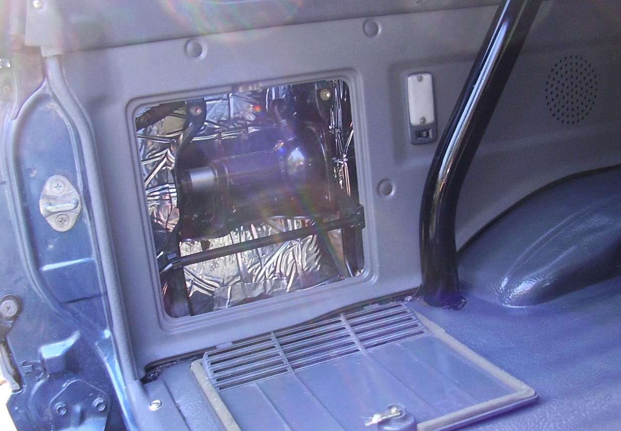

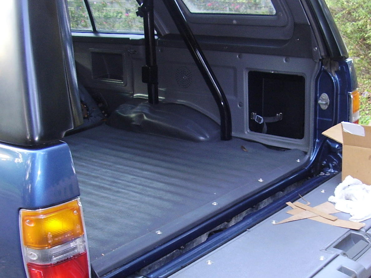

I finished off the left side speaker install today, here are a few pics. The steel rod for the tire fall fits fine now with this speaker mount.
I will have some finish pics of the back as soon as I install the carpet backs of the rear seats:)

I used a set of middle of the road Pioneer 6X9 quad axle speakers in the rear of the truck. The factory openings are only 5" round so, what I did was to be sure that the 2 tweeters and mid range speakers were right at the factory speaker opening. The tweeters are 1" each and the midrange is 2 1/4" The 6X9 speaker is set 1" back away from the opening so there is plenty of air space for the woofer to push sound without obstruction. The speakers have a nice rich sound and the bass response with all the insulation behind the speakers is very good.
Up front is a set of 4” Memphis Audio components with a pretty large cross over. These speakers are in the moderate to high end class range of speakers. I used these up front because I wanted something that would perform well at only a 4” size.
I am still using the Sony Xplode head unit that came with the truck, it works well and I am surprised on how nice the sound is.

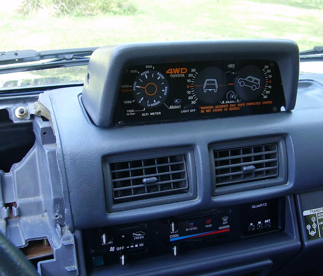

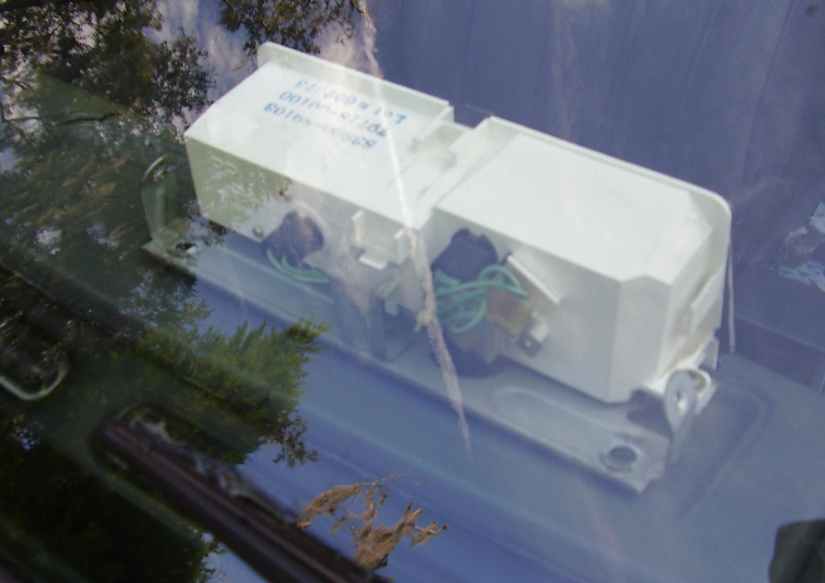

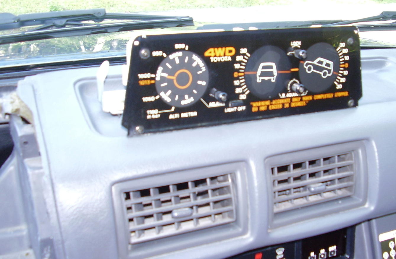

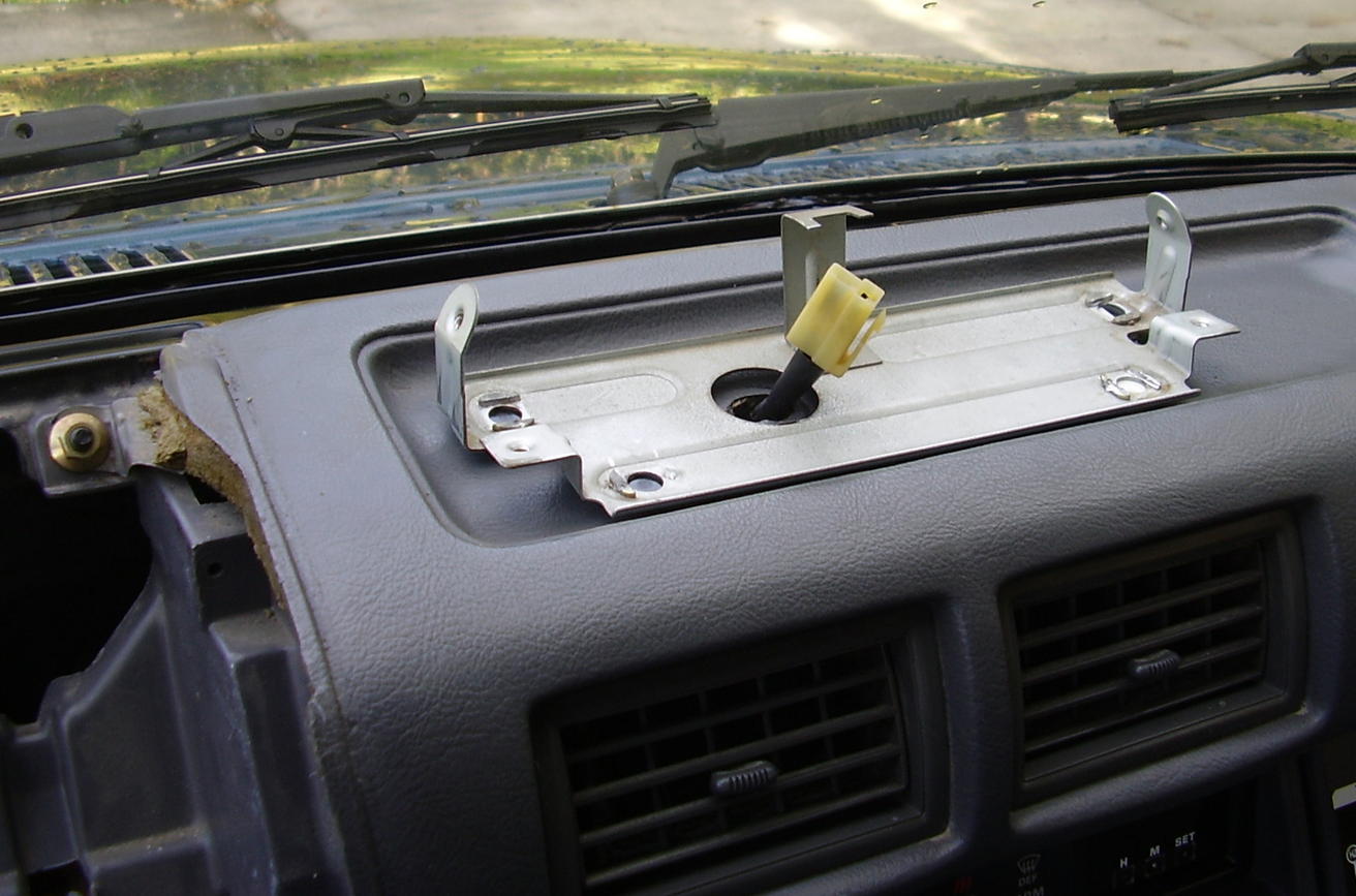

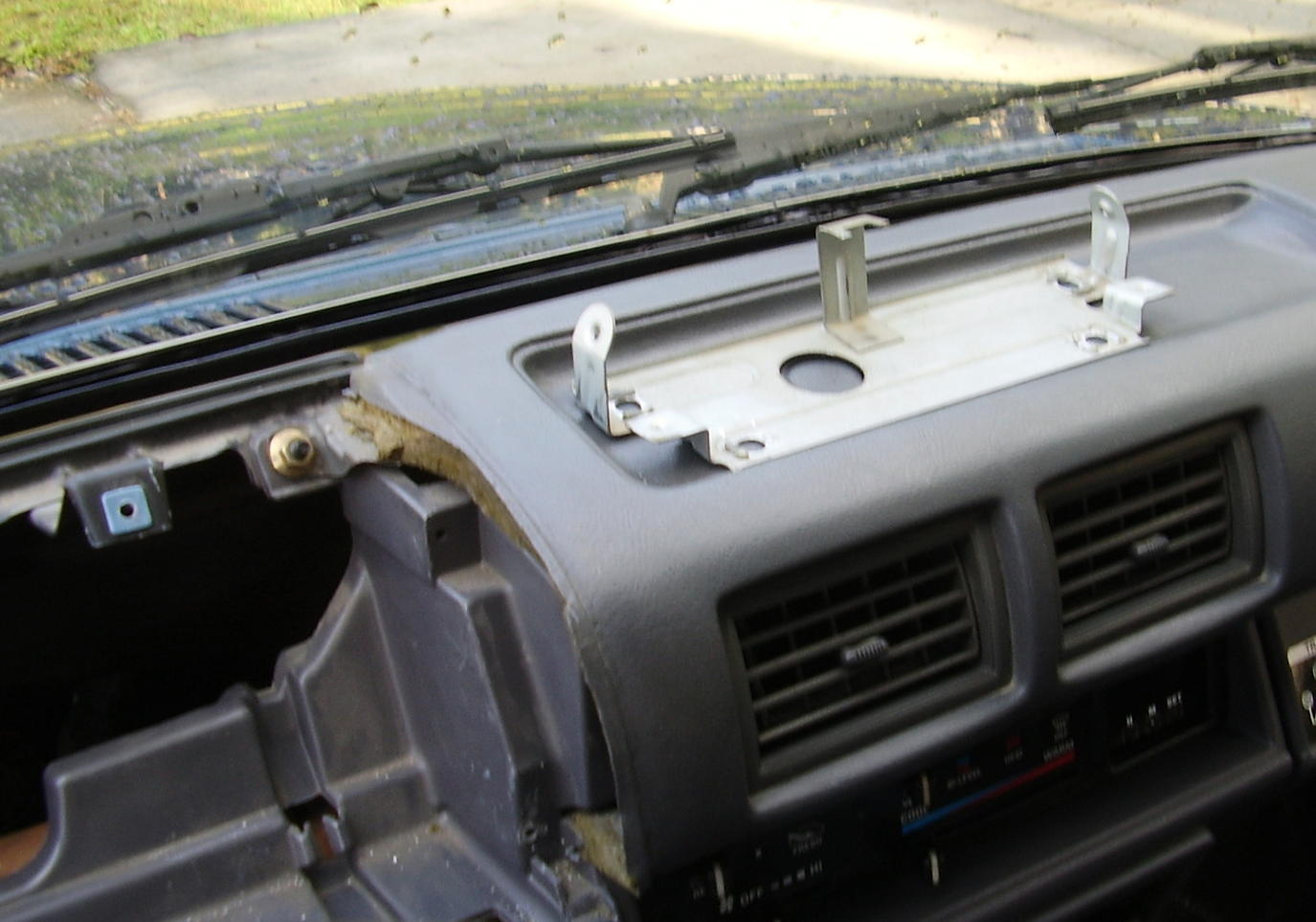

I installed the tilt gauge yesterday using an unorthodox method….Industrial Velcro LOL
I just did not feel good about removing a 21 year old dash pad that was already in fragile condition.
I used a high speed die grinder to cut the welds on the mounting studs then, removed them. I placed the mounting bracket on the dash then marked off the place I thought it should be then, drilled a hole for the wire.
The setup looks good and seems to be securely mounted. I may move it back about an 1/8 inch, I think that would make it perfect…..
