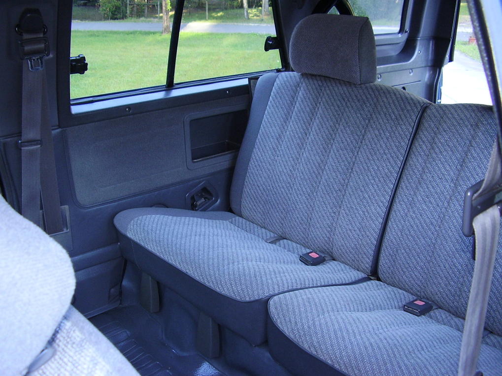

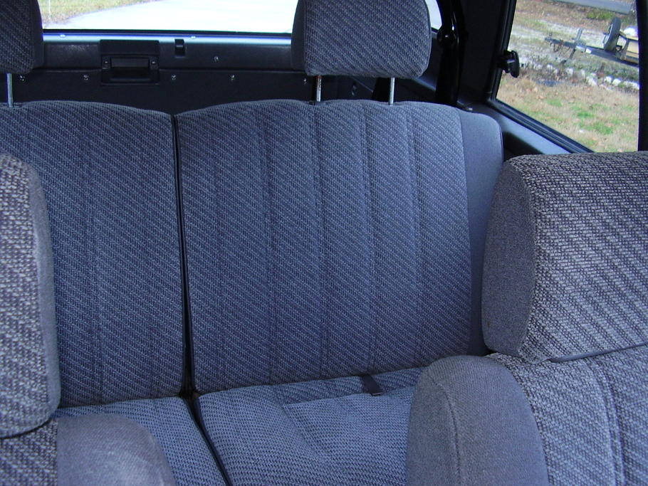

seat drama

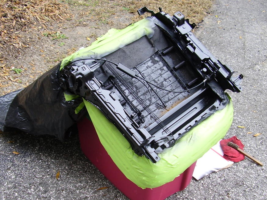

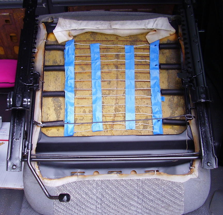

One thing that has proven to be the most difficult part of my restore has been the front seats. I have a mint set of SR5 rears and have been trying to get a match set for the front. I have spent a lot of time and energy on trying to find that perfect set of SR5 fronts but have been unsuccessful. I did find a pretty nasty drivers seat in Tampa for $30 bucks that was usable/repairable.
After about an hour with a pressure washer cleaning the seat and a week for it to dry, I disassembled the seat. I media blasted the frame and painted everything I also rebuilt the seat spring using stainless steel spring wire. I retied the spring with jute twine and used painters tape to wrap the ties.
I took the seat to an upholstery shop to have the seat reassembled and some needed foam work done. All in all the seat came out pretty good.

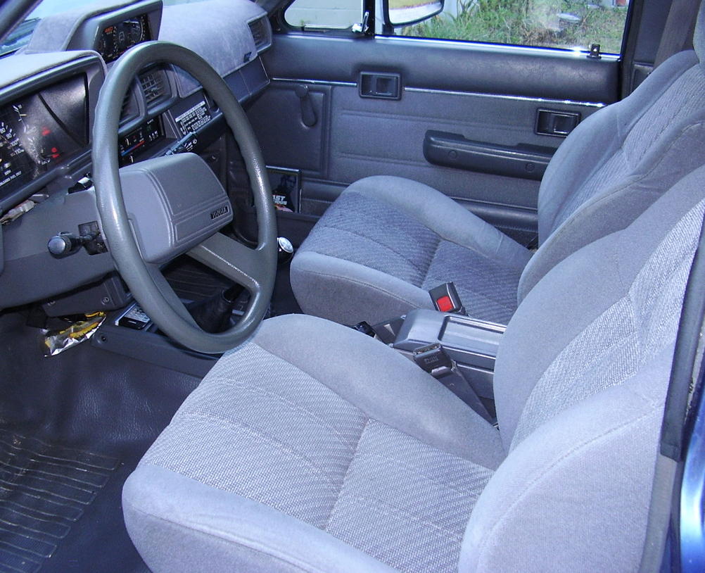

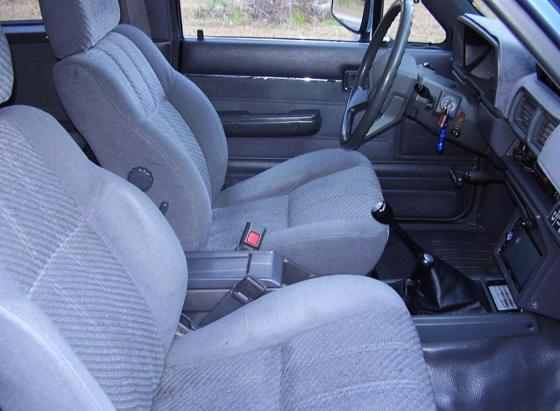

I bought a passenger seat off a fellow member here and had it shipped but when I put it next to my drivers seat it did not match, the seat was from an 87 and the pattern in the center seat material was not the same.
Well...it was back to Craig’s list and Ebay….Found a 1988 up for sale about 40miles from me on Craig’s list. After talking with the guy on the phone I made a deal to trade my passenger seat for his.
The truck was in a field and was in sad shape but it did have a matching seat to my drivers seat. The seat was nasty dirty but not torn or ripped so I took it!! along with a trade for the radio bezel and a trade for a front corner light. The radio bezel was pretty much mint and was un-cut and the corner light was also in great shape and was much better than my painted silver (to look like chrome) light. I left $75 bucks light and had a matching seat and a few needed parts to boot, great day!!
I pressure washed the newly found passenger seat the same as I did the drivers but with less than satisfactory results. The seat still looked dirty and there was damage to the fibers from a dog or something scratching in the seat. I let the seat dry a week and then did some repair work to the cable setup and painted the under side. I called Stanley Steamer a carpet and upholstery cleaning company to come out and steam clean all the seats in the truck. They did a great job and got the passenger seat as clean as it can be.
I’m not sure if I want to spend the money to re-foam the seat because of the fiber damage so I installed it as it is for now:)

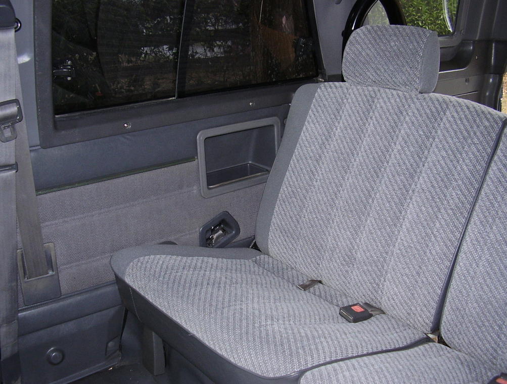

I sold my rear seat side panels (first pic) and installed my new rear seat side panels.
Both are SR5 panels but the first pic is the panels used in the rigs equipped with power windows. These panels will have a matching set of door panels with the molded power window/door lock switches.
The new panels I just installed are used with the SR5 trucks that have crank windows (like mine) and with power window (port option) that has just a box style add on power window option.
I striped the chrome finish off the trim that runs the length of the panels because it was badly peeling. I am going to re-chrome the trim using chrome pin stripe……stand by for pics

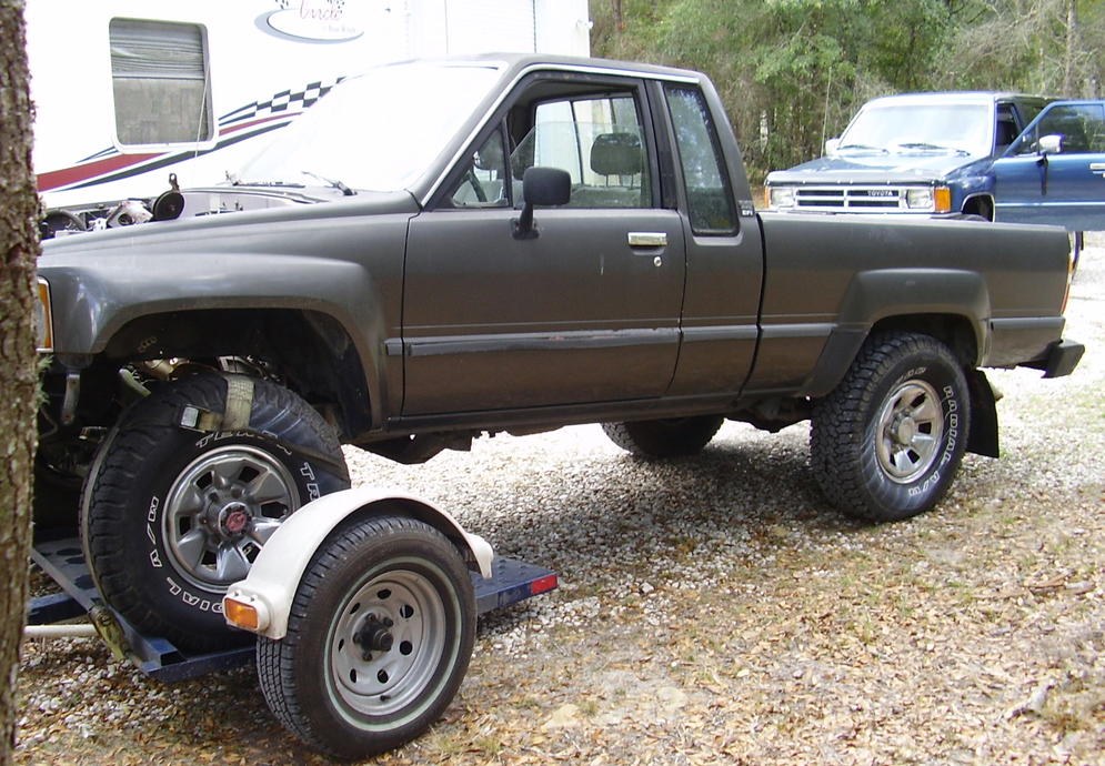

I'm working on a 1986 eXtra cab pickup truck now for my son. It is another big job I'm sure will be fun and look great when finished:)
