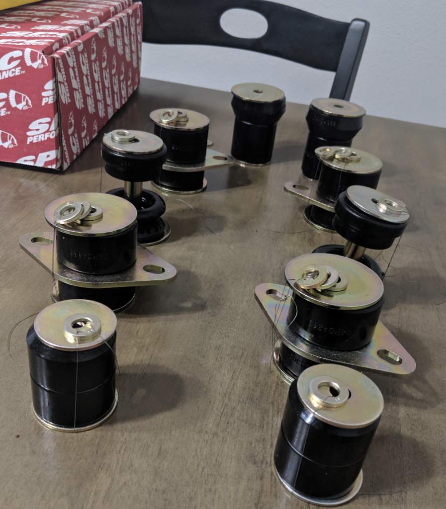

Plan is to remove the body lift first, install the energy suspension body mount bushings as the stock ones are shot, I managed to scoop up the OEM bolts,nuts washers for that too.

I put together my energy bushings and tied them together with fishing line so when I start removing the lift Friday night I don't have to screw around with sorting them lol the fishing line holds it together and the washer stack is what is considering the bottom.

I'm going to drop the energy suspension stuff on. I can not for the life of me get this damn brackets off spots 2 and 5. Either I'm rounding the top bolt off or it just won't come out. My 14mm slips and my 13 doesn't freaking fit.
