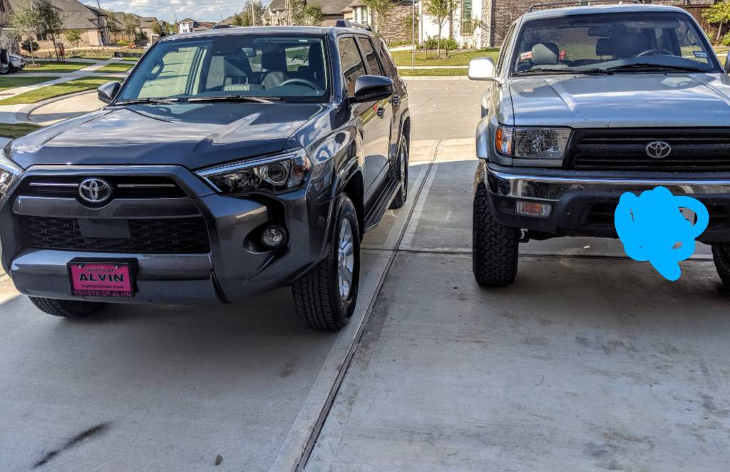

New addition to the family today. 2020 SR5 Premium with the 3rd row. 2x4. Got it for 37k

Yes but it's for my wife. And we wanted a third row. Although the third row isn't the most spacious, since it's fold flat it's a winner. We will have kids within the 2 years so wanted to get her something safe and reliable.
BUT those things come with way more miles and way higher prices for a used vehicle. I think a 2018 GX with around 36k miles was around that same price. She wanted it new. Happy wife happy life. Hell I traded my race car Miata in with track equipment for it loll
If it were for me, I'd buy another 3rd gen lol the next vehicle for her is going to be an LX.

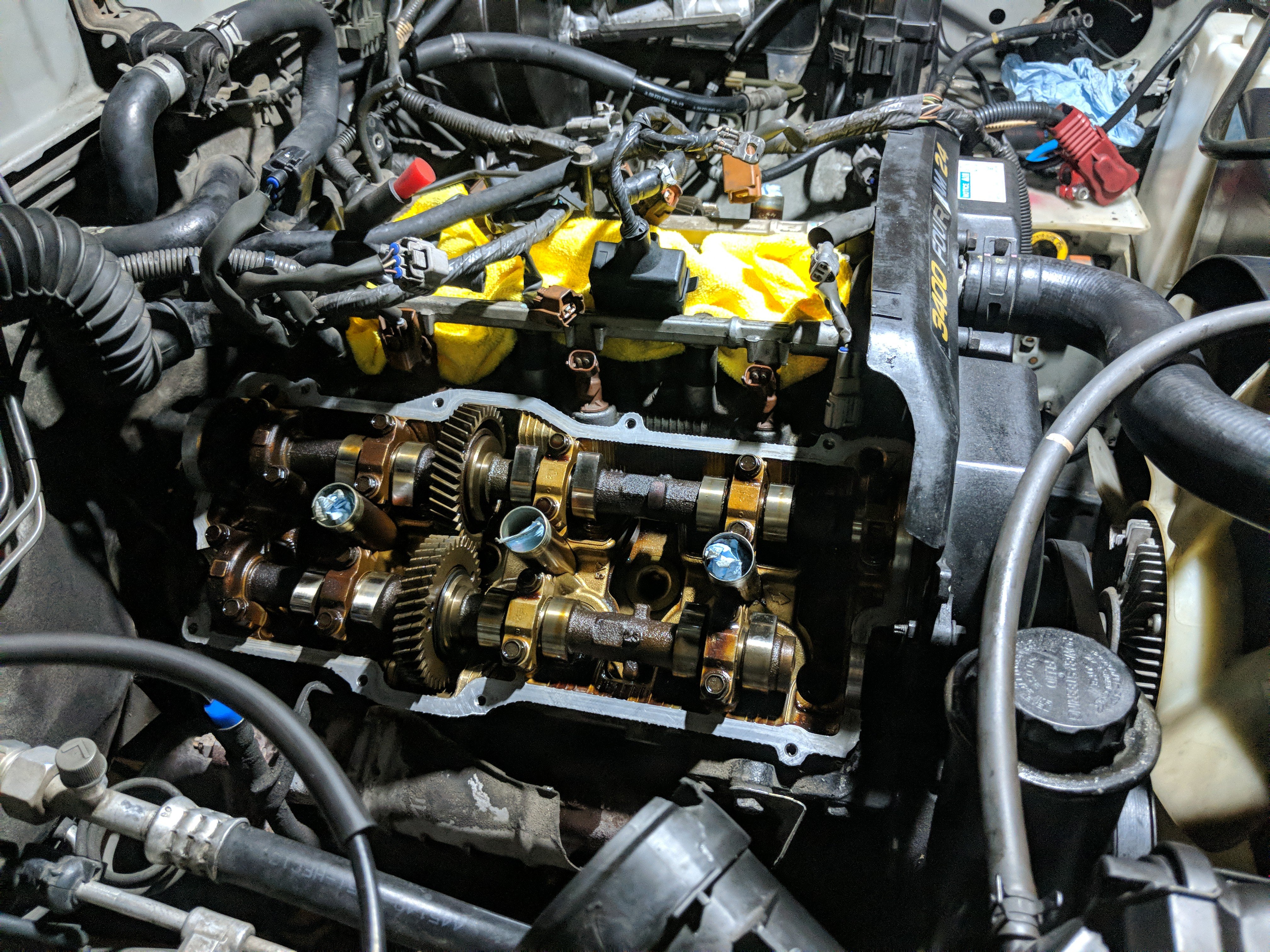

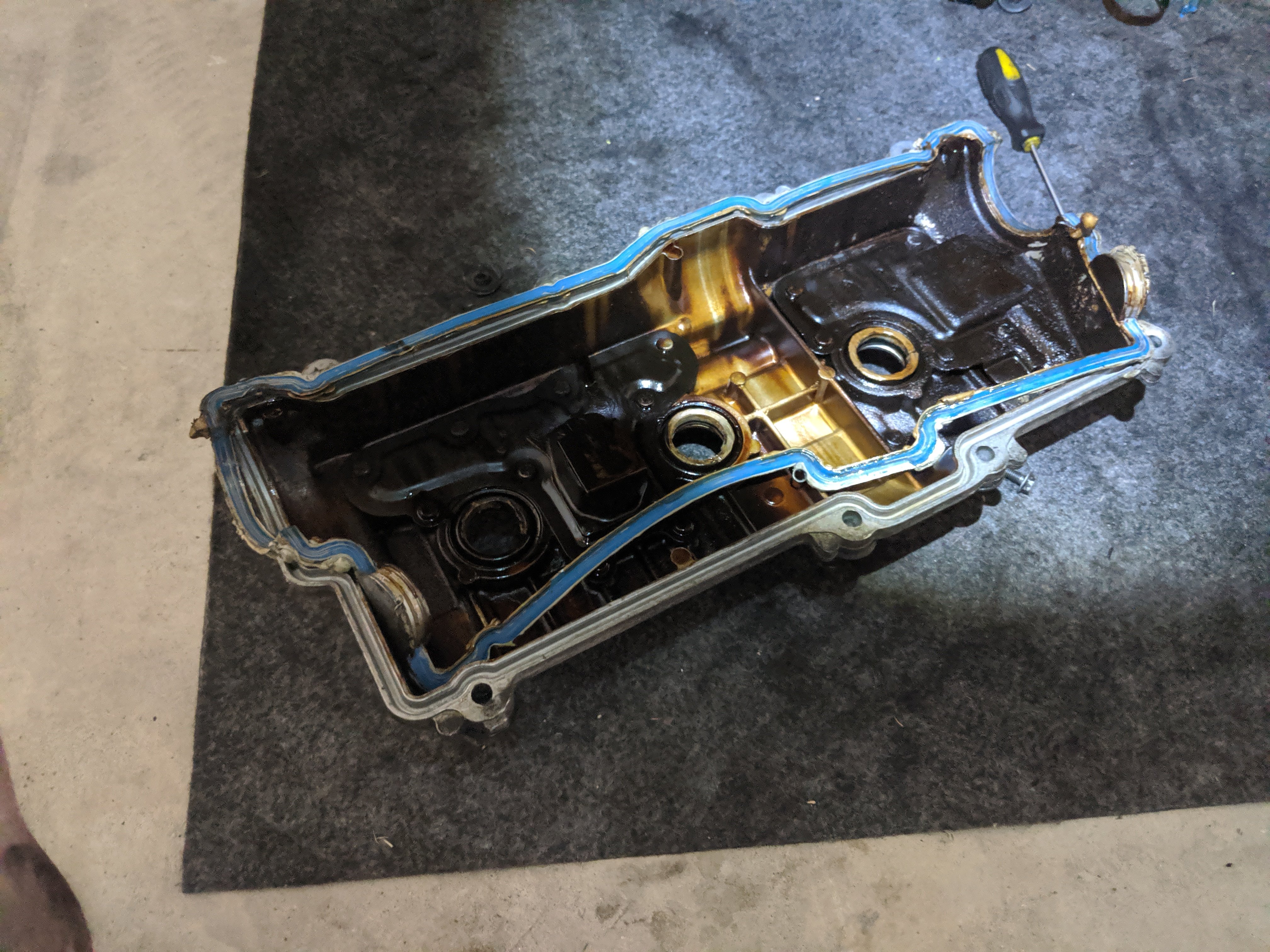

Well so far so good. The entire valve cover assembly was put together poorly.
Here is one way to remove the half moon plugs ...loll literally came out attached to the gasket.
On a more positive note the cams loook gorgeous. No lol sludge.
The valve covers were put together with some white sealer. Well, chunks of it were stuck near the half moon areas. I had to pick it out with a pick. It toook surgeon precision otherwise I would have chunks get into the oil passages then clog my pump then boom.
Luckily that's not gunnna happen. I tokkm my time.
Mating surfaces are clean gaskets tomorrow throw everything on and that will be it. I got to do this in 3 hours tomorrow. It's gunna be tight

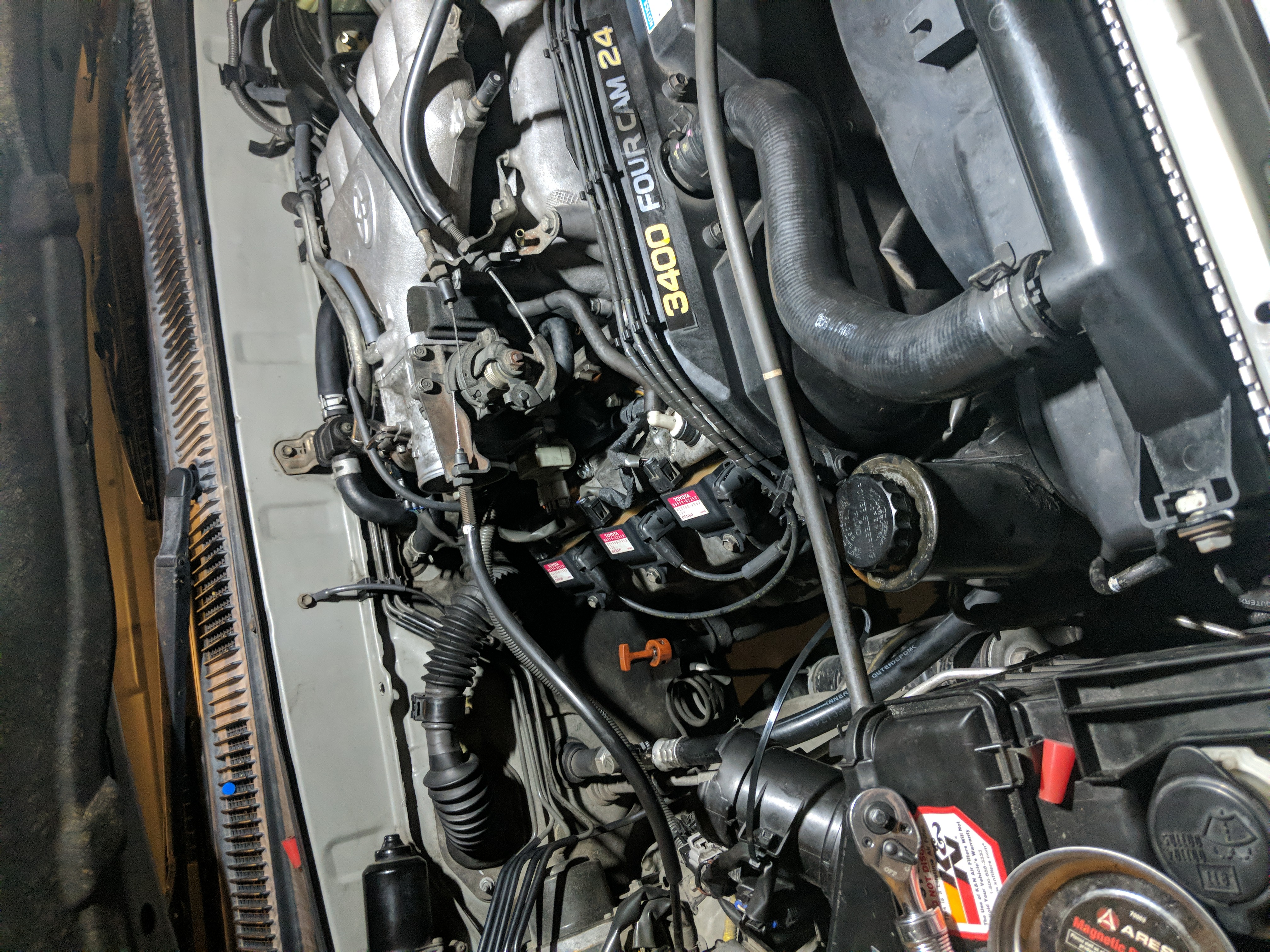

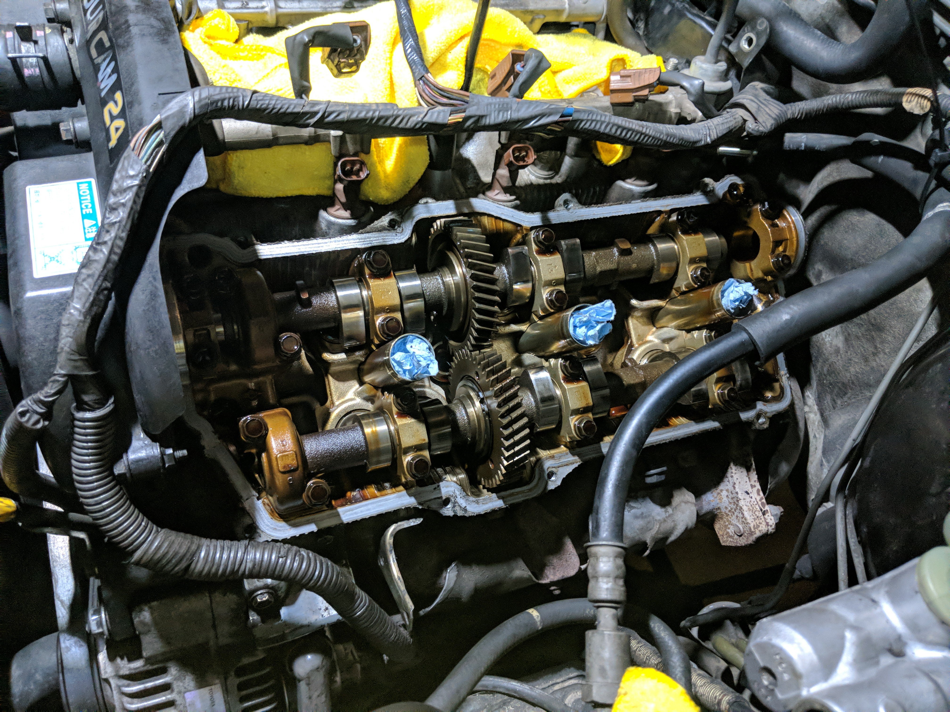

So close! I had four hours of wrench time today. I wanted to drive it back home. All I have left to do is the out the intake tube back on [emoji24]
Wife wants me to head straight home after work.
I wrapped the engine harness with some tesa tape too and mounted the harness with some AC clamp mounts from Napa. 1/2 would work best I had 1 inch and it was lose.
But overall it came out super clean. I got some M6x1.0 to bolt the back of the harness to the intake manifold it was missing originally.
And the fuel line that comes the charcoal canister was missing bolts to. That's all mounted now.
This job was definitely needed for this engine! Glad it's done.
Torque the valve covers took the longest. Quadrupled checked the values

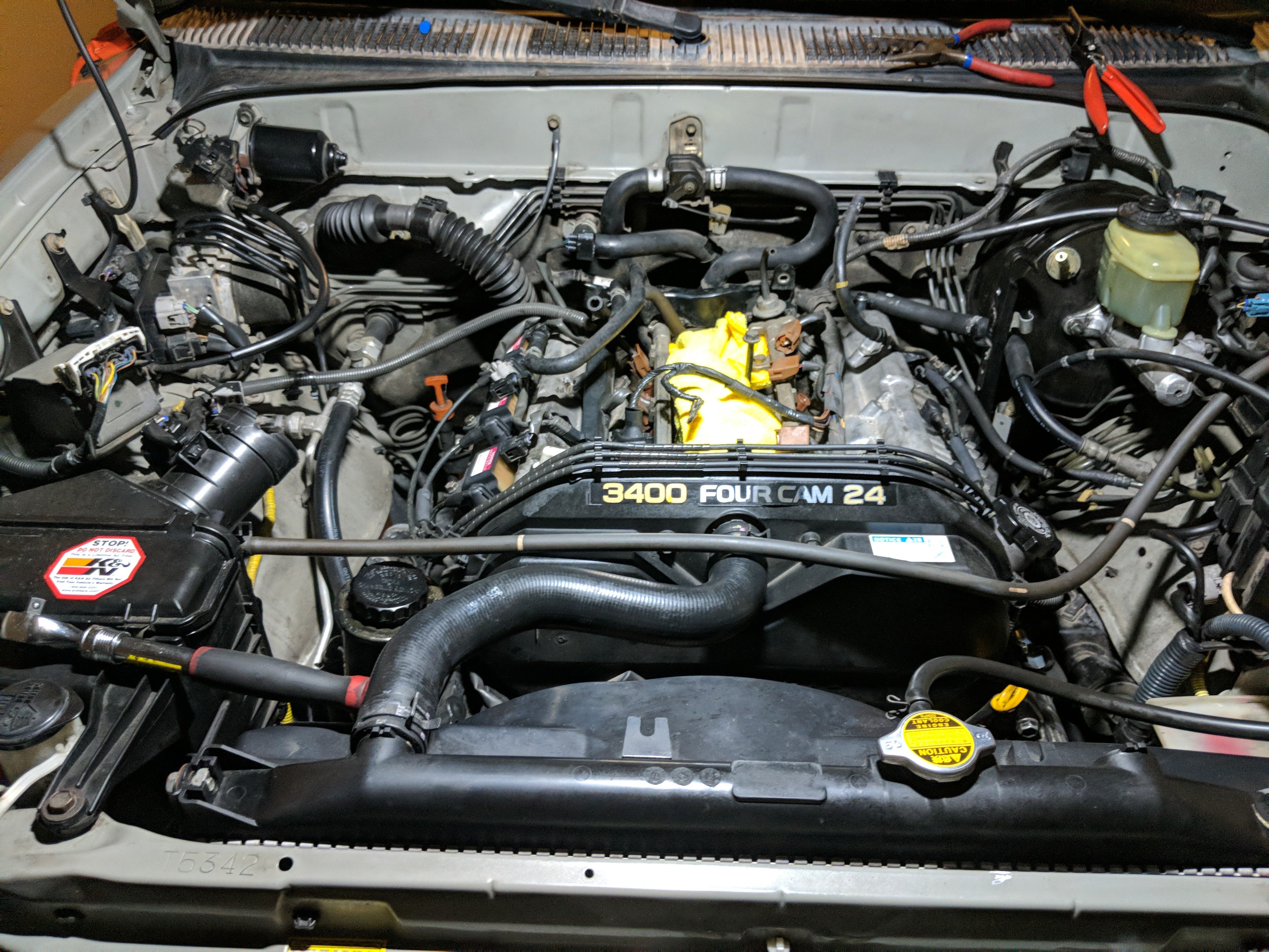

Well I was going to start my timing belt job today. Popped the radiator cap off.
Strong smellll of fuel. Opened up the coolant resivoir, and same thing.
I closed the hood shut the garage down and walked back inside.
Does anyone wanna have a party and watch me light this thing on fire? Lol
I won't be replacing the gasket on this engine which has obviously been beaten eight ways to Sunday. At a big Cross road here.

What area are in? Northern United states?
Your antifreeze smells like fuel???
It does not take much of a seep to stink up your engine compartment.
Check your fuel lines and injector rail. Could even be an injector leaking. ;)
Sent from my SM-J337V using Tapatalk
I am in Texas :(
It's definitely coming from the coolant.
I ended up draining the coolant out and sure as shit the coolant smelled heavily of fuel.
It's a dark brown/green color.
I did find out Toyota still makes made to order 5VZ-FE engines......dare I do it....lol
It's 10k I believe. 500 for shipping. 2-2.5 months build time.
