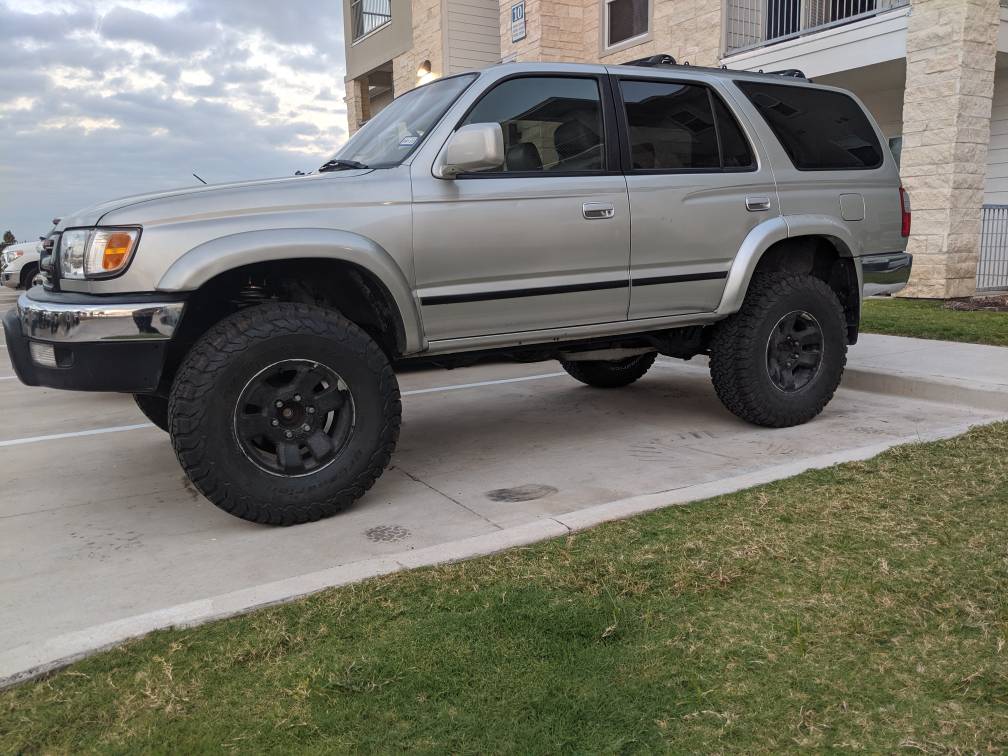

Here is how she sits now....it rides a million times better. But it def. is a bit interesting to drive it 70 mph, with a 30 mph cross wind. lol
I had no problems with my tires rubbing, I have 1.25" spacers on the front, I am very tempted to see if I can remove them and not have any problems.
I have a Sonoran adjustable pan hard bar coming, and that should hold the suspension over for a good while. I dropped the front sway bar, and bought new front sway bar links which are going to the rear end.
I am averaging 17 mpg's right now, and i got like in the above conditions for a 195 mile trip. Which is darn good when considering all things. and I figured out +20% LTFT is actually within spec for normal means.
enjoy the 1 picture lol I guess I have gotten her close to reputable status now, besides the missing front bumper flares.
and my 20 dollar junkyard skid plates :D

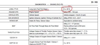

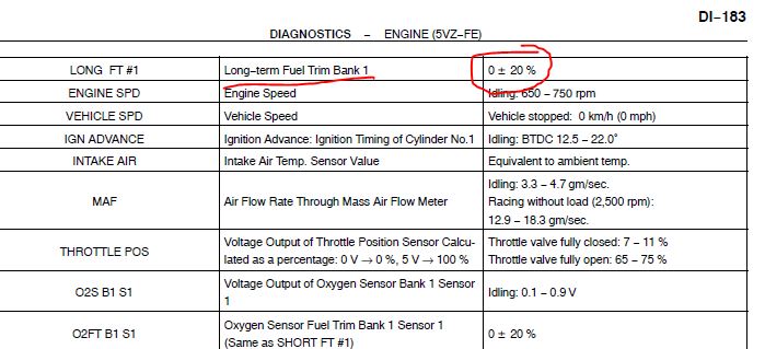

20% fuel trim is *not* normal. Mine are all less than +/-5% I bet you still have something up, whether it is a leaking vacuum line or a dirty/worn/broken sensor...
17mpg is fine for your truck setup, at least - especially if you haven't calculated the tire size change into that figure.
-Charlie
-Charlie
Its within spec. Its on the high side but within spec...and if it wasn't I would be throwing a code.
but i wont deny there may be some leak or sensor that is putting this on the higher side. I need to smoke it out.

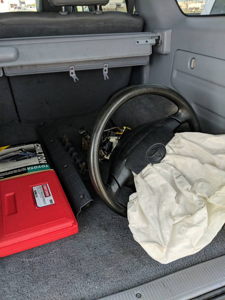

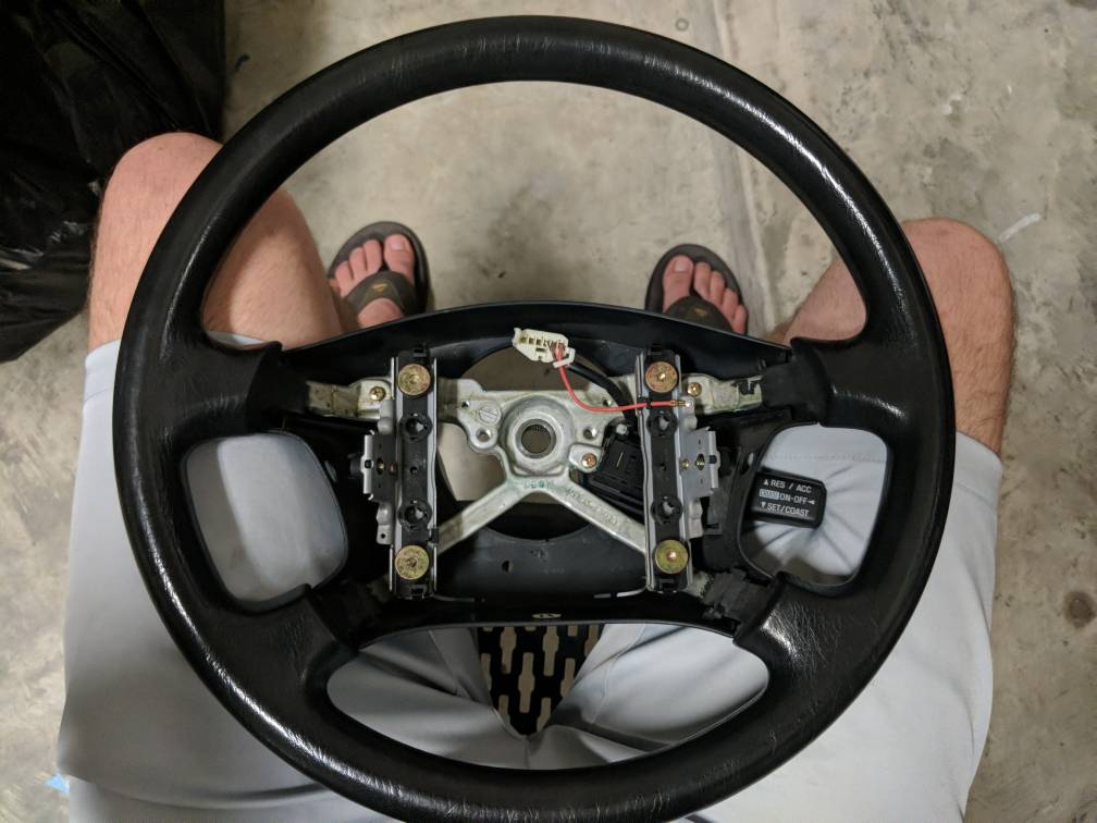

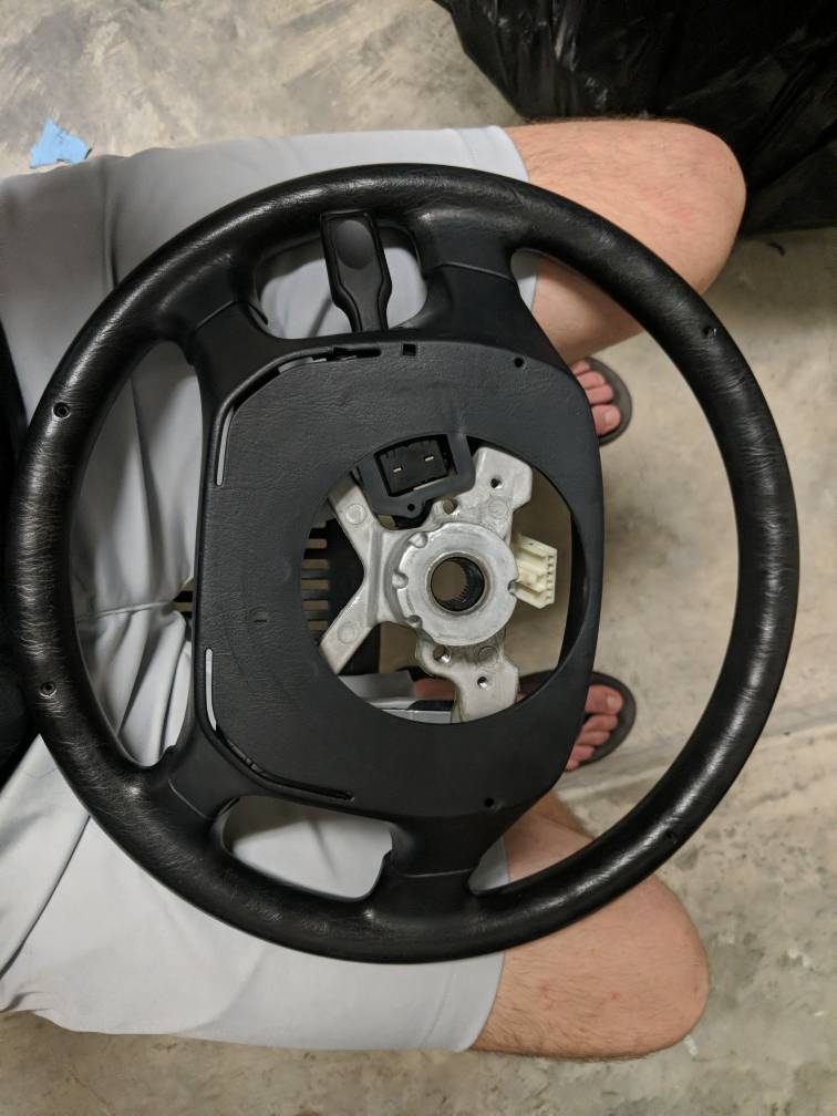

Wooo major score at the junkyard....I payed zero dollars for this puppy. A steering wheel in perfect condition. [emoji16]
Sent from my Pixel 2 XL using Tapatalk

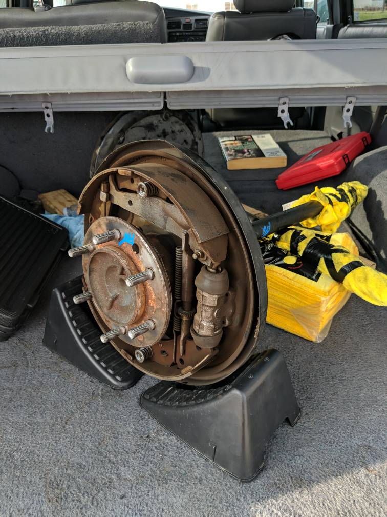

Scored some rear axles. 75 bucks. Junkyard FTW. Going to rebuild these on the side and swap them out in time with my current ones.

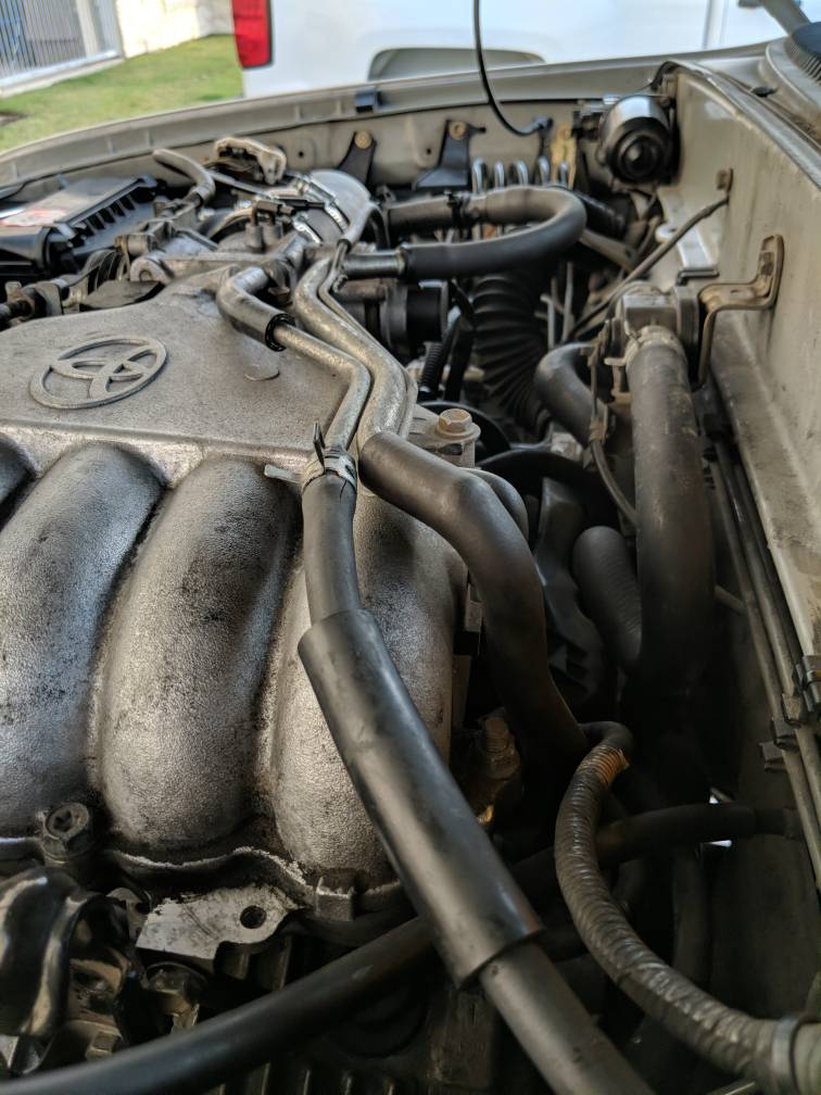

Found a cracked hose here, going to order a replacement for that one. I am hoping that is the source of this noise whenever I let off the throttle and weird 50 rpm subtle idle fluctuation
Be on the look out in the for sale section....might put this up for sale instead if there is interest. This thing is in top shape. But it's gunna cost ya....
I don't need a steering wheel right now so might as well take that money and put it to better use.

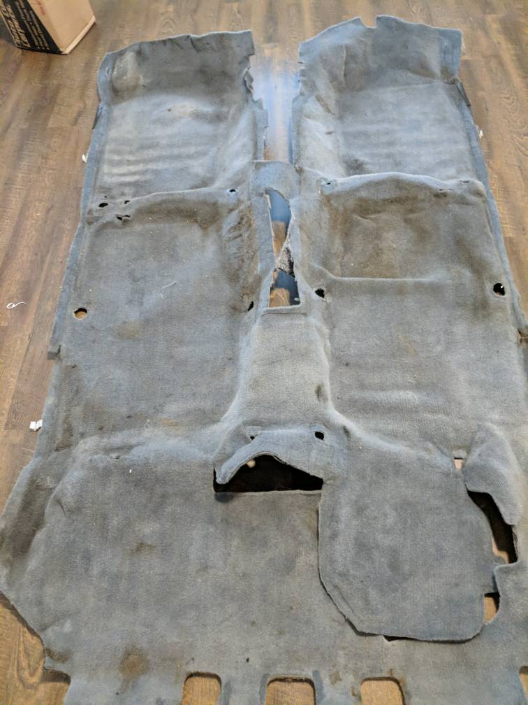

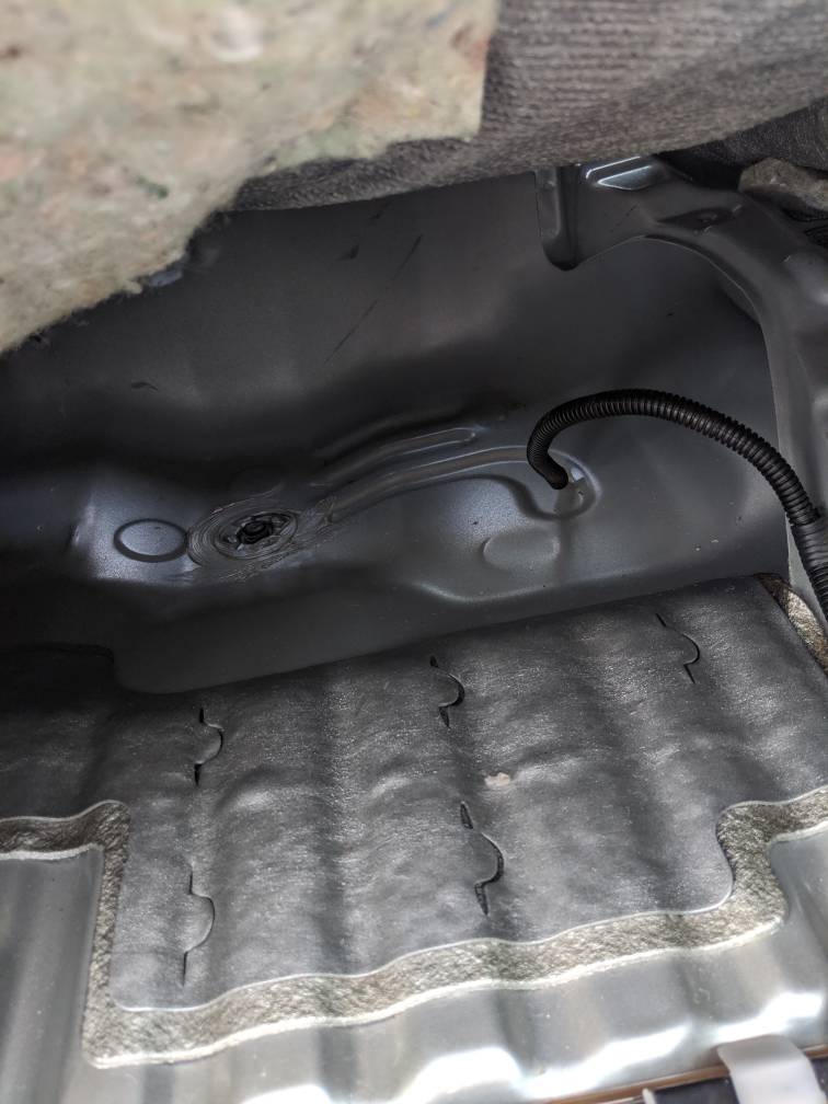

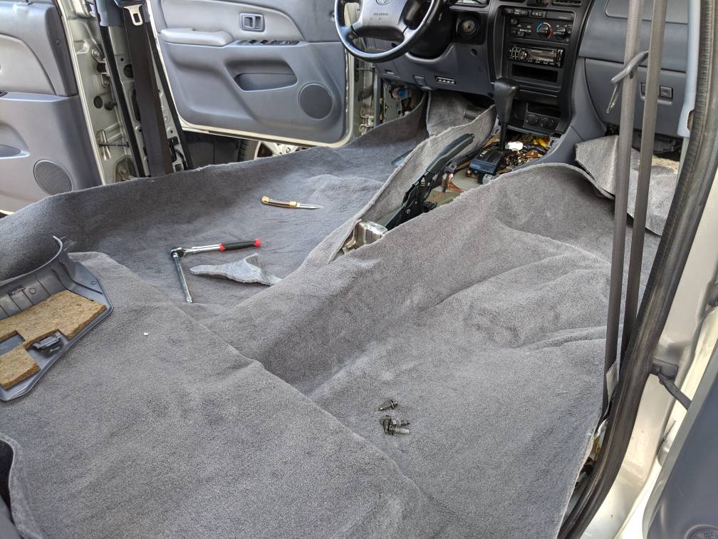

Starting to replace the carpet. I treated some surface rust spots with Chassis paint.
And for the freaking record, where no one has said anything about fitment, I don't have the rear heater option and this floor molding fits just fine.

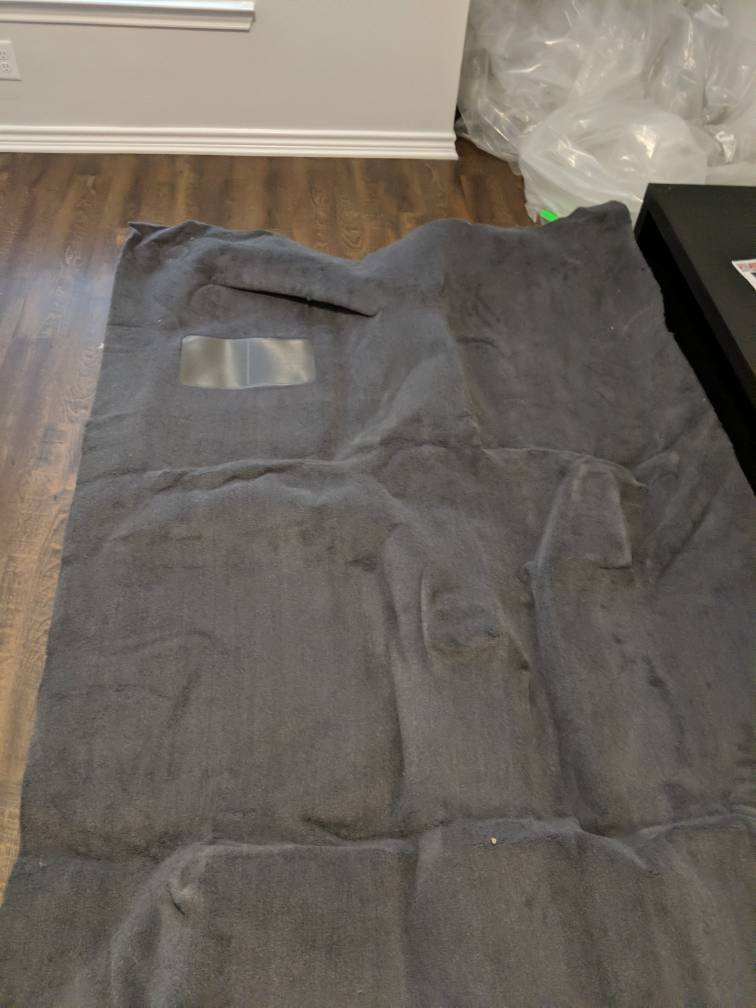

I started by making 1 big cut down the center. But just FYI, the carpet is kept together around the cup holder area.
I brought the carpet into the truck and got it relatively center from side to side.
My biggest piece of take away advice is to use the molding where the front seats as an effective "centerline". After you establish where that is at I cut the holes out there and held the carpet down with the seat bolts so the carpet will not move around.
Cut alittle at a time. Gunna get some sticky adhesive so it conforms better
Took me an hour to get new carpet in and to slowly trim the front passenger area, rear passenger area won't take any time at all

Rebuilding rear axles
Well I was starting to rebuild a set of rear axles as my passenger seal was leaking....
I got all my a parts and got the puller recommend by [MENTION=120071]mtbtim[/MENTION]. Got all the way to step one and came to a hault lol
I realized step 2 required the flanged nuts holding the axle shaft to the housing. So I stopped.to bad the puller doesn't use metric hardware.
I didn't wanna put my truck on Jack's until I was ready to swap the same day but I think I will have too. I need to get the nuts off the truck to use them to push the axle out.
Rule 1 of junk yard scavenging, always bring the nuts and bolts that you take off to get to a certain part. You may end up needing them! I left them on the ground whenever I pulled them off the wrecked runner lol
Going to rebuild the front spindles for shiggles after the rear is done.

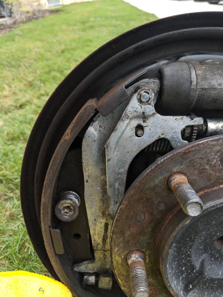

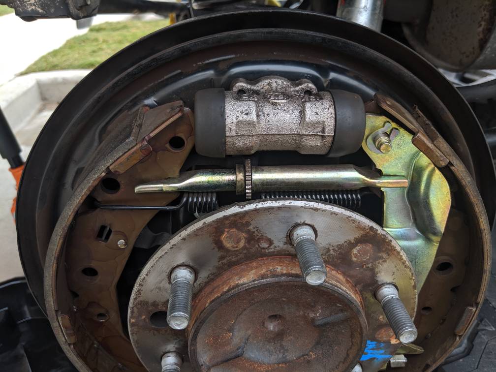

I re built both axles that I pulled from junkyard. that was a chore because I started with 5mm of polished axle, ended up being too much and 3mm was the ticket for me
Something to think about....because 1996-2000 have different "axles" than 2001-2002, I wonder if that would be a reason why some people can get 5mm versus 3mm er 4?
I should have taken more pics but my wife was visiting me so I had to work fast even though this took me alllll weekend.
Something else I found that was different between 1996-2000 and 2001-2002, the automatic adjustment lever is different. Long story how I figured that out....
I have the oil soaked brakes in there at the moment. To see if the seal breaks within a week. If it passes, I already have a brand new set of OEM pads, drums, and cylinders here at the apartment.

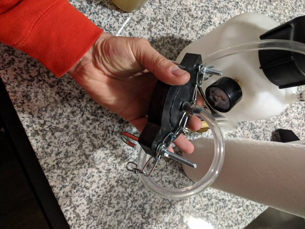

And if anyone hasn't gotten one already a motive brake bleeder is nice for having to bleed the brakes after you bolt everything together. I forgot the park number which is the adapter you need for the master cylinder. It looks a little ghetto but it involves J-hooks and a small chain lol
Pump it up about 3psi and that will be enough. Don't put the hydrualic fluid in the bleeder just top of resivoir with fluid then pump up and and crack bleeders.
I already have the motive brake bleeder for my race car Miata and it makes bleeding stupid easy

This is the right rear brake assembly. The automatic adjustment mechanism is behind the pad I should have taken a better picture of it. Because of the relocation on the adjustment mechanism, the little dial thingy with a spur looking gear on it is different as well. What is it called again? Lol
The little head that attaches to the front pad is different. It doesn't have the pin for the self adjusting mechanism to hook on to. (I'm referring to the part below may not work for a 96-00 setup
Not sure how someone could get tangled into that kind of part swapping but I still wouldn't be surprised lol
This is the left rear brake assembly. Notice the automatic self adjusting mechanism. This should be the same setup for 1996-2000
