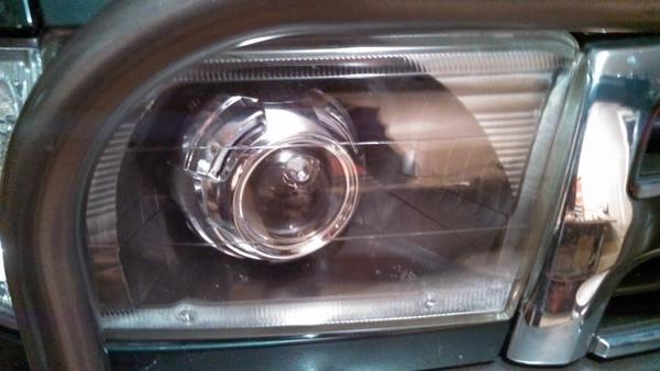

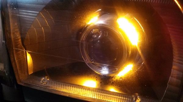

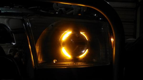

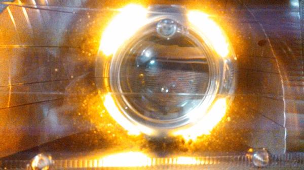

My FX-R 50W Retrofit with Apollo shourds and Amber XBaLED Halos. I am running 5000k morimoto bulbs currently, but looking to upgrade to a set of CBI bulbs. The paint is the same duplicolor spray bomb that I use on all my stuff.
Guys, feel free to PM me If you are interested in a set, my buddy and I have a business on the side building ret
rofits!

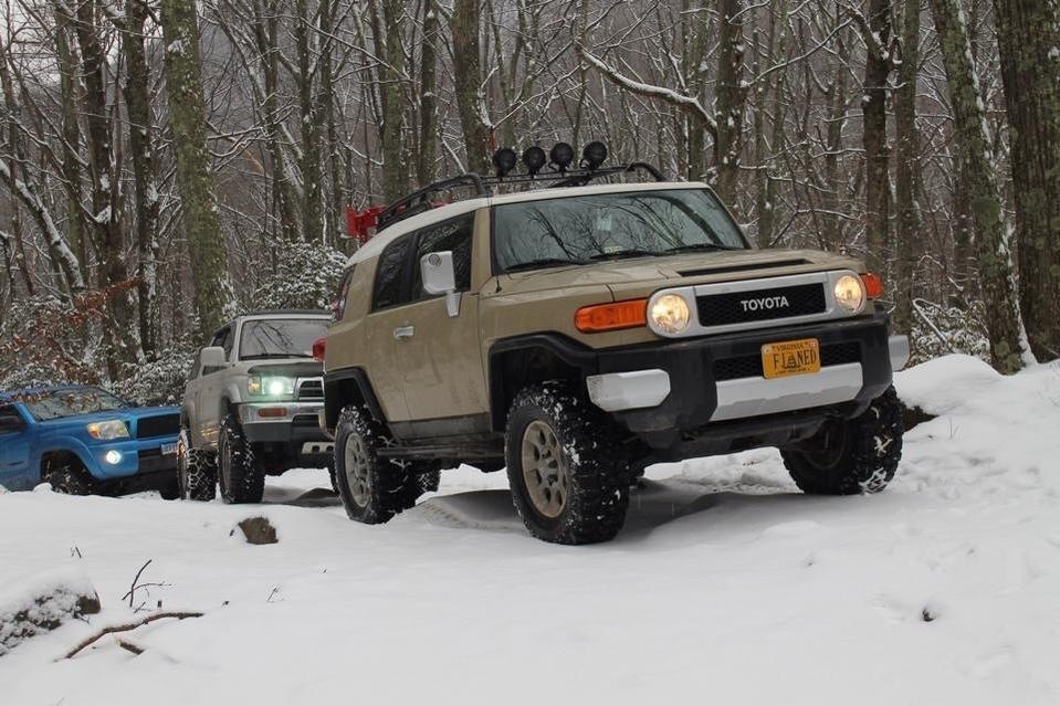

Fresh Pics!!!
Low beams on trail.

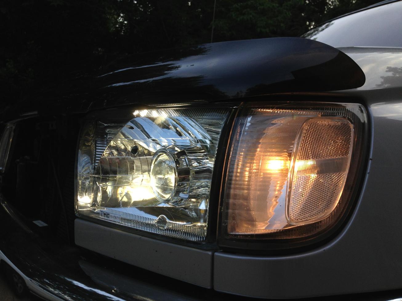

How was the install on those?
It was fairly straightforward. I took a long time doing it because this was my first
time doing anything of this sort. It was completely plug and play as far as the projector mounting in the headlight housing and all of the wiring harnesses just clipped in with no issue. I could do it again in 1/4 of the time. Well worth the effort and $ to be able to see better than most vehicles can at night. Not sure if tacomaworld is still offering the 25% off group buy, but that's how I got mine. I spent less than $300 for the new eagle eye clear housings and all the retrofit parts from The Retrofit Source online: headlight upgrades for all applications

I was in about 320 with shipping for my FX-R setup. And BTW TL projectors are an option for retrofits and are known to be one of the best projectors, but because of their size they are very difficult to install. But that is part of the fun lol!
