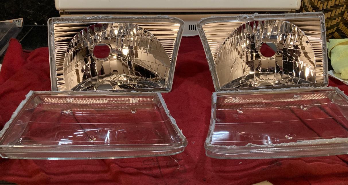

TYC housings...
Put the light lens-down in the oven once it reaches 240℉, do not put it in while it's preheating. Take out after 10 minutes and run a razor along the seam between the lens and housing then return to oven for another 10 minutes.
Take out of oven, slice along the seam again a few times, then begin prying the lens apart gently at the bottom with a drywall or putty knife. As you slowly pry the lens off cut the sealer stretching apart to avoid getting any on the chrome reflector, although it's not so critical if you're going to scuff and paint over the chrome.
