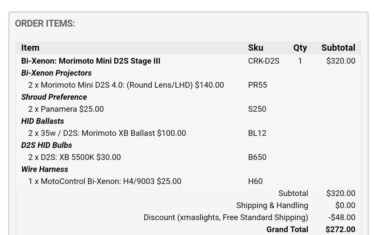

Brian, I'd love to see your exact parts order if you care to share. Sounds like exactly what I'd like to do.
Sure. Below is what I ordered. I used the 15% xmaslights code which ended last night. You can also do the group buy on TW for up to 25% off or wait until new years for the new year's code which will likely be 10-20%.
The first thing I recommend is creating an account at TRS and a shopping cart. Then they will have your email and forward you the discount codes as they roll in. Alternatively just look at their Facebook page on 31st for the code.
