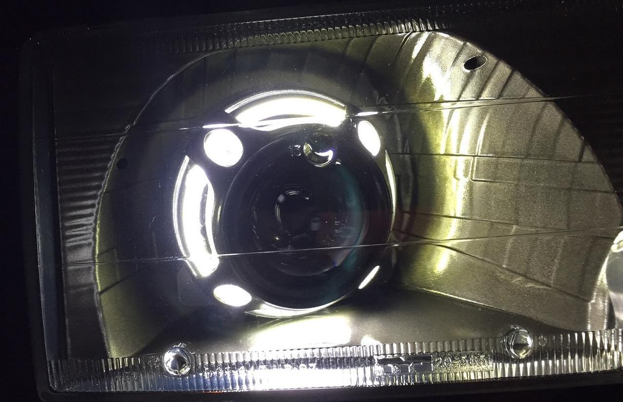

Well its not on a 4runner but this is my retrofit, '04 CBR 600RR. Double halos 4300k HIDs with audi LED mod and red demon eyes.
null_zps6e61c6c8.jpg~original
That looks wicked sweet!

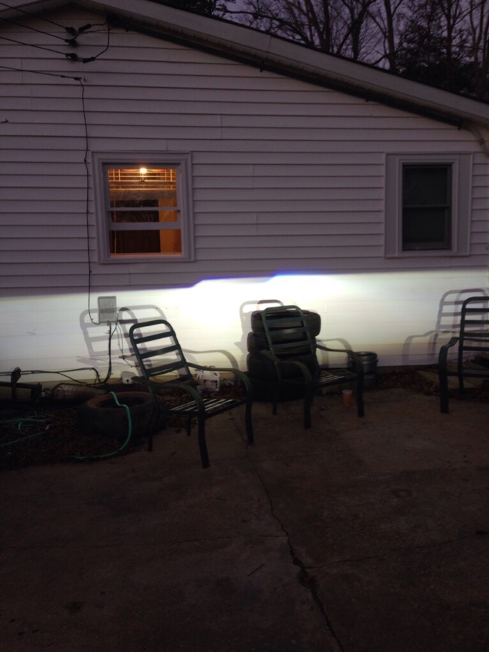

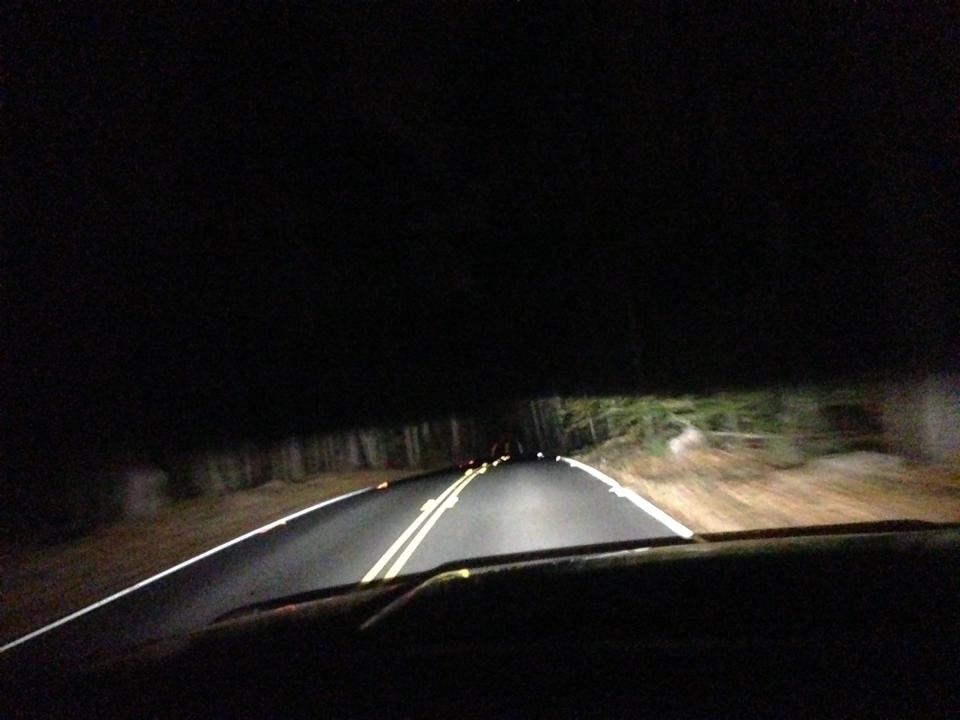

A driving shot. Sorry not the best quality but you can still see how much of an improvement over stock it is. This is low-beams only.

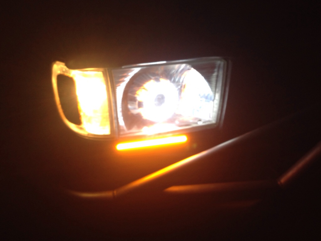

I guess is should post mine up too
morrimito D2s 5k bulbls. Gatling Shrouds( the big ones) Believe or not, i'm still running the DDM apexicone ballasts/relay i bought when i first did the retrofit a couple years ago! I also wired some LED's into the housings which BTW are the OEM housings

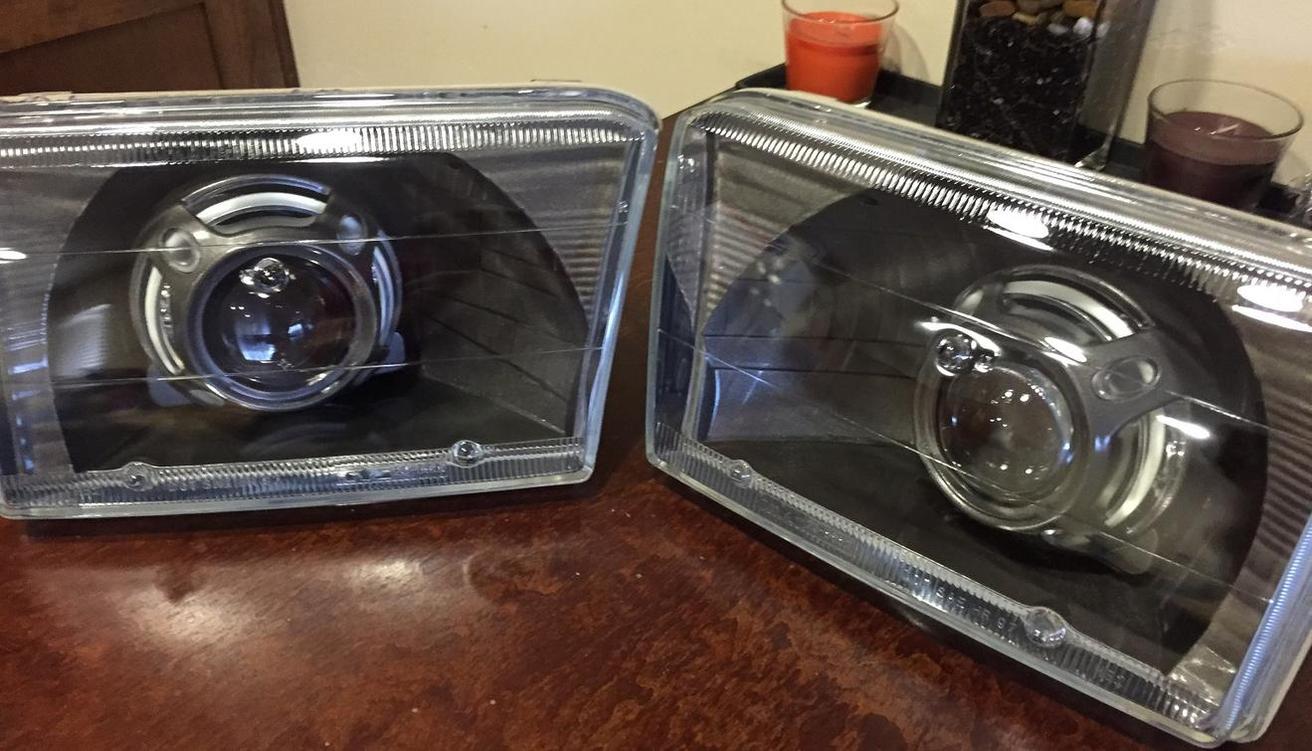

ok i guess ill post my setup. specs as follows.
Real Japanese Hilux Surf Spec Headlights
LS460 Bixenon modified Solenoids and high beam shield
100mm Led Rings
H4 wiring harness
Osram Xenarc SVS 66240
good old Hella Gen III's

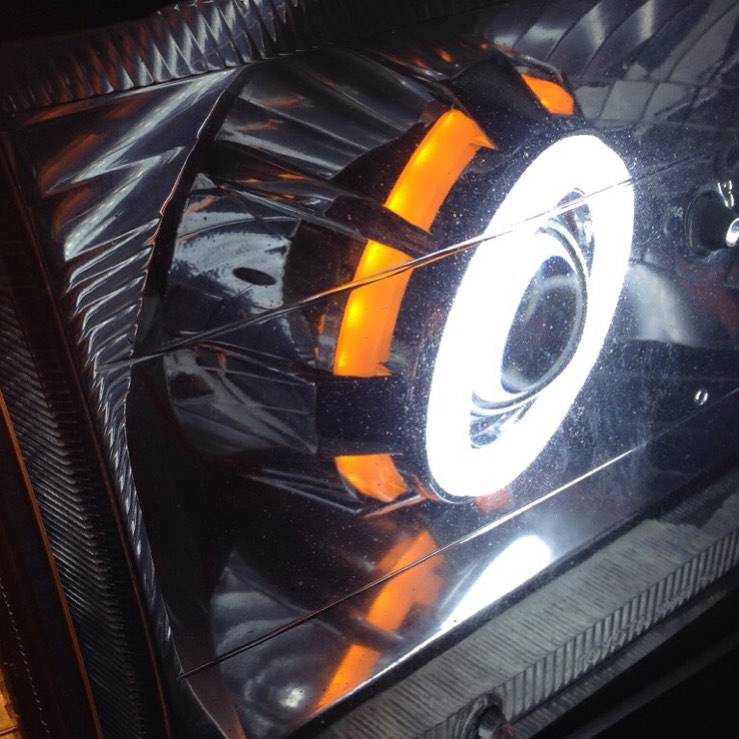

Here's my set up. 3" eBay projectors, I'm happy with the quality. Dual halo with switchbacks. ImageUploadedByTapatalk1444498282.763778.jpgImageUploadedByTapatalk1444498304.473070.jpgImageUploadedByTapatalk1444498355.098395.jpgImageUploadedByTapatalk1444498367.771519.jpgImageUploadedByTapatalk1444498382.378680.jpgImageUploadedByTapatalk1444498390.918016.jpgImageUploadedByTapatalk1444498403.072596.jpgImageUploadedByTapatalk1444498445.110277.jpg
