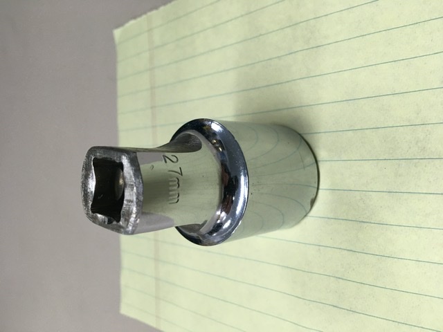

When removing the oil pressure sensor , to perform a pressure test, what size socket will I need on hand ? 1996 T4R SR-5 auto automatic trans.
Darn Haynes repair manual does not say.
Should be 27mm.

Should be 27mm.
To quote myself, the above info is wrong. I just used a 24mm deep set on my echo and checked it on the 3rz 4Runner which has an OEM sender as well.
I think the 27mm was an aftermarket sender on a corolla which was the last one I worked on.
So, a 24 mm is the correct oil sender socket for a 3rd gen T4R ?
For an OEM sender in a 3rz yes. You’ll have to check if the v6 is the same sender but I’m betting it is.
