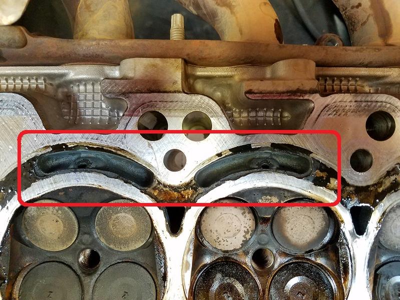

I get asked alot why you can't just put whatever coolant you want in a car. Well here's a good real world example. This owner's Prius now needs a Cylinder Head ontop of the HG job I was doing because they used the wrong coolant and the head is literally being eroded away because of it (called Cavitation Damage). The highlighted section shows that the coolant passage are actually being eaten away and this could have caused the HG to fail, it's hard to tell at this point; but the damage is done. This is just the obvious damage, this type of erosion is now through out the entire cooling system to varying degrees.
This is the type of long term damage I am talking about when you don't use the coolant designed for the vehicle. Just because you don't see the effects or feel any problems doesn't mean it isn't causing damage.
Excellent picture. Where is the water pump in relation to that damage location? I only ask because I was wondering if it was possible that this damage was at all related to the borate content in the aftermarket coolant. I think they call it pinhole corrosion? I think it's specifically related to the borate content of a coolant.
Being a Prius it's an electric waterpump unit mounted off the side of the timing cover. The internal passages of the pump are all plastic and mount to a aluminum section of the timing cover to the plastic thermostat housing. It's been a LONG time since I actually read/remember the majority of the chemicals in coolant and what they prevent.
