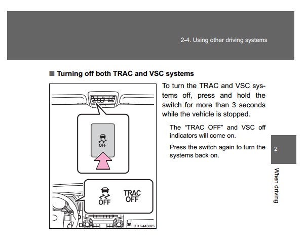

pull a fuse or cut a wire for tc?
What about just turning it off permanently during each driving session? I think this method below will disable it until you turn the vehicle off and back on. Unlike if you only press it quickly and it turns back on once you start driving faster.
But that makes way too much sense...Where's the mod?
