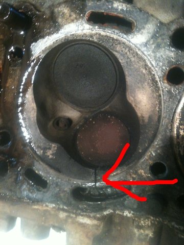

Blew a head gasket a few weeks ago
Not so much. Found the culprit this afternoon....see picture. No big deal since I'm doing a total rebuild.
Question for future reference though: Is there an easy way to tell a cracked head vs. a blown head gasket?

Looking good so far! I don't really know an exact difference in symptoms between a cracked head and a bad head gasket.
