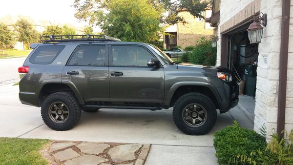

Here is something close to what I will do....no stickers, less aggressive tire/wheel lift.

Pretty darn easy to change the look of an sr5. My truck looked exactly like the one above. And you can see the changes here. Toyota 4Runner Forum - Largest 4Runner Forum - wfo9's Album: My Build
Just removing the chrome can cost you nothing if you are handy. A few things are worth swapping with the trail version. I did buy the trail door handles since those don't last if you try to paint them.
